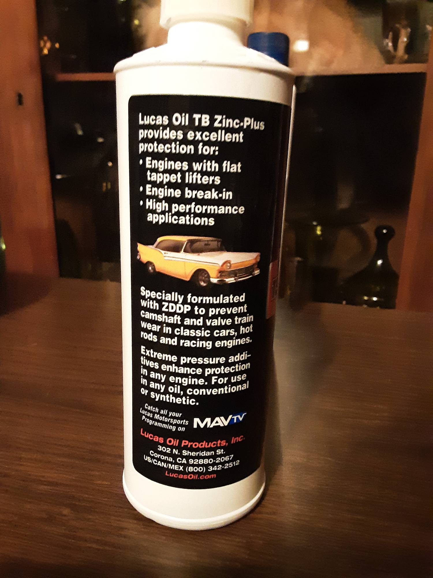

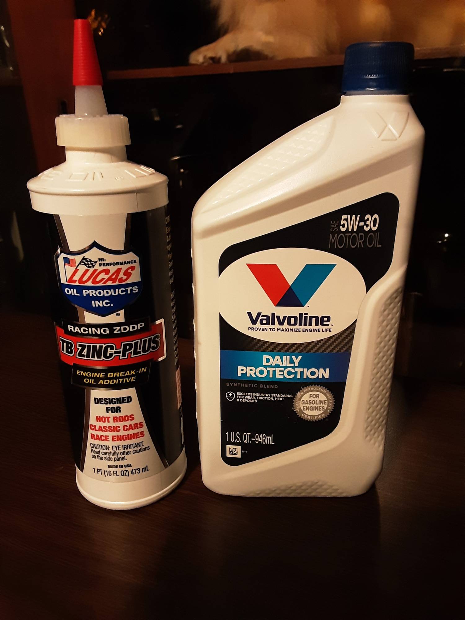

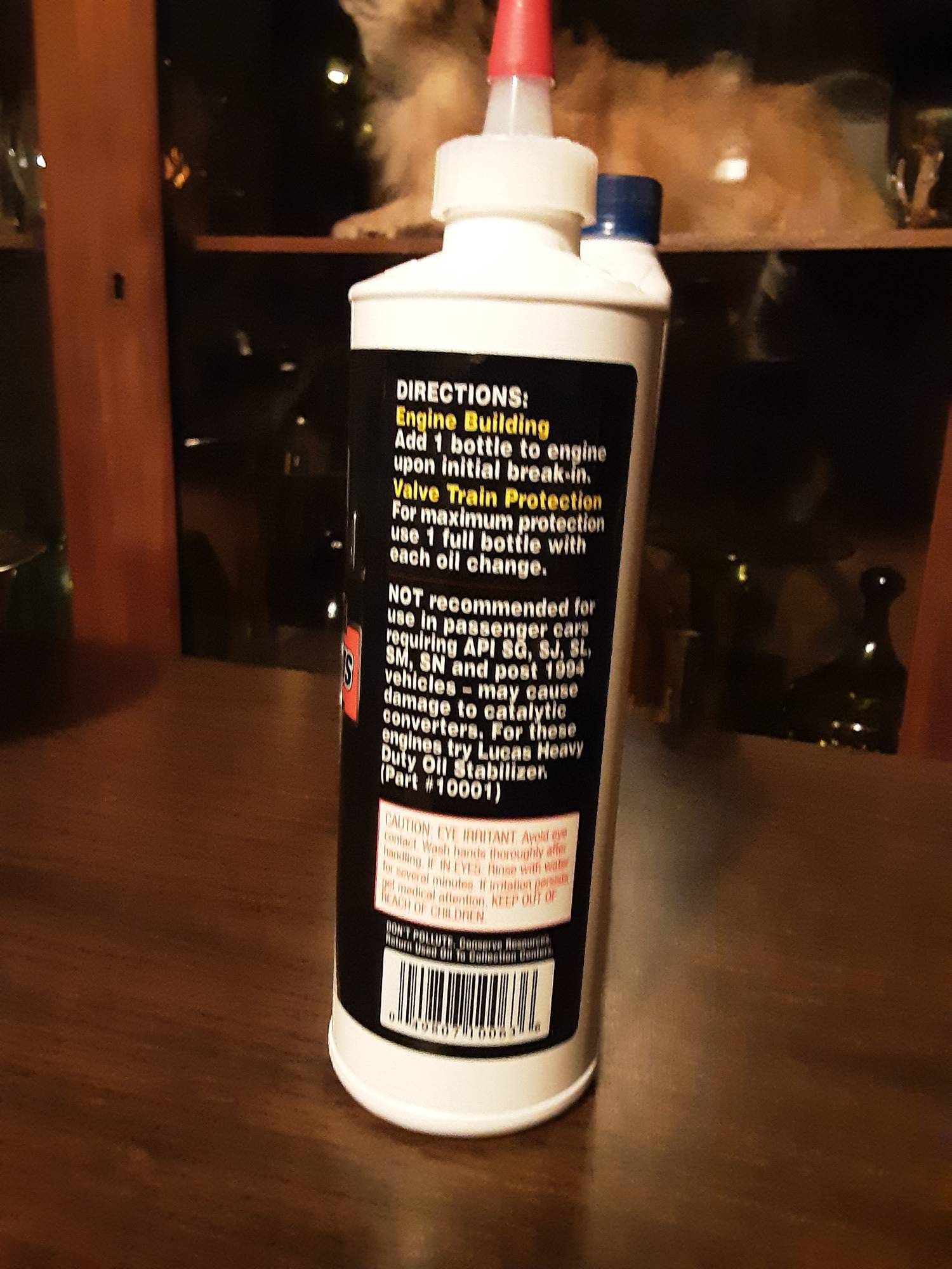

I drained the crankcase added 5 quarts of Valvoline 5W30 without changing the filter. Ran the engine 2000 rpm for a couple of minutes, drained it and put a new filter. Did this to get the GTX 10w30 out of the turbo, cooler, and recessions of the head. So 4 quarts of Valvoline 5W30 and one can of Lucas zinc camshaft break-in additive and a AC Delco PF53 filter. The valve train has radically quieted down at 300 miles of hard driving. I will add photos of the bottles. I now hear the piston slap as suggested above. The engine is much happier with 5W30 grade as noticeable on boost gauge. Turbo spools quicker and gauge shows deeper vacuum on deceleration. Engine idles 60% smoother, and with noticeable reduction of turbo lag = quicker acceleration. I did buy a set of ramps and the tools necessary to change the oil. In Arkansas it is nearly impossible to get a car worked on. June

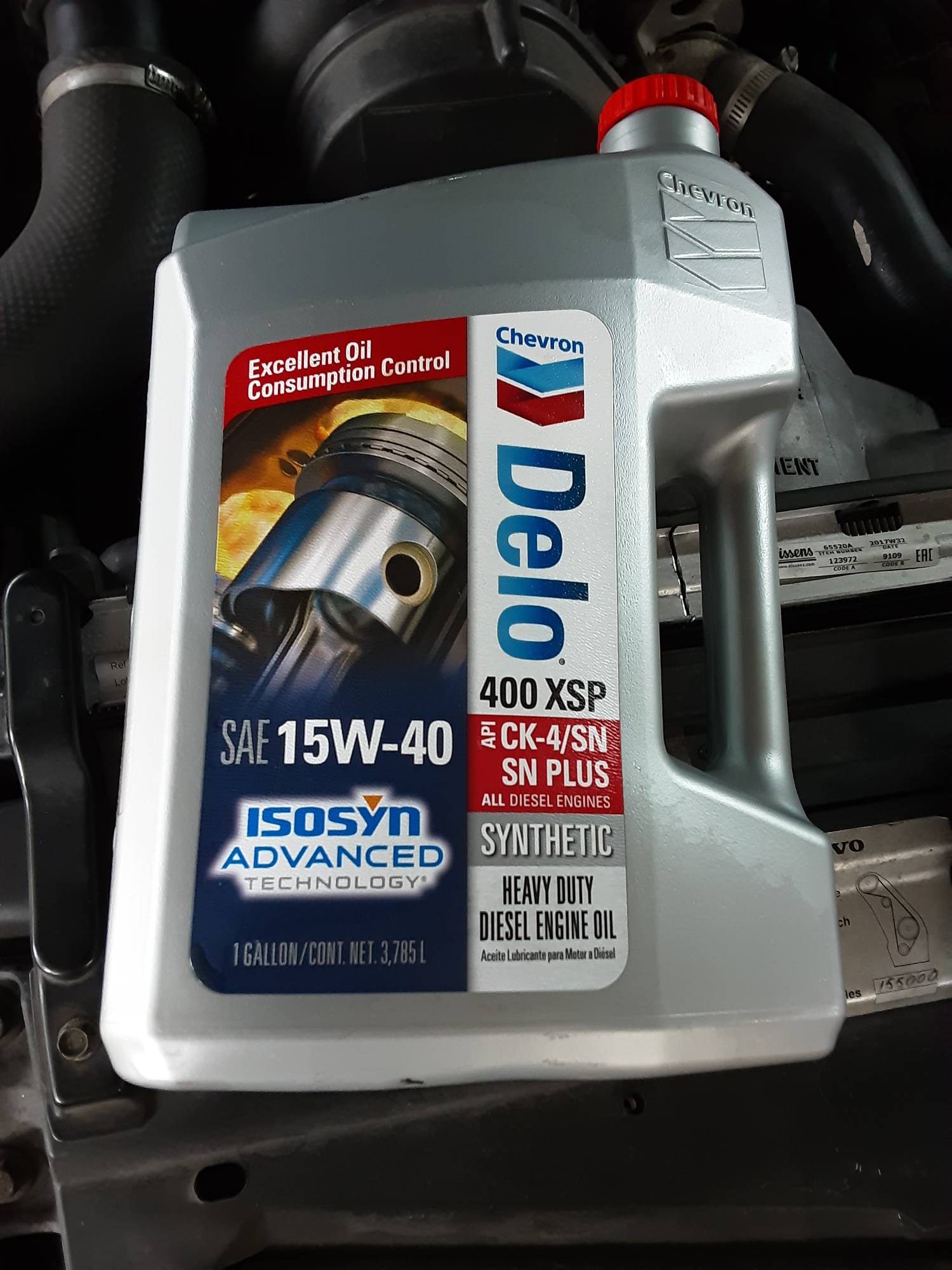

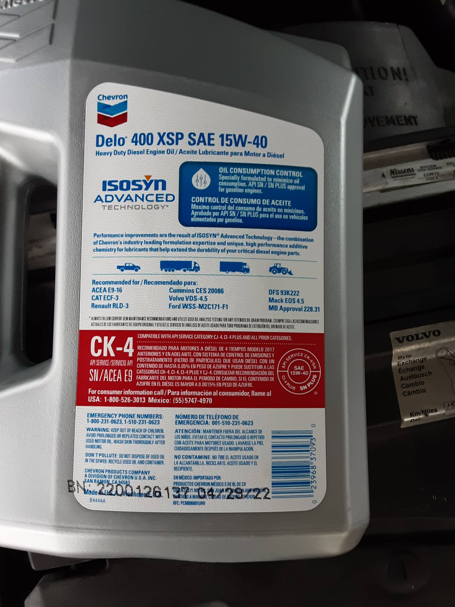

Trying 15W40 per MVS recommendation. Ran 3.5 quarts to flush out the 5W30. Drained, replaced filter, and filled with 15W40. I went with the Chevron Synthetic as the Shell Synthetic is 5W40. My thought being 5W30 and 5W40 is too close in grade. The cold idle is smoother, hot idle about the same. Valve train is noisier like a sewing machine only louder. Again i used the AC Delco PF53. I initially chose this oil filter because it has no bypass valve inside. I watched YouTube videos of the locally available filters being cut open and all others have some form of the valve. Drove her 150 miles today on the 15W40 without issue. I will report further once I run her more miles. I really love owning a 740 once again!!! June
