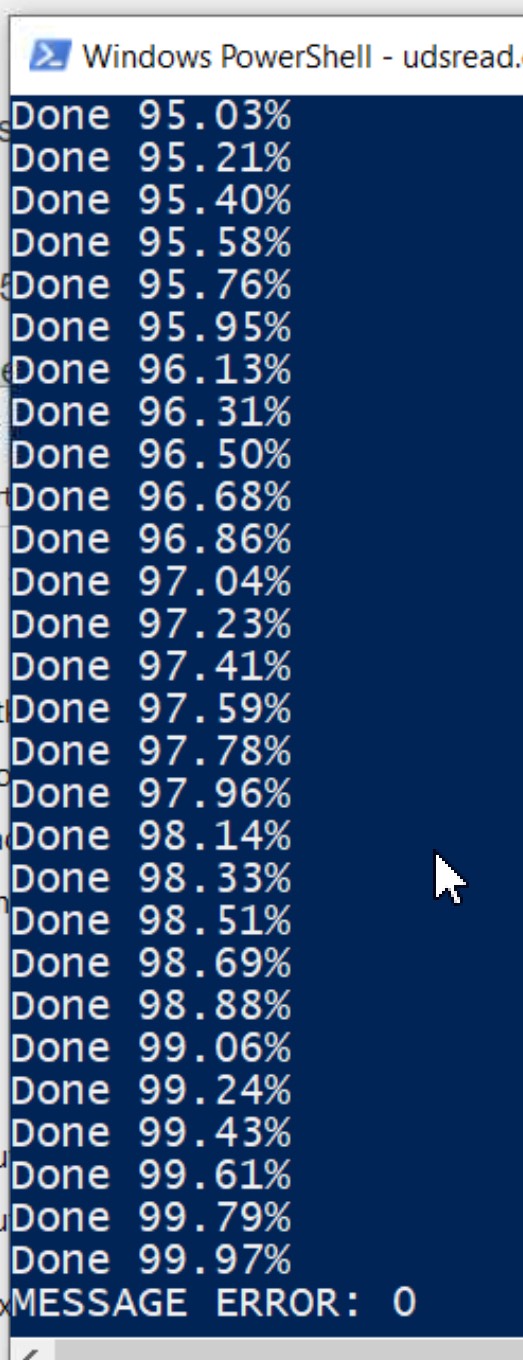

You miss 60 can frames of data cause your cem is sending faster as your dice can capture the data.
You can press shift and right click in the dir where your exe is and open command line or powershell, (in powershell write cmd and press enter) then type in udsread.exe >log.txt
Enter pin code blind and press enter, wait till your dice stops blinkin and take a look in log file.
If that won't help, try faster computer or windows 7. I use one of the earliest mobile i3 devices and have no error reading the cems. My core 2 in xp also has no probs.

Thanks. I was running this on a Win 7 virtual box when I got those errors, but I was able to get it running directly in Win 10 now.
But I still get an error, now it’s “ERROR 0” (see attached image)
T5Luke
Posts: 142
Joined: 11 Nov 2020, 17:00
Year and Model: S60 T5 2001
Location: DE
Has thanked: 11 times
Been thanked: 130 times
Post by T5Luke »
0 Errors, so everything is fine :D

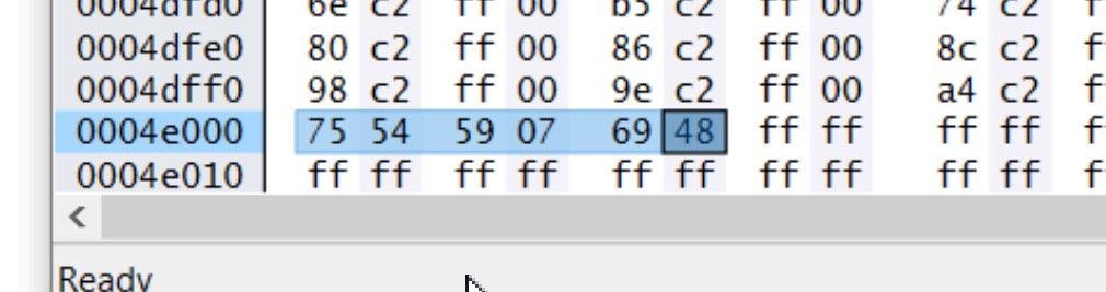

Edit: Final question (I hope 😄). Is this the pin needed for vdash?
75 54 59 07 69 48
T5Luke
Posts: 142
Location: DE
Post by T5Luke »
Yes but you have to flip it in right order...

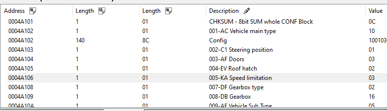

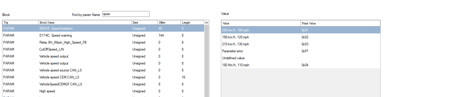

I am trying to figure out how to change the maximum speed (v-max?). This ECU is modified from before, so my idea was to use vdash to set the max speed and after that compare the bin with the change to the bin without the change, to figure out what parameters has changed.

Post by ZRimaZ »
Just change 0x8106 to 0x01 (max speed 250kmh) and recalculate chechsum at 0x8101
Have a nice day,
ZRimaZ
matija0610
Posts: 50
Joined: 25 Oct 2021, 14:43
Year and Model: 2003 S60 D5
Location: Croatia
Has thanked: 21 times
Been thanked: 13 times
Post by matija0610 »
v-max is @4A106
possible parameters:
CHKSUM - 8bit SUM whole CONF Block @4A101 (you have to calculate this, if you change the configuration)
CHKSUM - config block lenght @4A100 (you don't touch that one)
