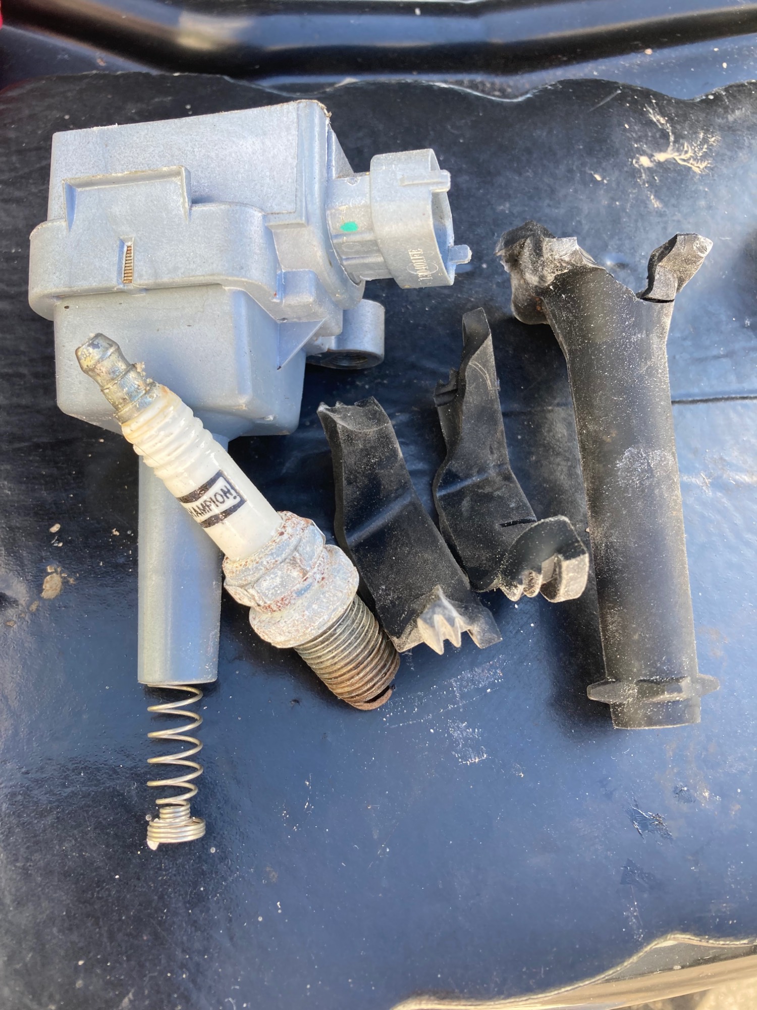

This is crazy…. My wife filled the tank up at Costco. Drove maybe 15 miles and out of the blue the check engine light started flashing engine started to misfire. I told her to get it home asap.
Ran my iCarsoft scanner and it spit out 3553, 3533 & 3503 I called Costco to check on the fuel step one. Pulled each fuel injector each cylinder stumbled step 2. Removed the twin turbo air tube that’s fun. Removed the head cover and started to inspect the coils and plug condition. Someone stuffed in $2.50 Champion spark plugs WTH. The gap was set at 50 all were burning fine except cyl #4 see pic. Someone replaced the coil with a POS. Got that sorted out with a used BOSCH one.
Buttoned her back up started the engine. Better but not solved. Ran the scanner again codes 3553 & 3503 are still there. I replaced the #5 coil pack and still same code. I’m stuck. Any help would be appreated🤔
#4 cylinder
#4 cylinder

Pull each plug coil and see if it runs worse till you find the one does not affect the roughness.

Hell got off the subject it’s a project R&R those damn tubes🤣. So the #2 coil pack was junk also. Replaced it and it’s running smooth🥃. Got to rest my back then I’ll button her up. Disappointed my iCarsoft scanner didn’t pinpoint the proper shorted coil🤨
Thanks for the tip👍🏼
