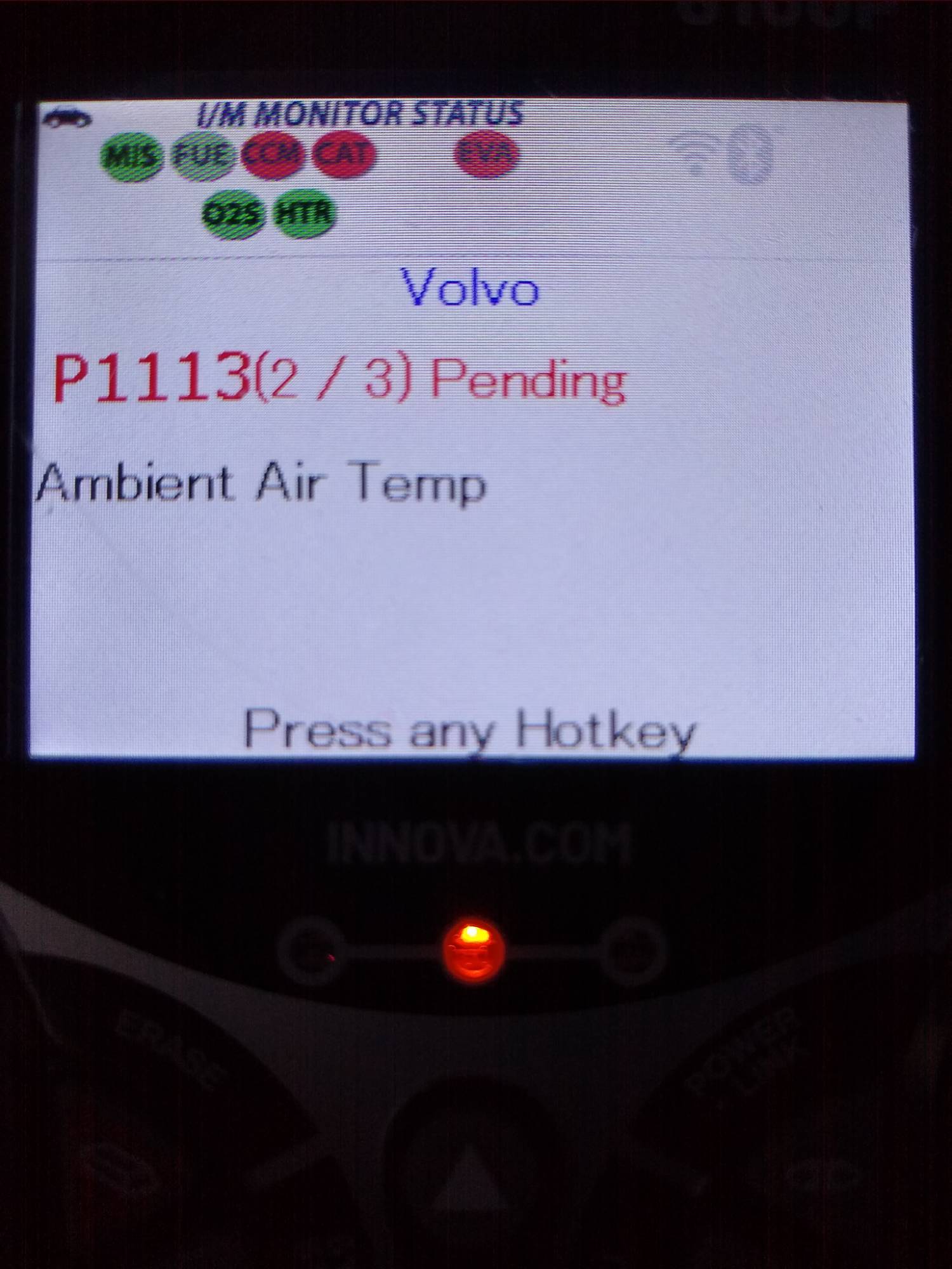

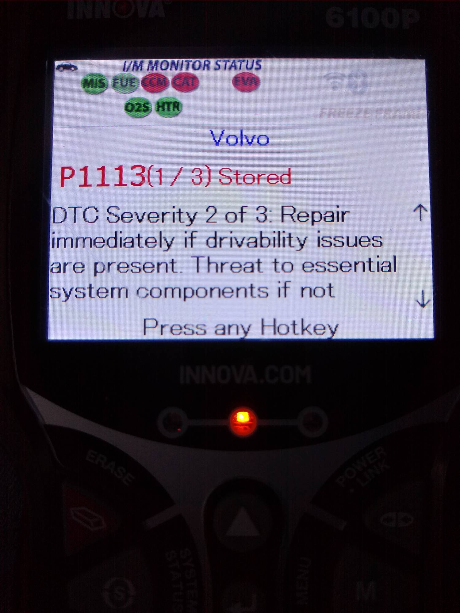

"P1113 Ambient Air Temp DTC Severity 2 of 3: Repair Immediately if driveability issues are present."

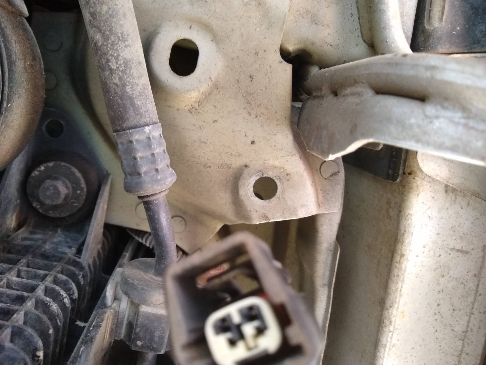

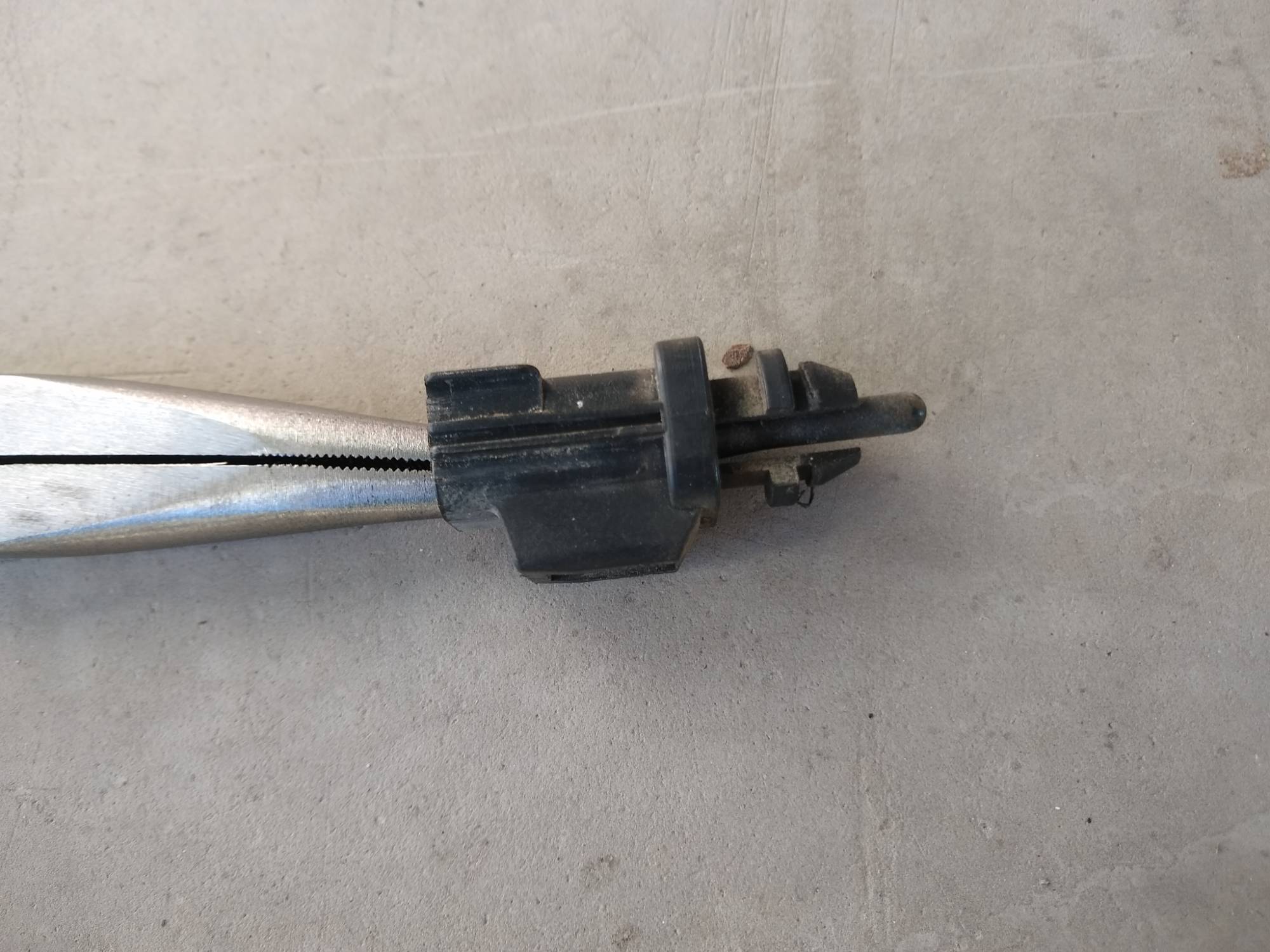

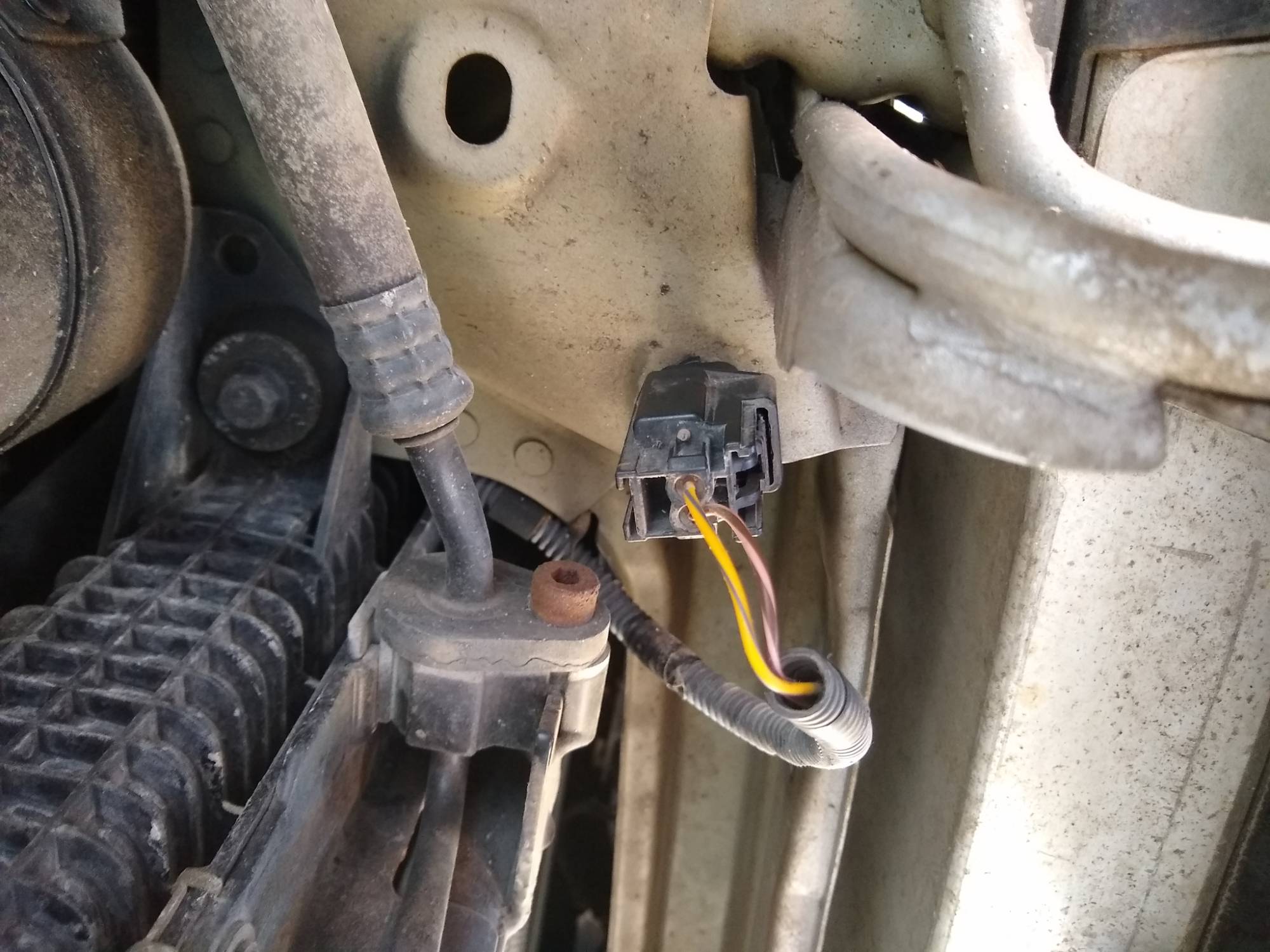

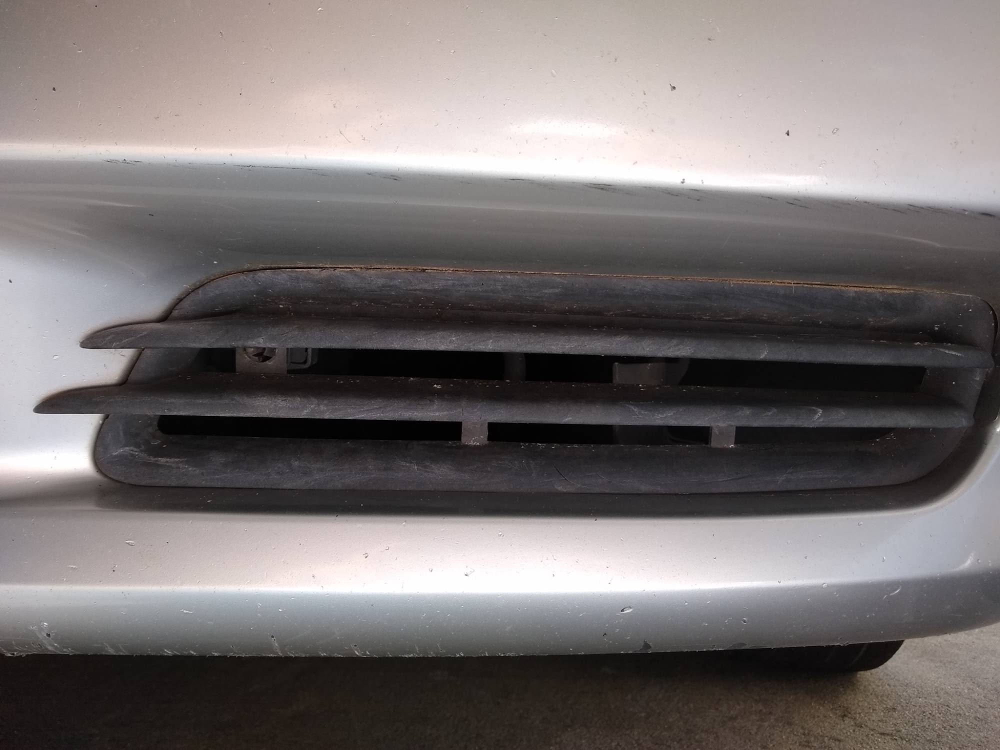

Found 2 sensors. First one is left of the vent / grill where the driver's side fog light goes. I don't have fogs however. Used the teeth of the needle nose plier's to gently pull and scrape the pins of any oxidation and then applied dielectric grease. Also bent the pins ever so slightly for tighter contact and pulled and pushed into socket a few times to clean the socket plug.

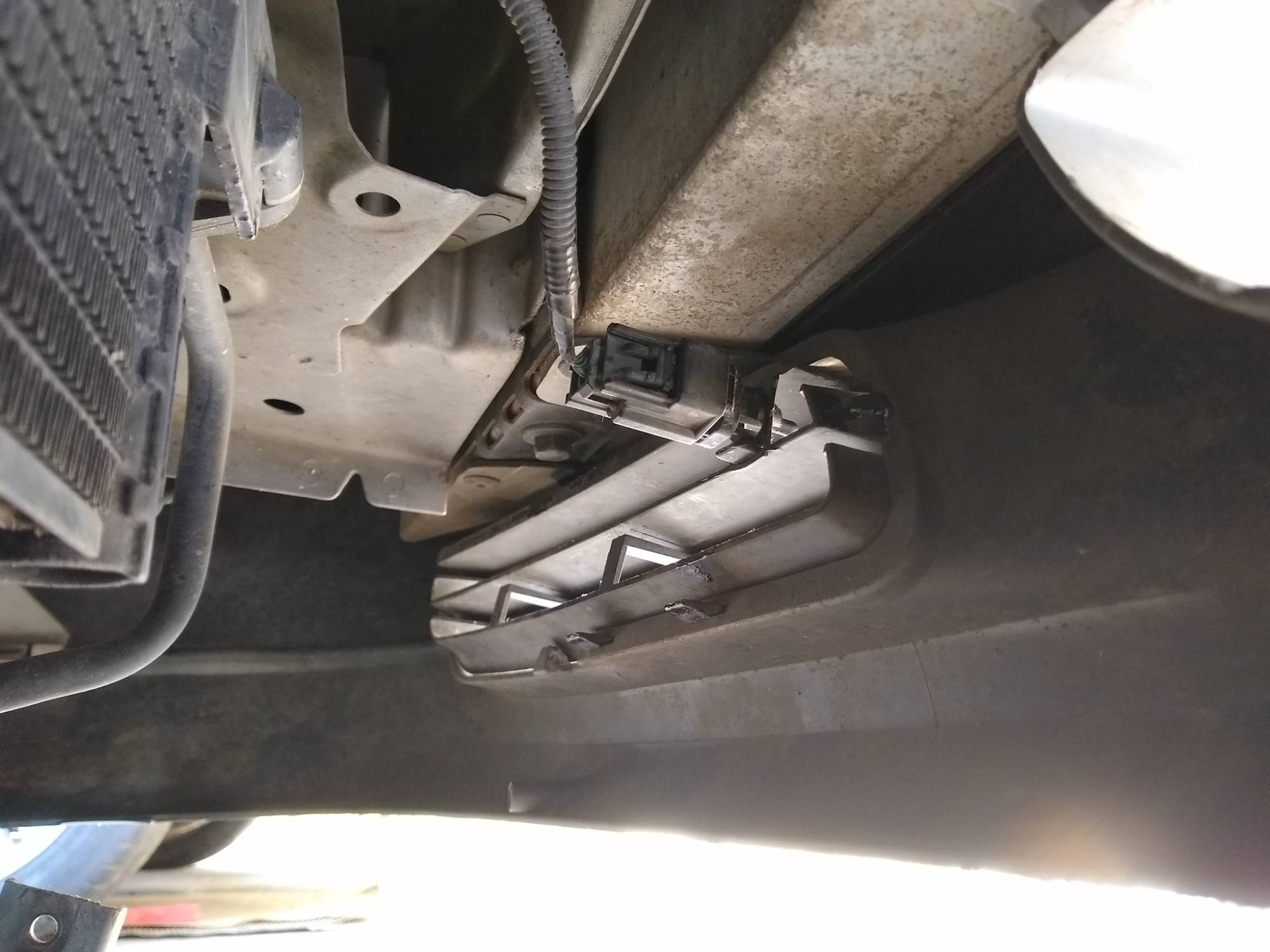

The second sensor is under frame at the end of the splash guard on the passenger. Do not have to remove the splash guard for access. Mine was not installed properly so I removed it. Found several wasp / mud nest.

That is not where the 2nd sensor goes. It plugs into the undertray as I tried to explain in one of my previous posts. That ensures it is in the ambient air intake which the engine uses to regulate air/fuel.
