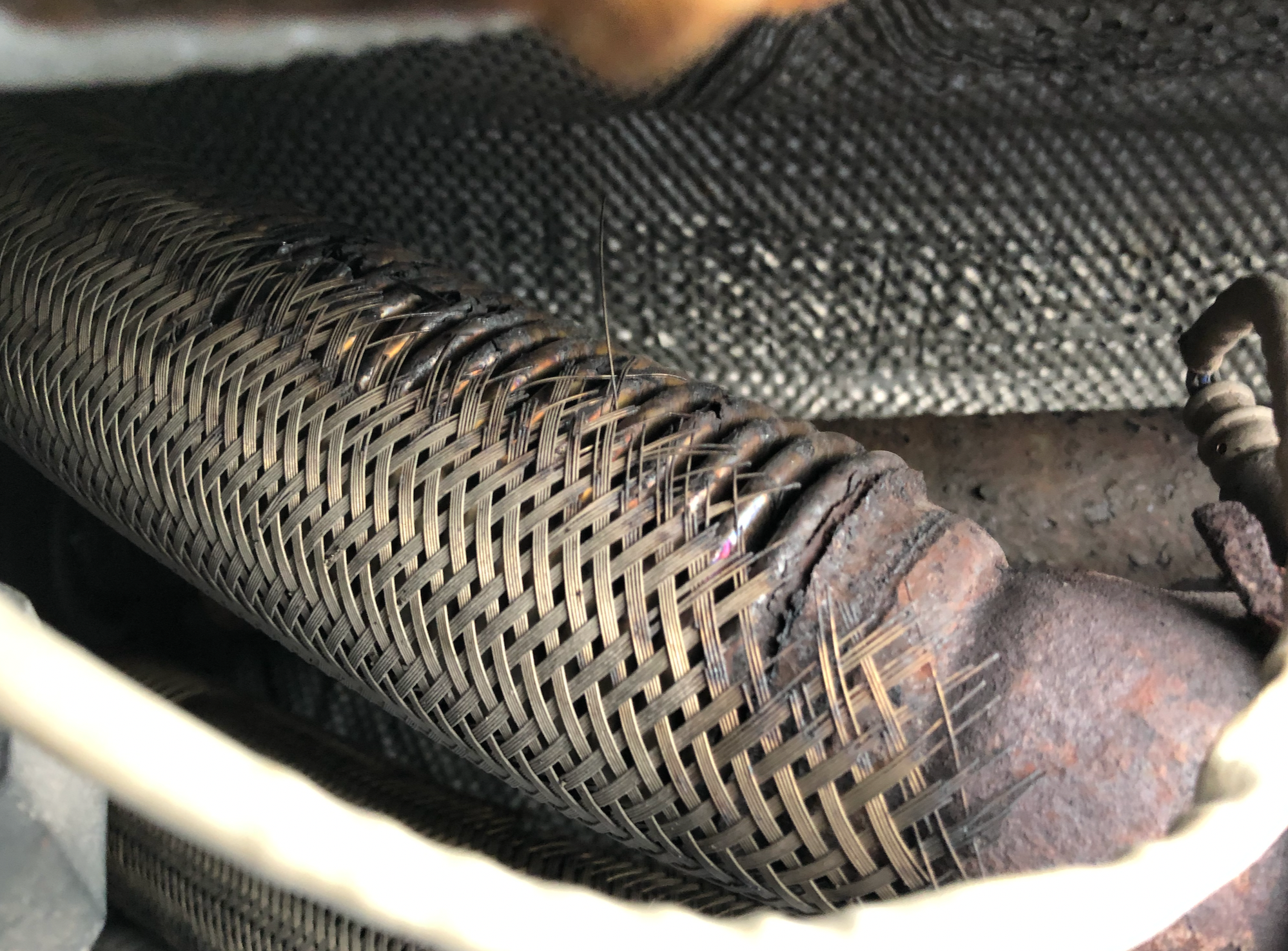

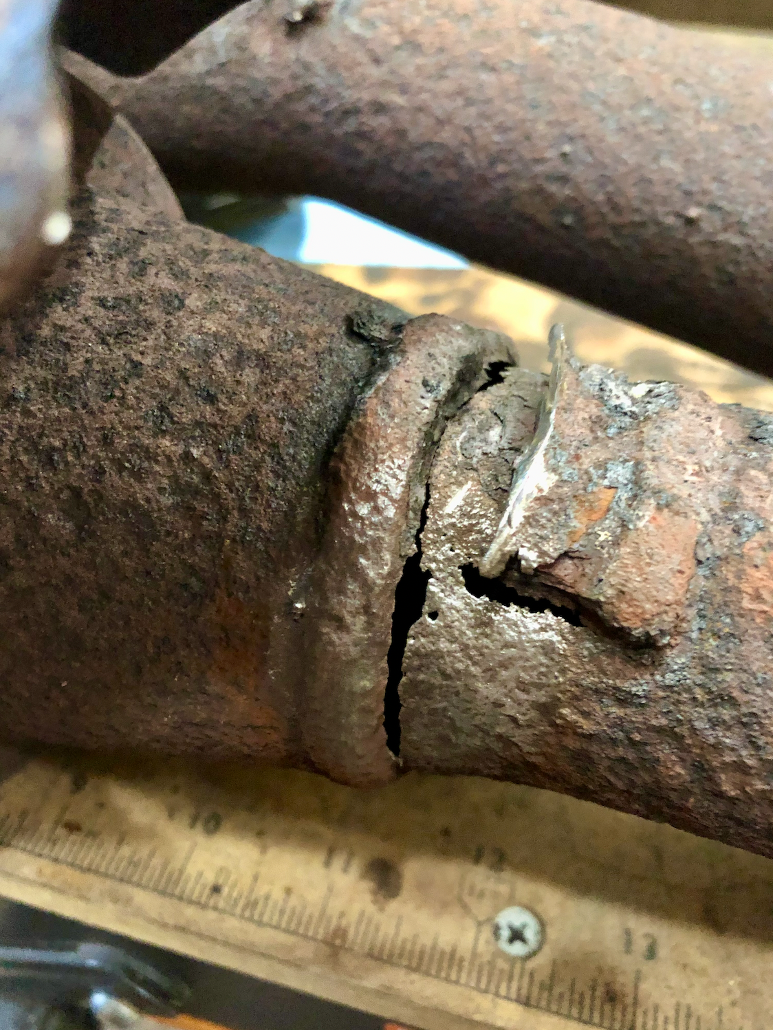

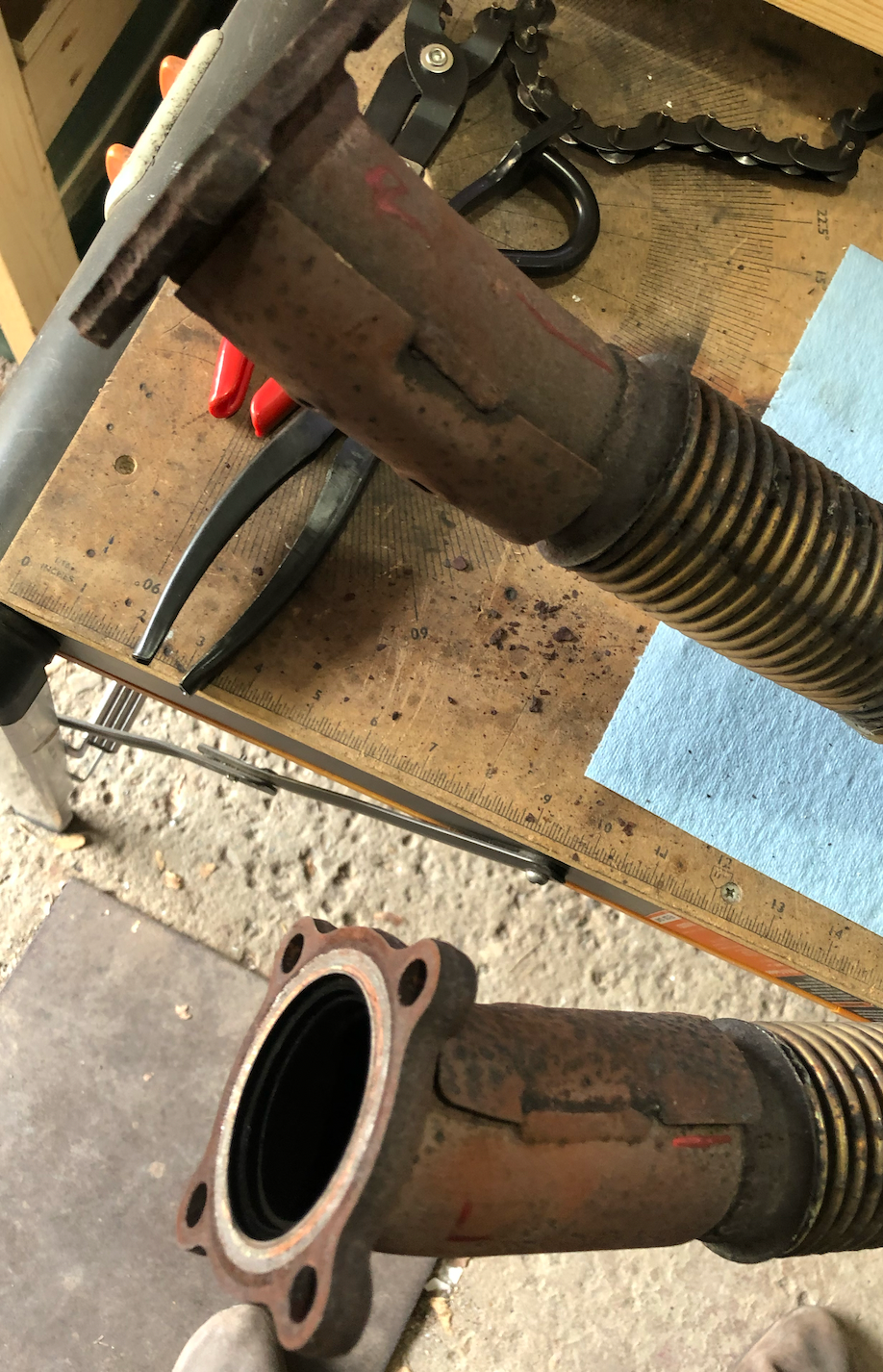

In 2019 my rear catalytic converter assembly rusted out and got very noisy. The braid around the flex pipes was very degraded, and the flex pipes themselves were in bad shape with small leaks. There were also a few leaks on the hard pipes downstream.
One of the flex pipes:

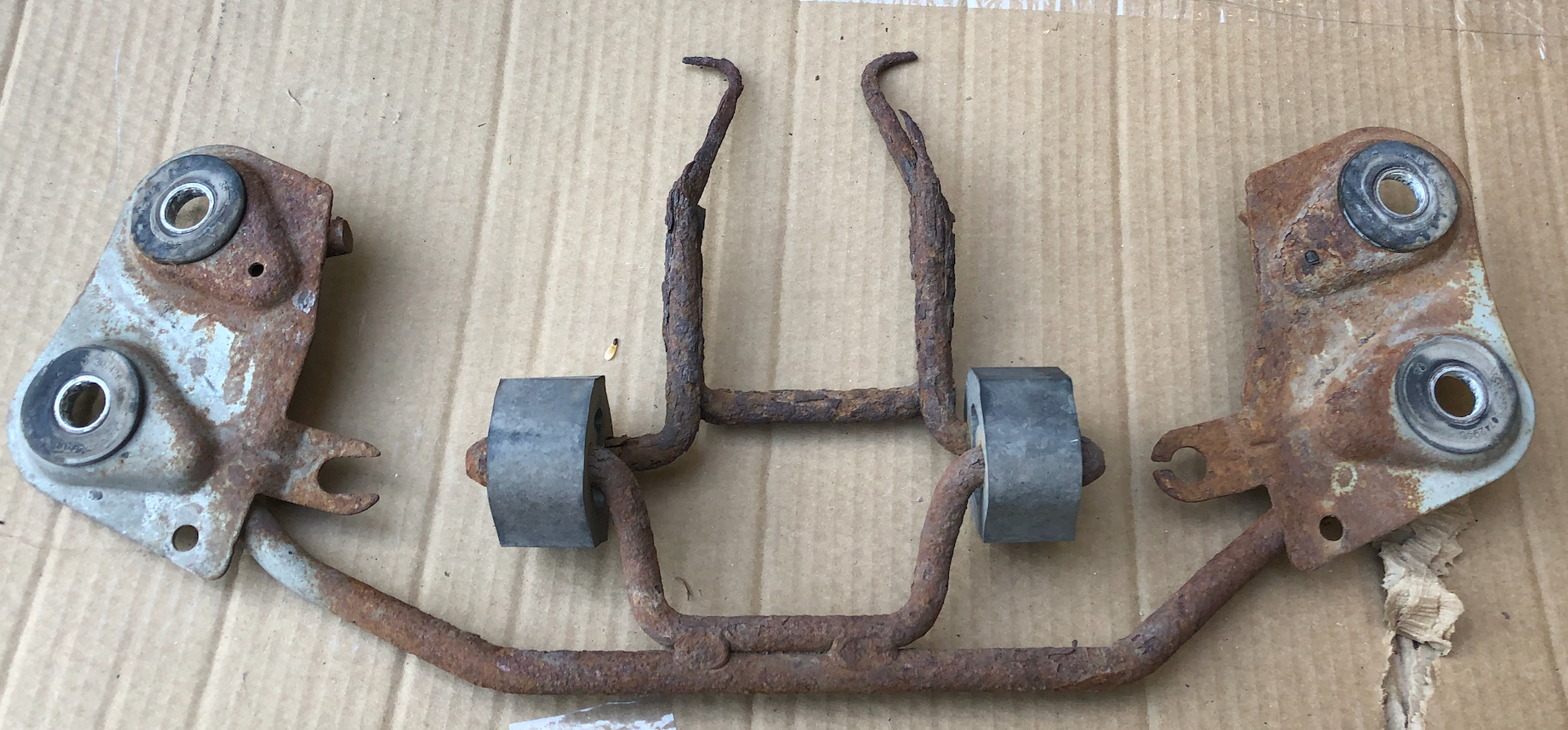

Support bracket rusted through:

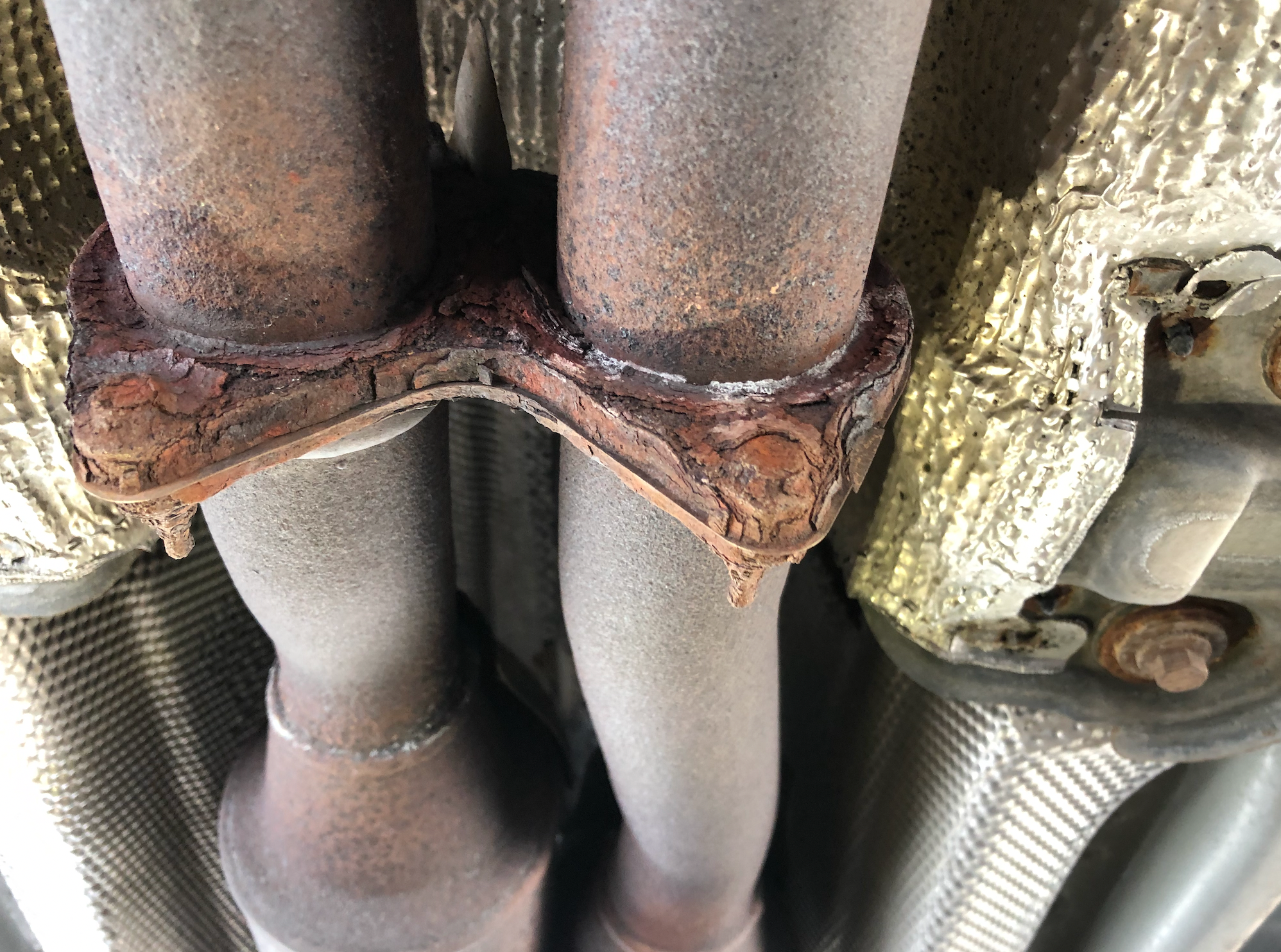

Coupling flange (mating with the front muffler downstream) badly rusted:

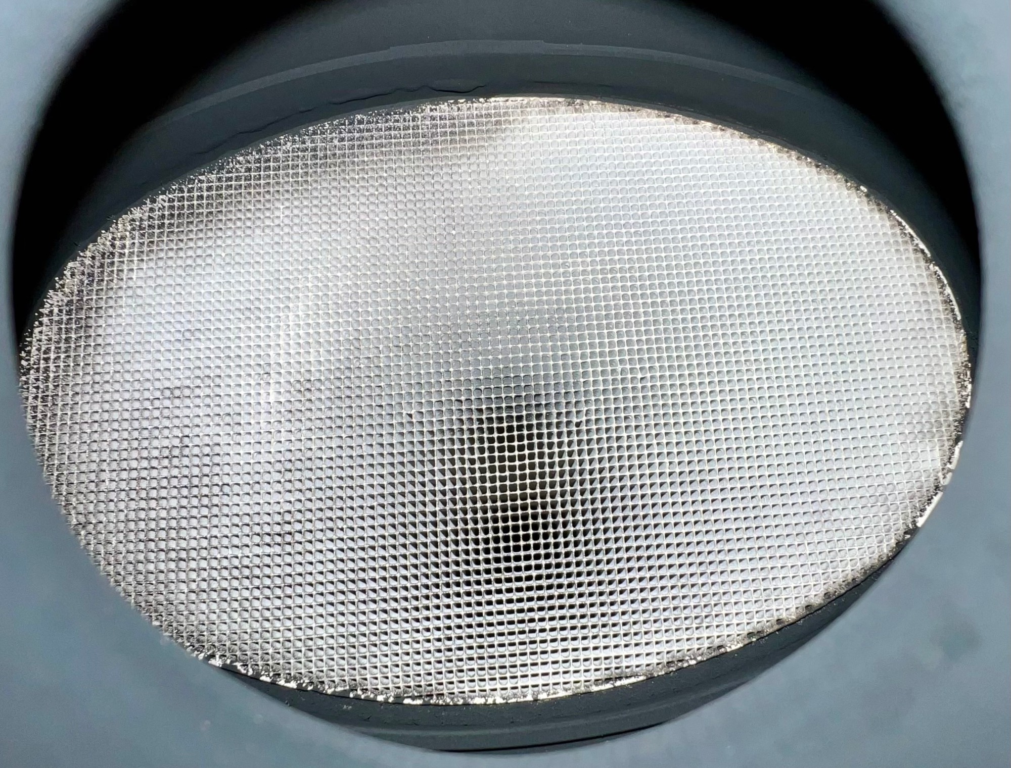

The canisters holding the catalyst grid are a much heavier gauge of steel and were in good shape, as were the catalyst grids themselves.

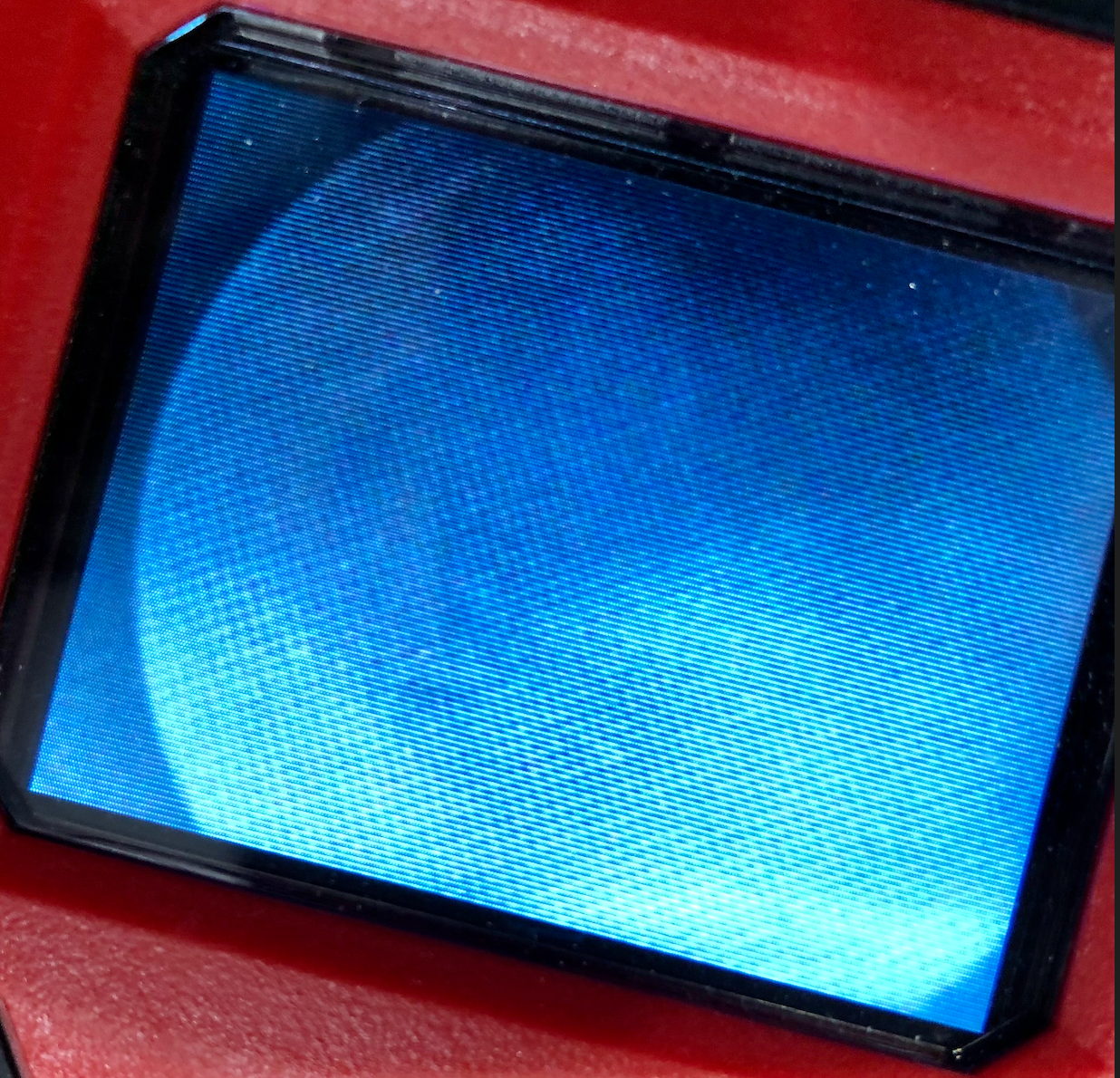

View of the rear catalyst grid (removed from car) through borescope:

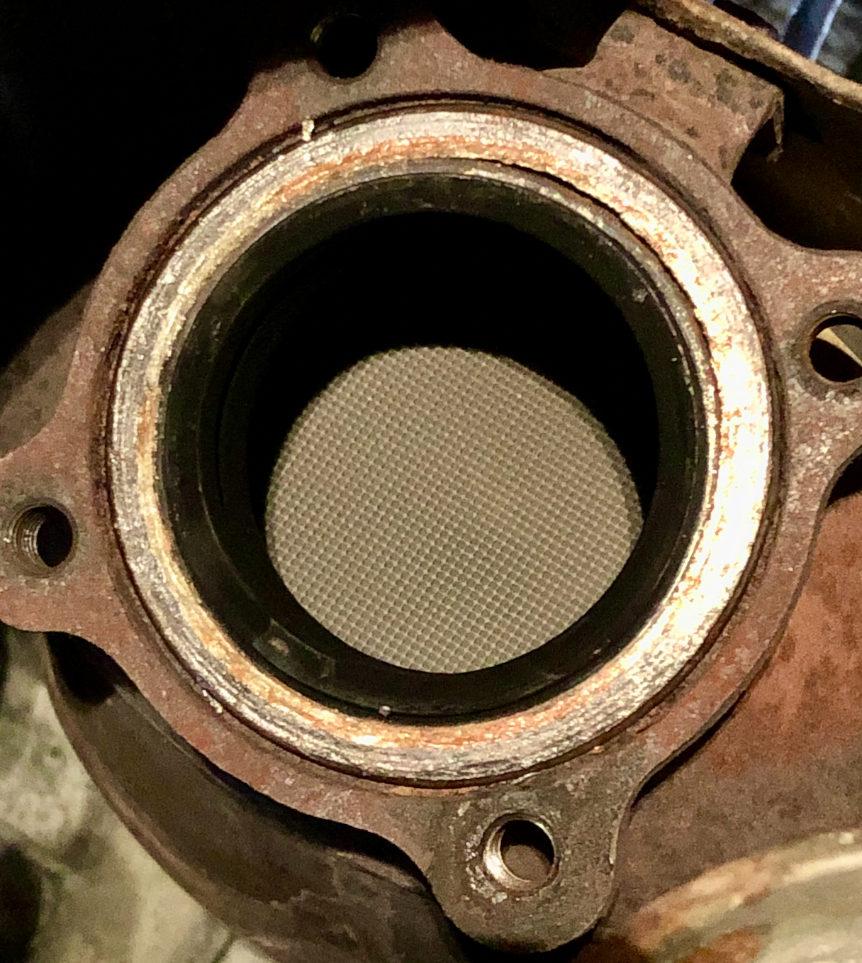

View of front catalyst grid (ie the catalytic converters closest to the engine):
Coupling flanges at front of assembly (mating with front catalytic converter):
I was not in a position to shell out for a new converter assembly, so I made a "temporary" repair. This involved cutting out the old flex pipes, welding in a new pair (I reused the coupling flanges for the upstream converters), and some further welding to patch the small leaks downstream.
The coupling flanges to the downstream muffler pipes were too rusted to remove (see above), so I had to cut them out and join the pipes with a pair of clamp straps.

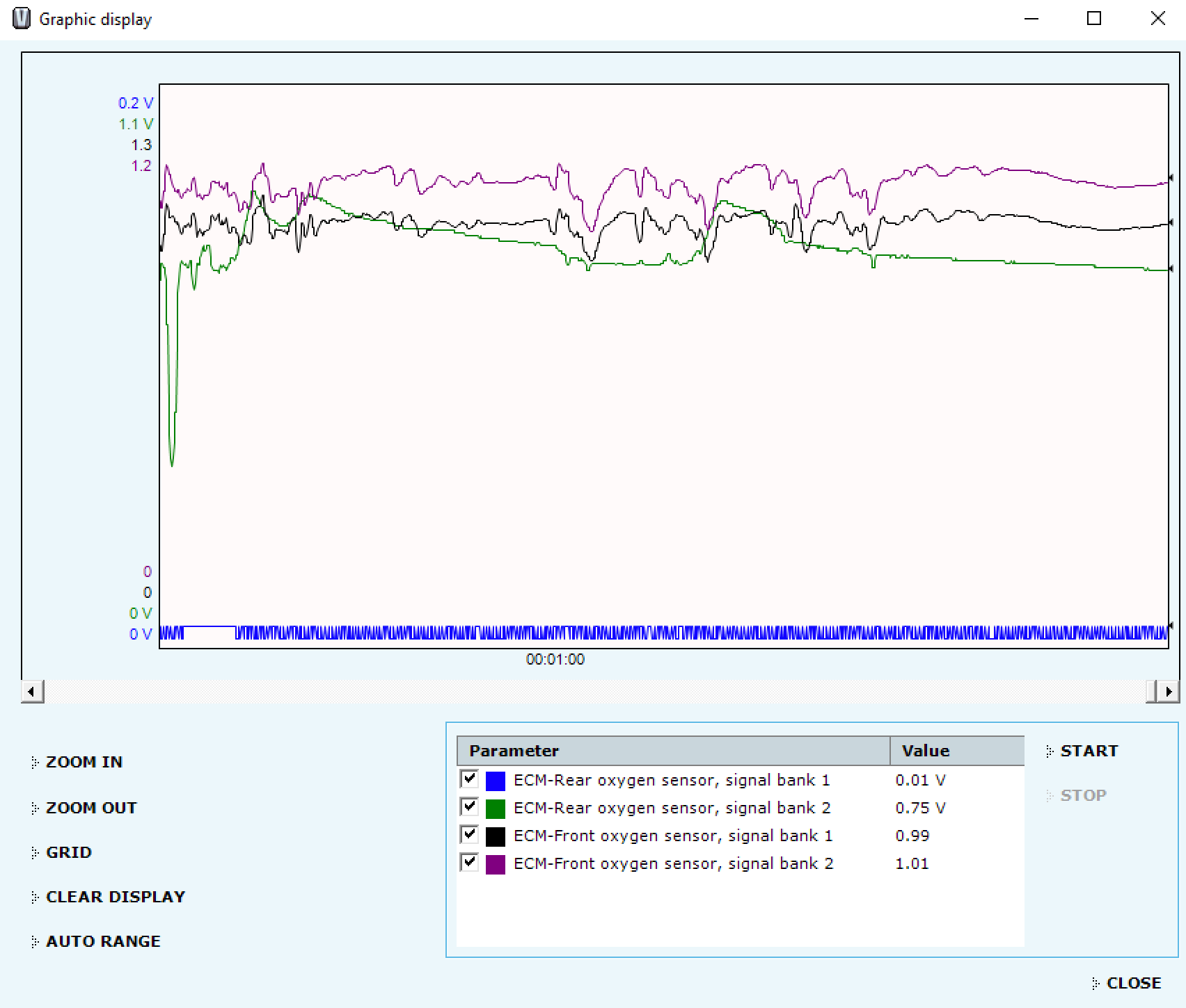

Fast forward to 2022, and my repairs are starting to leak again. I'm also getting the following codes related to my rear O2 sensor in Bank 1:
ECM-P013700 02 Circuit Low Voltage (Bank 1, Sensor 2)
ECM-P227000 02 Sensor Signal Stuck Lean - Bank 1, Sensor 2
I used VIDA to plot the O2 sensor voltages, and it looks like that sensor is shot:

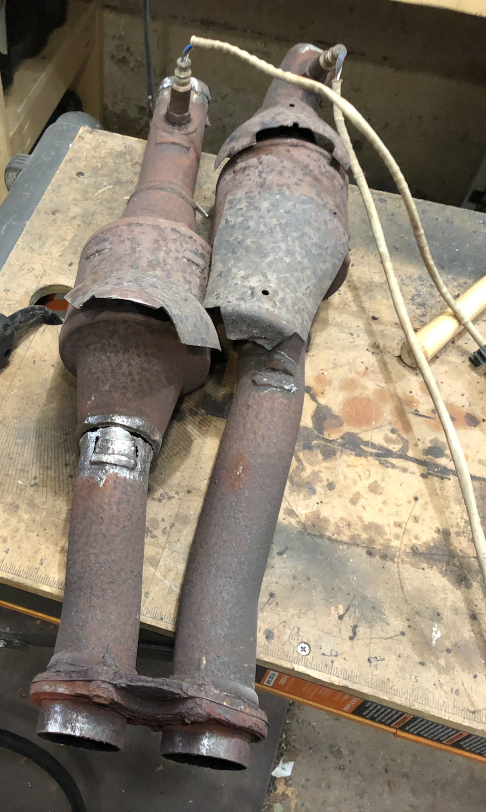

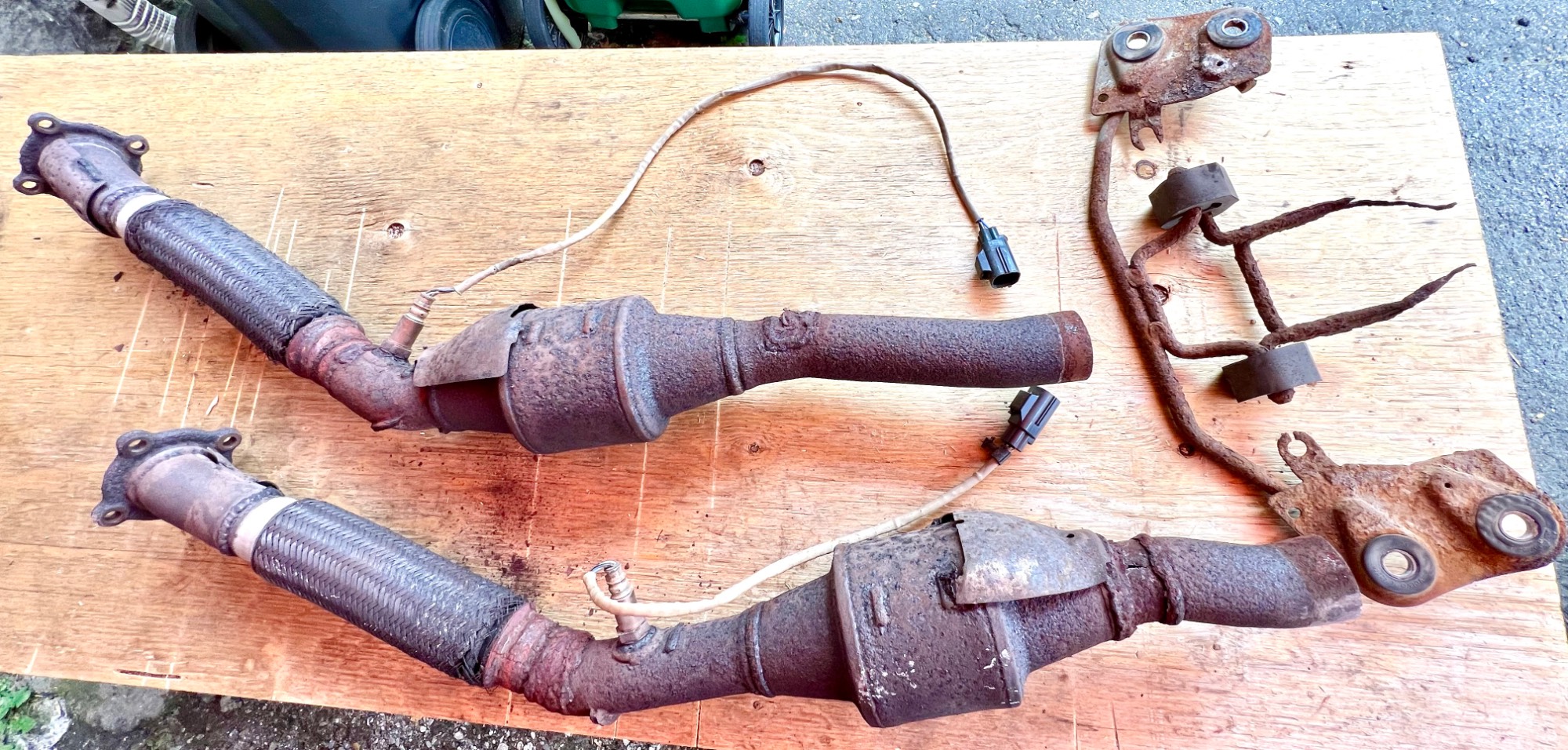

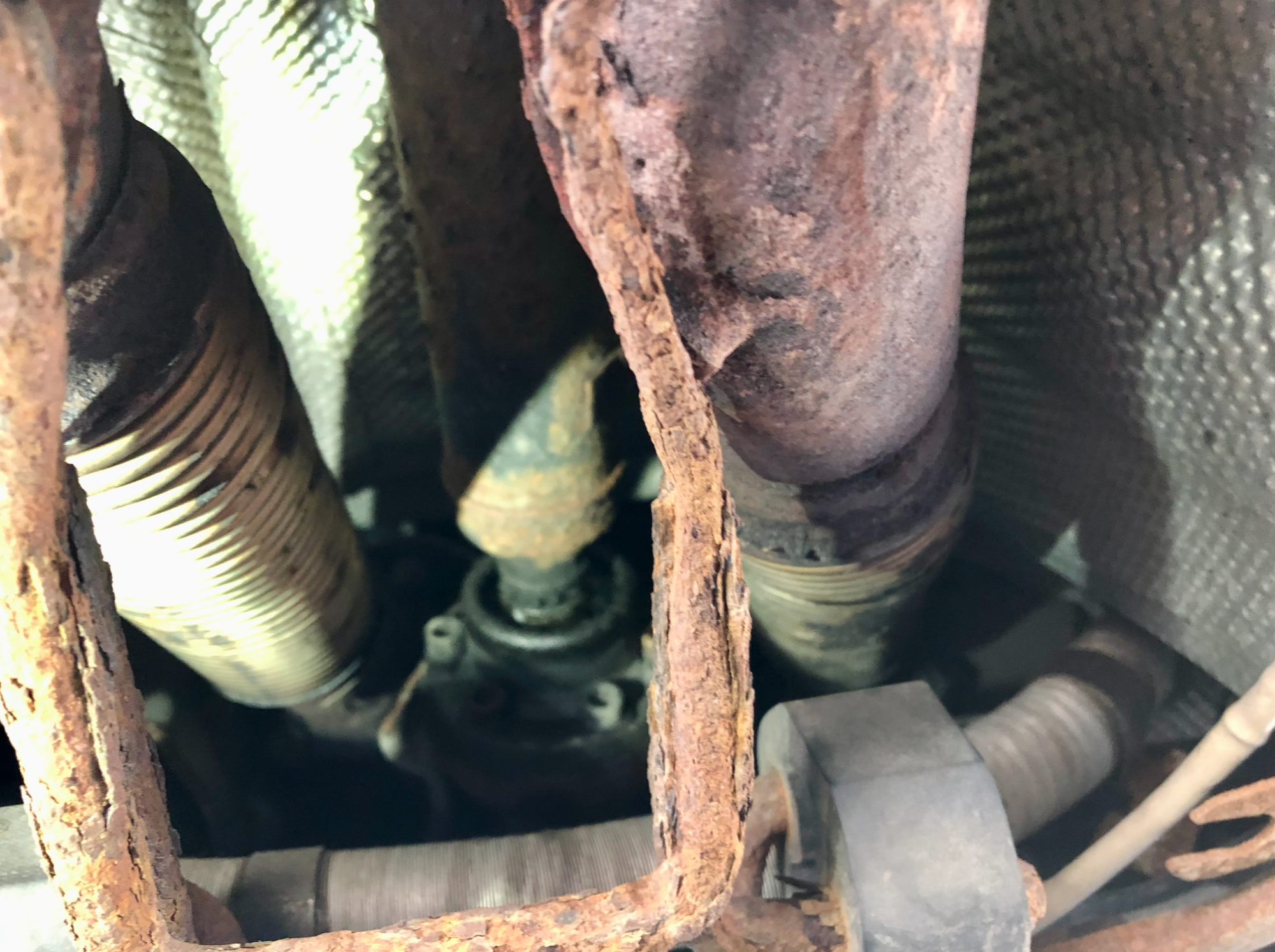

I spent the afternoon pulling out the converter assembly. Support bracket had rusted out again, and the thinner sections of exhaust pipe were failing or on the verge of failure:
I managed to get both O2 sensors out (penetrating oil and impact gun):
I was careful not to keep the penetrating oil away from the little air gap of the sensors, although Denso claims they use a filter to protect against contamination in the sampled atmospheric air.
The bottom sensor in the photo is the Bank 1 sensor that is showing zero volts and throwing a code in VIDA. Both sensors are quite sooty on the inside - I was going to replace the Bank 1 sensor but maybe should do both. The info I've found on the web seems generally to discourage attempts to clean the sensors.
My tentative plan is to cut out the catalytic canisters and clean up the exterior metal as much as possible. I'll replace all the other pipes and O2 sensor bungs with new metal.

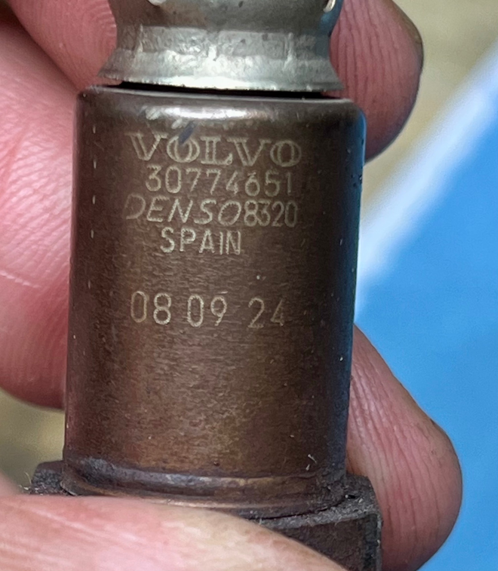

Here is a closer view of one of the O2 sensors, showing the part number:
Apparently the gap between the corrugated upper cladding and the lower cylinder is where atmospheric O2 is allowed to enter.
Denso has some good information on troubleshooting O2 sensor codes..
In my case, the rear sensor for bank 1 is basically pegged at zero, with some quantization noise in the least significant bit. This does not look like something upstream causing a lean mixture, but rather a failed sensor.

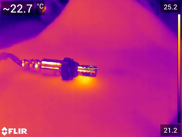

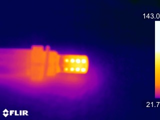

I did some bench-top testing of the two O2 sensors, and it looks like the heater isn't working on the rear bank 1 sensor (the one flagged in VIDA).
Here's a thermal image of the "good" sensor, with the heater leads hooked up to a power supply at around 12V:
After a couple of minutes the interior heats up to well over 200C, and I'm sure the embedded sensor is even hotter. Under these conditions the sensor draws around 700mA.
The "bad" sensor does not draw any current through the heater and of course it does not heat up at all:
Although it's not really necessary to show the thermal image for the bad sensor, there it is. The small hot spot under the sensor is residual heat from the "good" one. The "cool" image is larger due to use of a different temperature range on the camera (the higher range combines pixels).

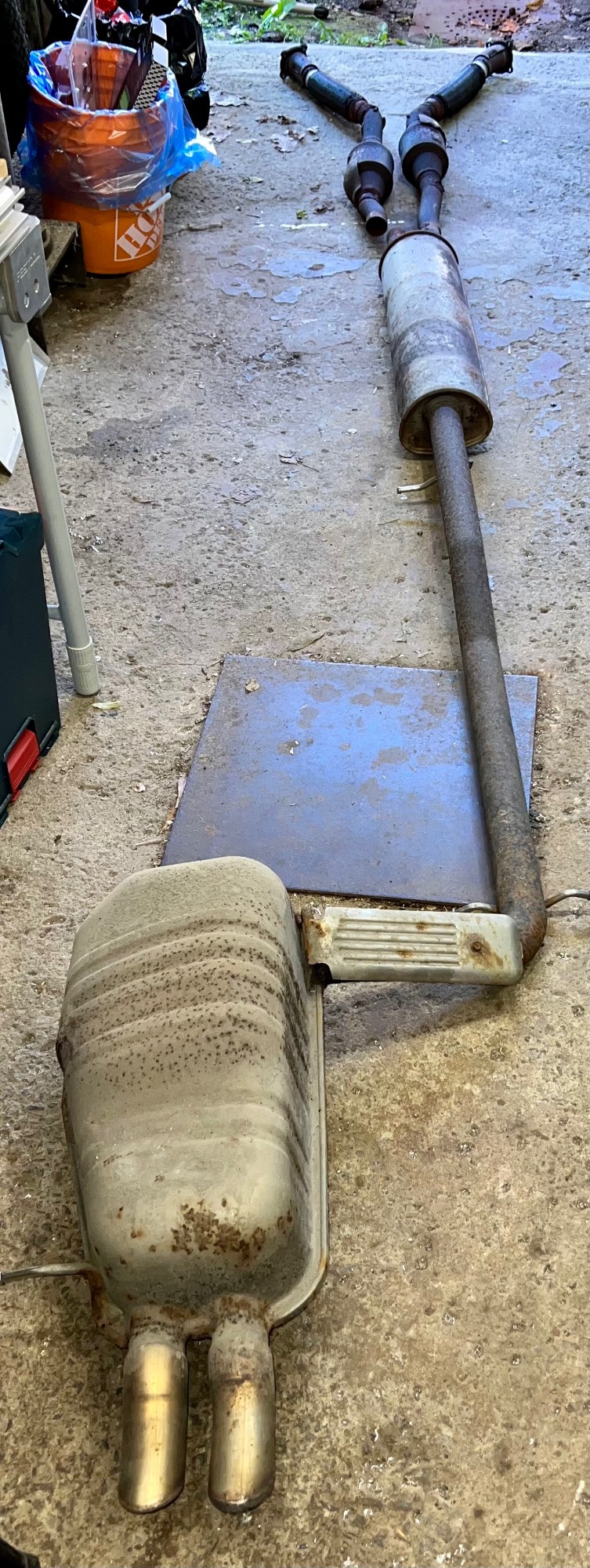

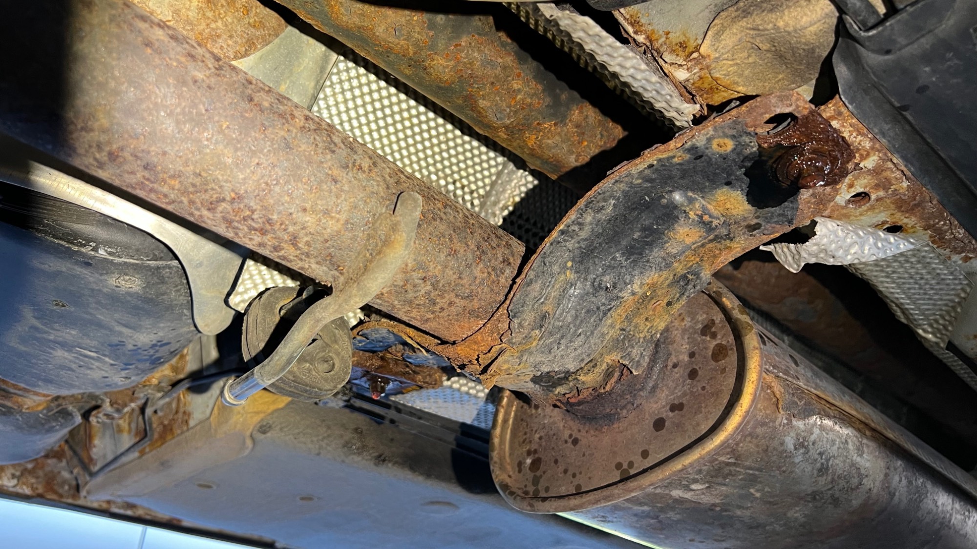

I pulled the whole exhaust out for inspection and cleaning:
These remaining sections are a lot easier to remove than the converter, although I broke a screw off removing the middle support bracket (which was also very rusty):
I will try to replace the support bracket, or make another if it's ridiculously expensive. The mufflers don't look too bad. The long pipe between mufflers has a lot of exterior corrosion but feels a lot more solid than the converter pipes (which are exposed to a lot more heat).
Another advantage to doing this on a hot June day, over a chilly November day, is that the exhaust studs pop right out of the rubber hangers (these are a real bear when cold!)
I really need to find the mythical "auto parts junkyard" I'm always reading about. If anyone knows of a self-serve yard around Montreal or Ottawa, I'd love to hear about it!
