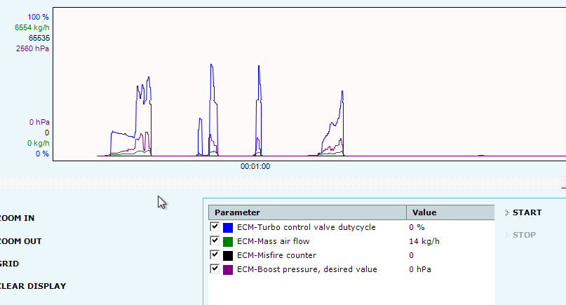

I've attached a screenshot of some of the graphing I did with VIDA yesterday afternoon.
Has anyone else experienced these symptoms? Any ideas would greatly be appreciated.

justincase13 wrote: 02 Oct 2022, 17:03 Tested waste gate today. Working fine and holding vacuum.
but maybe not working on command, you have zero duty cycle on the TCV.
TCV tested good but what about the signal.
When its blowing air from the intake box, try reaching in and pushing the rod that opens the wastegate by hand.
