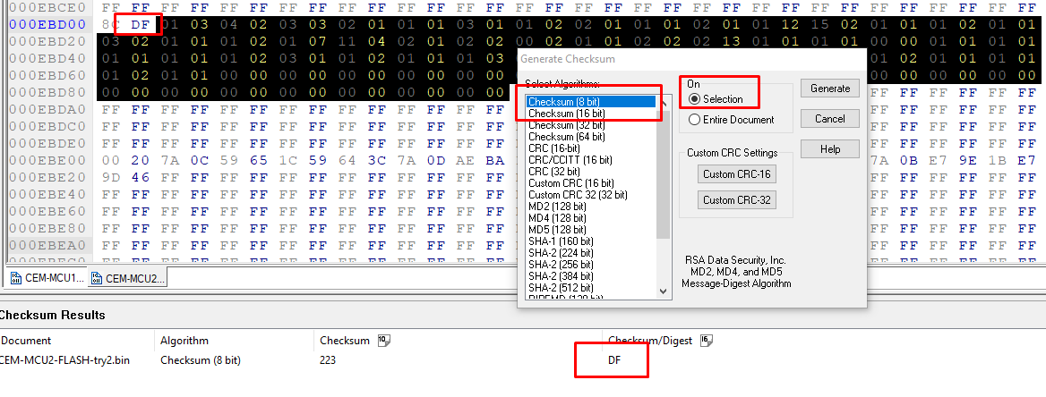

8-bit SUM whole CONF block
I think everything is clear in the picture ;)

Thank you, looks simple. What editor are you using?

ele288 wrote: 08 Oct 2022, 02:44 Thank you, looks simple. What editor are you using?
HEX Workshop

Thank you. I'll try and report the results
