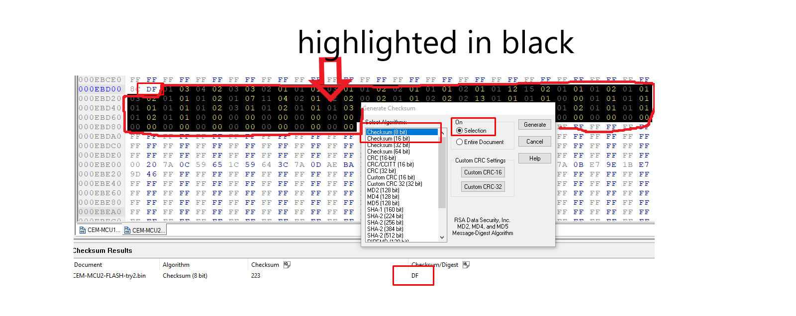

sorry, but I don't understand your question.
hope I helped 5ft24, who asked where and how checksum is calculated.

My question is how can a checksum be calculated for only part of the flash dump but not the entire flash dump ?

oscilloscope wrote: 10 Oct 2022, 11:06
In this case you have to read your hex editor's help about checksum claculation of selected area...

ZRimaZ wrote: 10 Oct 2022, 11:41
it won't help..
my understanding is these flash files would have some sort of internal checksum to ensure integrity, changing that would surely change the entire checksum calculation. changing some of it would save the checksum calculation in a area which has data already in it.

oscilloscope wrote: 10 Oct 2022, 12:37
it won't help..
Look: I'm doing this job every week 2-5, sometimes - even more times per week and would you like to make me sure that I do not know what I'm doing and that I'm lying to you? 😡
One more time to those, who are not able to read and understang english text (sorry, my english is not the best one):
- at address 000EBD00 is length of config block
- at address 000EBD01 is checksum 8bit of the config block
- starting from address 000EBD02 to the address 000EBD00 + value from 000EBD00 is the config block itself.
Do you need more exact explanation? There will be no more :(
Sorry for angry style of my text, but it had to be clear for you already few pages before...
Have a nice day,
ZRimaZ

i never said you was lying to me ! dude calm down, have a drink of whiskey , or somthing. now the fact you do this sort of thing alot you should be very good at explaining the process, not get angry when somthing I have been taught is not correct and its conflicting!.
the picture that was provided earlier on , i looked and saw that all is in black , / high lighted , which i thought was you checksum from 00 through too 80 , and using 00 + 01 (DF) as the checksum location. which made little sense
