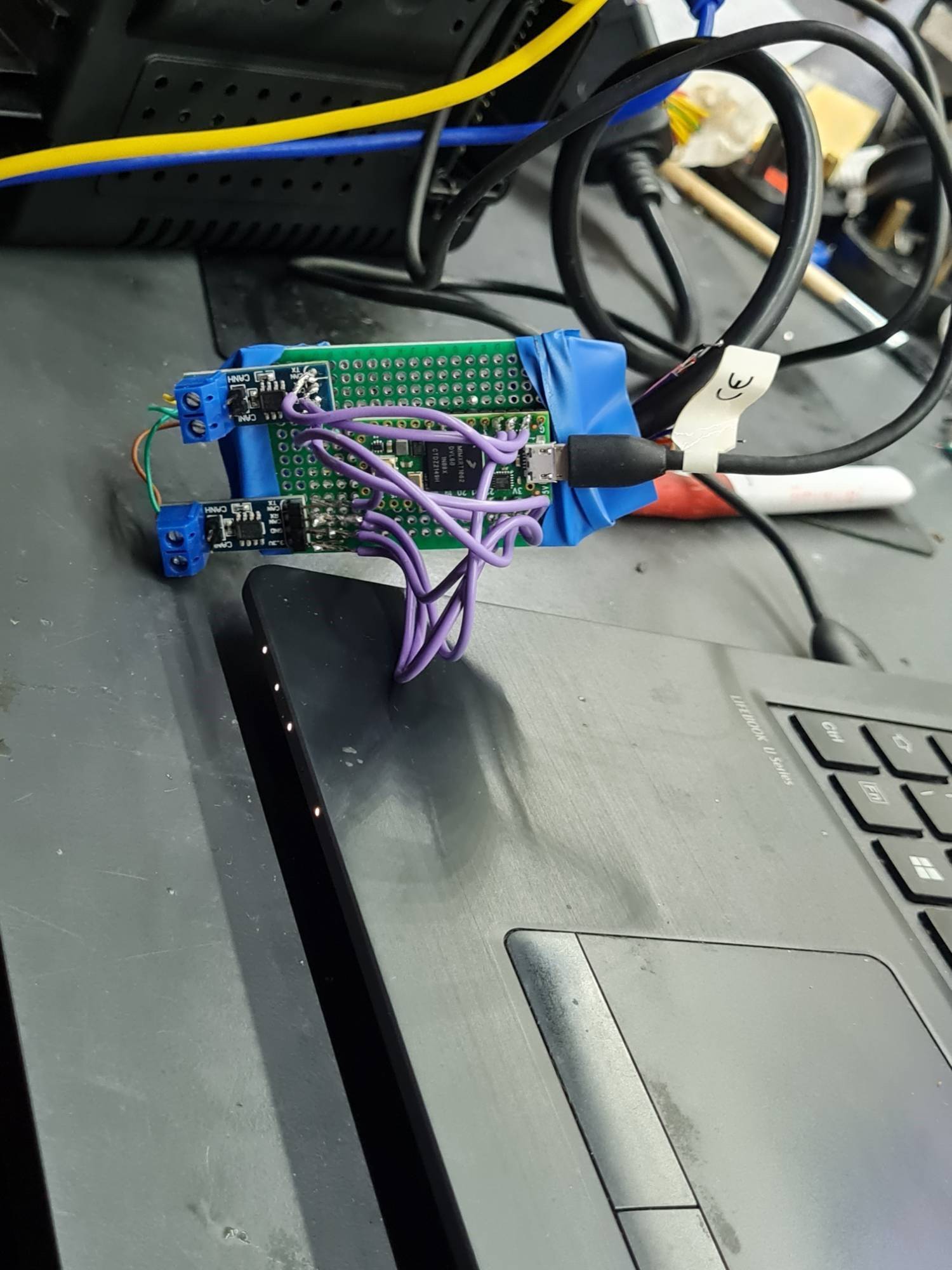

So I managed to get some wires shark boards , I have no idea if they will work.
It looks abit of a mess i went down the route of finding some from amazon previously. they came through today. so i made a start on what i had. the obd cable is some rubbish set up the wires aren't even twisted. hopefully thats not going to cause much of a noise issue. I uploaded the ino file to my teensy 4.0

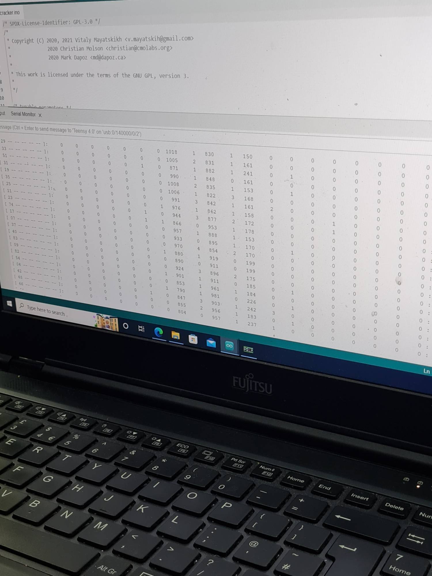

But would receive a Flex CAN error. And also a memory error?

Well I'm assuming it's doing something
