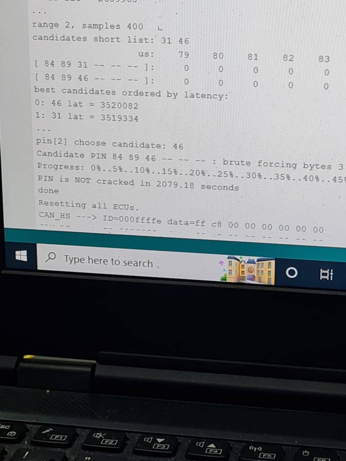

hmmm well thats not good news , this CEM has had some action on the EEPROM so maybe someone else has been at it and caused some sort of damage to it. i have another CEM i might play about with and see if that works. && i also have another one!, ll coming as i just Won it on eBay. lots and lots of testing and messing around!
hmmm didn't work cem cracker.jpeg (145.52 KiB) Viewed 752 times

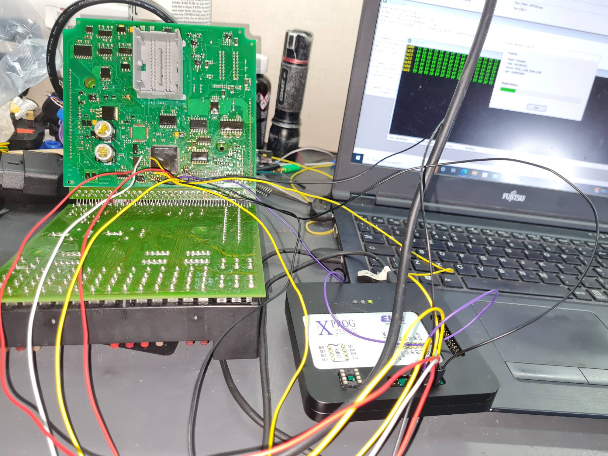

I tested the cem cracker on it , but it didn't work very well although further testing is coming
I have instead gone down the route of coping the microcontroller. M32c
If I where to copy the m32c on board microcontroller to another one I have with the same part number would I need to perform a checksum on the data before I copy it over to the other one ?

You have to copy eeprom 93c86 as well

ZRimaZ wrote: 18 Oct 2022, 06:30 You have to copy eeprom 93c86 as well
No worries , I'll certainly do that. , does the microcontroller need a checksum performing in it if its a straight copy over?

No, just copy/paste 😁

Ah ok 👍 , I always assumed any data transferred from Microcontroller to Microcontroller. A checksum is required. , I must be getting mixed up with if data is modified then pasted in to the target Microcontroller.
