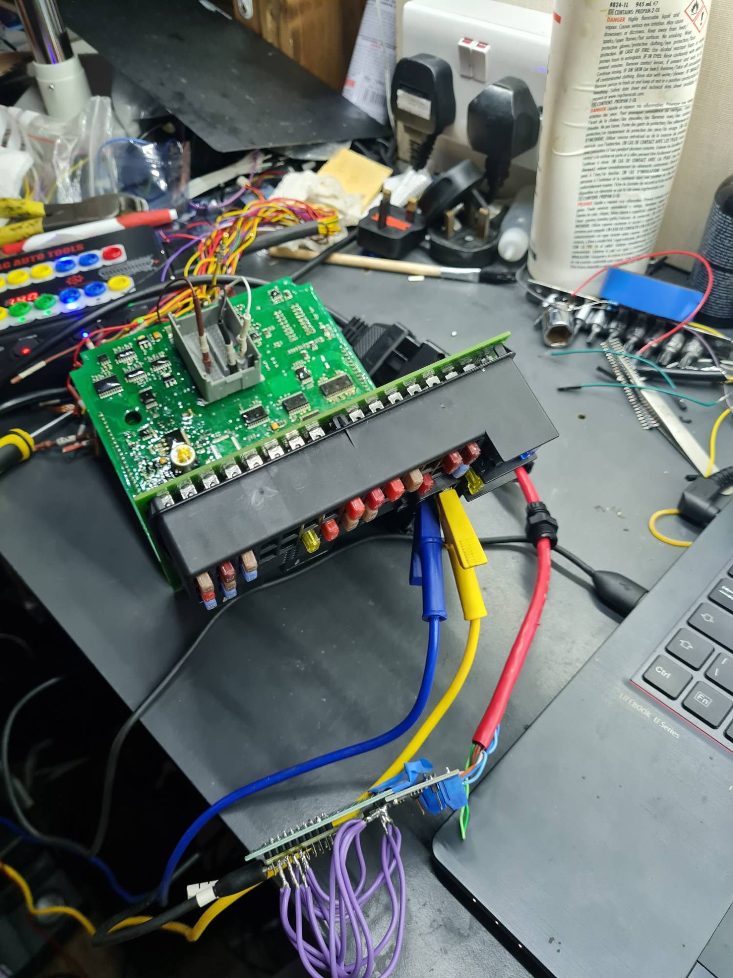

Obd port turned up today. So I figured I'll give some twisted wires ago and see if it makes any difference I'll I await the other transceivers to arrive from the states.

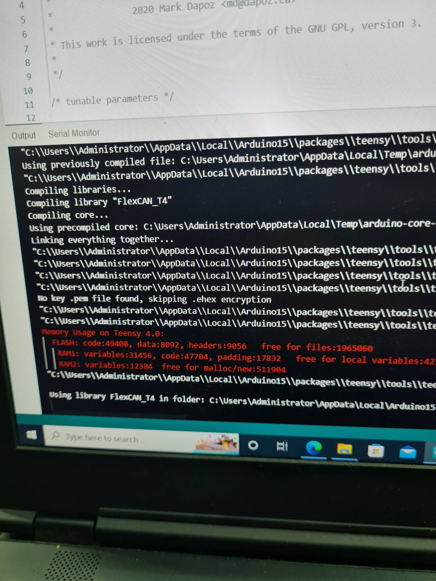

This memory fault appears when I compile ? But doesn't appear to impact the functioning of the tool. And there is also encryption file missing ? Is that something I Need ?

so following on with the cracker. i did notice it only finds the CAN LS not the CAN Hs , so i am assuming i am having a connection error with the CAN H signal. i'll check over my wiring again. then again it may well be somthing to do with the CAN shark all in one modules i am using. so it is hardly surprising i'm having issues but it's a wild guess. at this stage.
it didn't decode it again , next time i'll take a pic as the error doesn't really make much sense.
