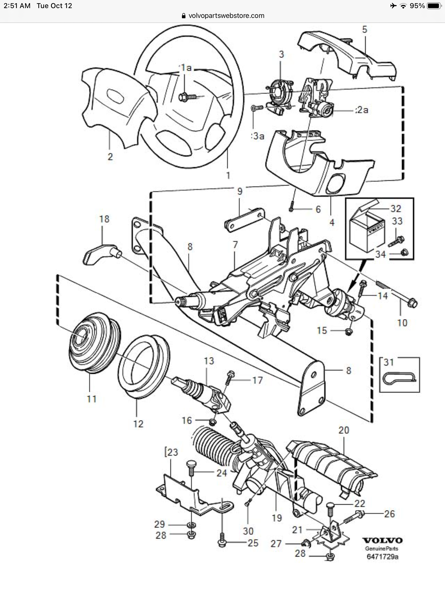

P80 steering column universal joint 9485812 and hardware

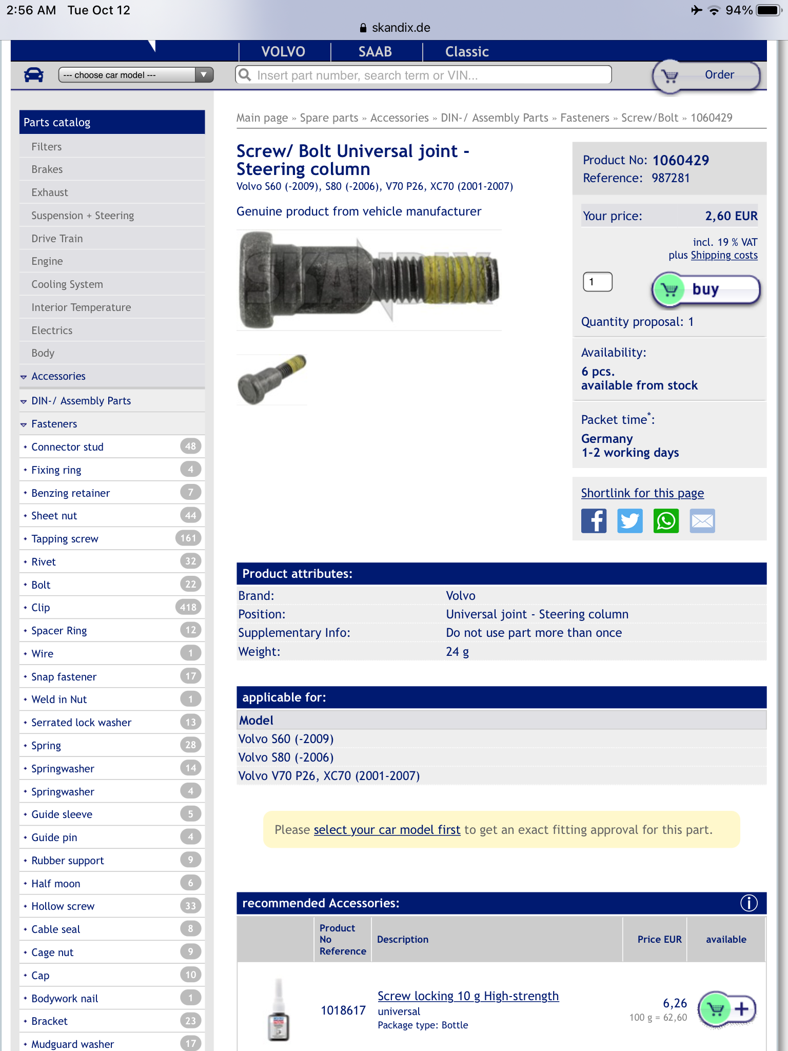

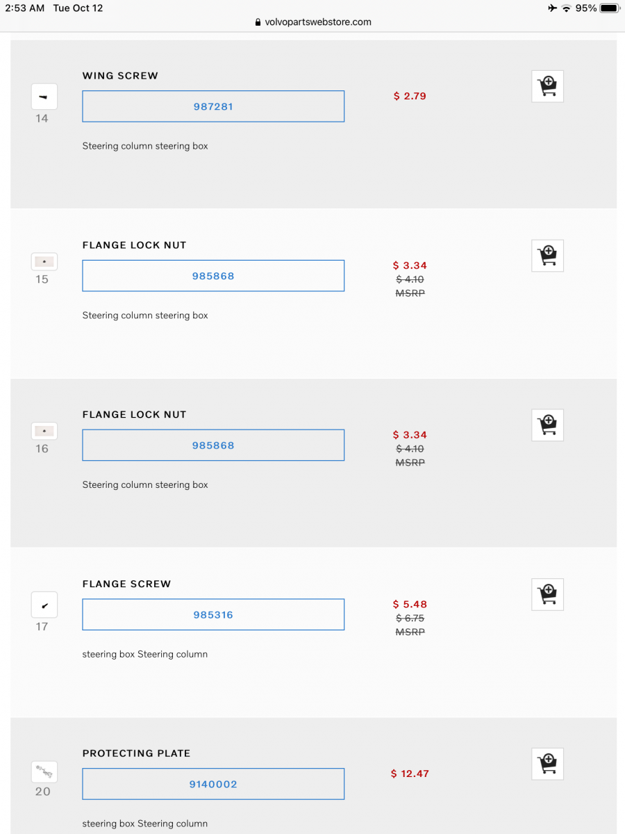

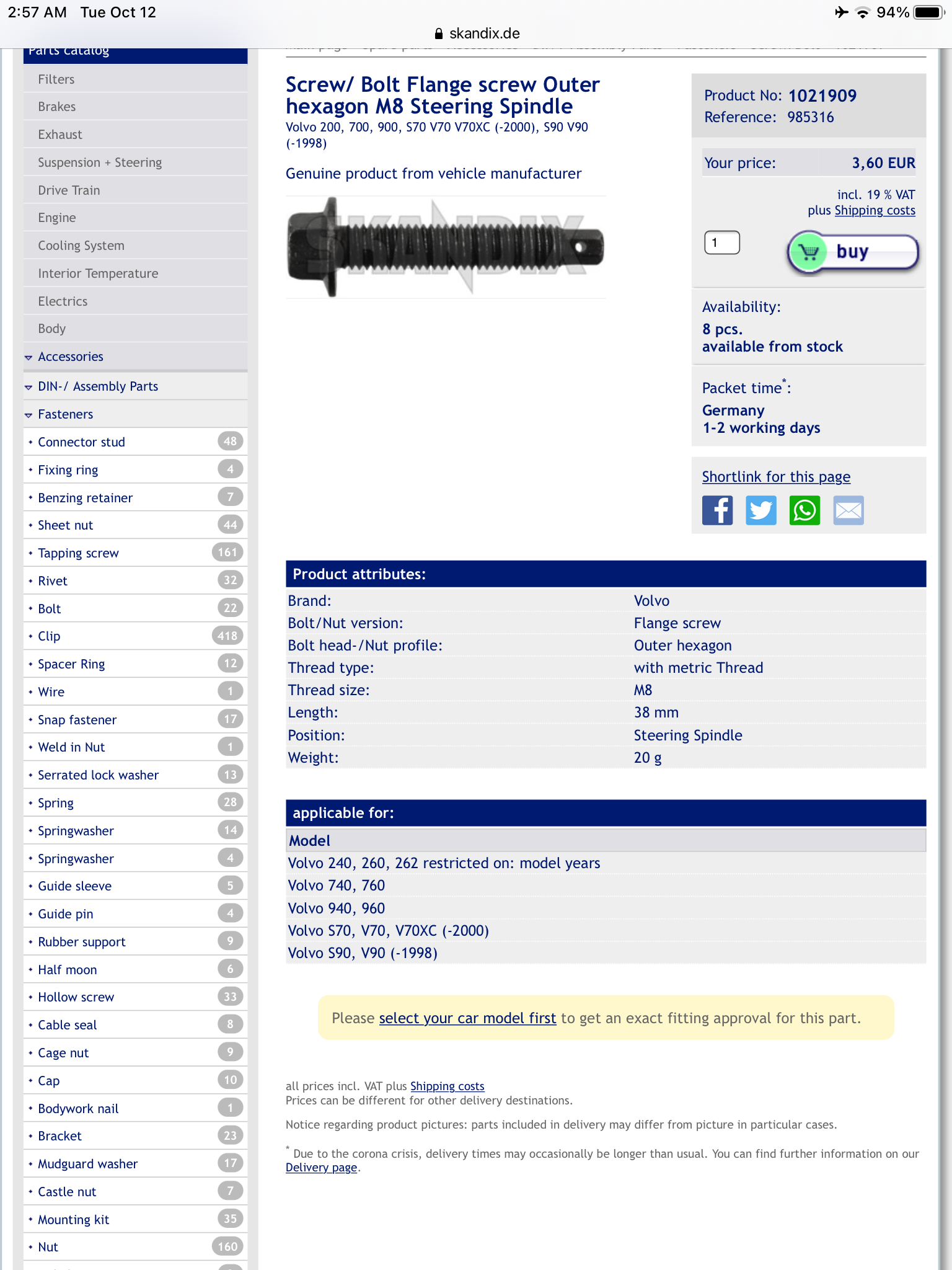

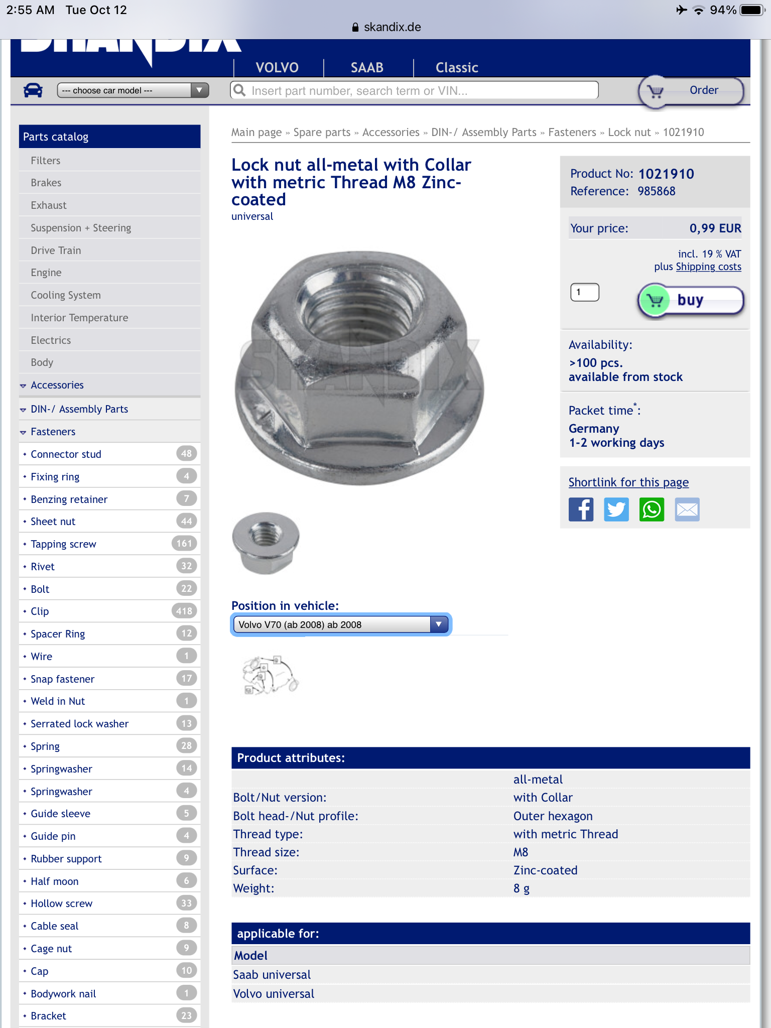

Are -316 and -868 single use ? I was planning on threadlock anyway when I finally get around to the 99 subframe, but wonder if I should toss those parts for new ?

Or for less than the cost of three of those M8 distortion lock nuts ("-868") perhaps a pack of 25 for $8.57 from McMaster-Carr, part number 3528N12. They are zinc plated, presumably that's the same as the factory finish? Share them with your friends doing P80 rack work, it's a small club anyway!
Add them to your order when you buy the stainless steel acorn nuts (pack of 20, part number 94000A038 for $5.10) and partner M6 SS washers (pack of 100, part number 93475A250 for $5.40), for all of the license plate holders in your fleet. Actually I think I bought the acorn nuts cheaper, on eBay. It's nice not to have them rusting out every few years.

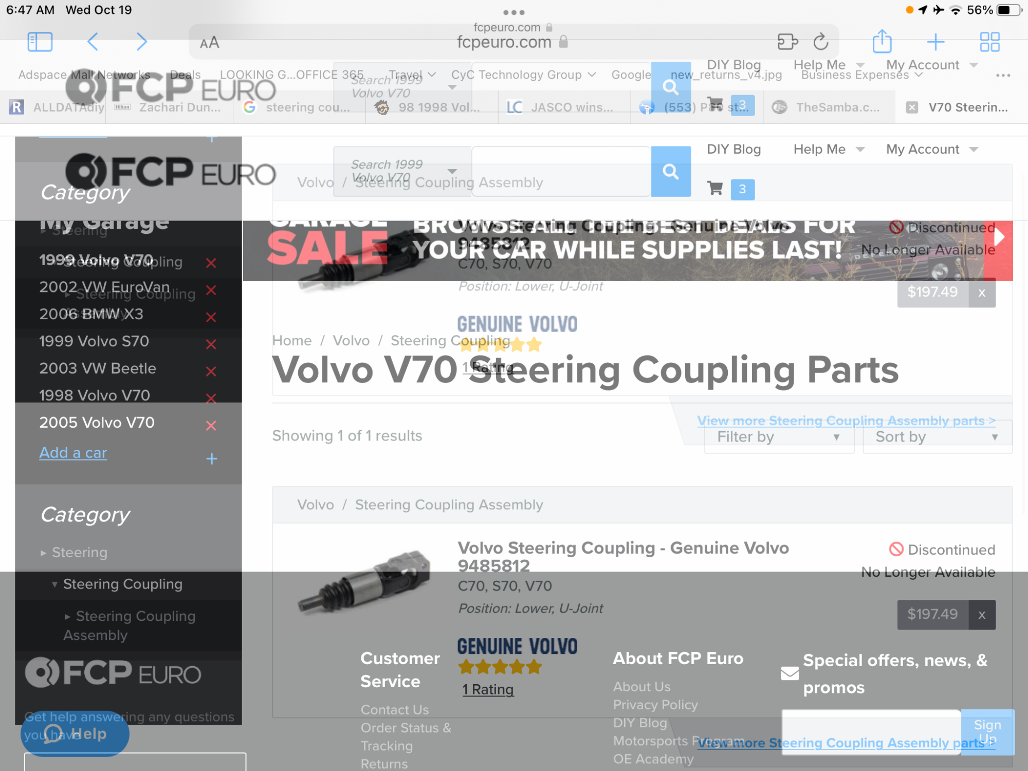

Update 10/2022
9485812 is now NLA new, so harvest those good junkyard parts
