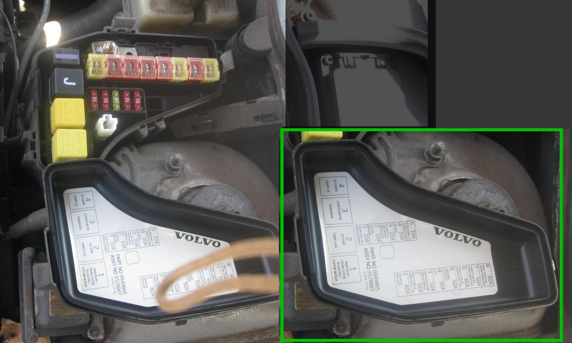

Yeah ha ha im just kind of finding out about that now, but guess what. Cant find the fuel pump relay.foggydogg wrote: 26 Oct 2022, 09:23 If you have never changed the fuel pump relay, that is one of the easier troubleshooting steps, and if it's original to the car, you should do that as a maintenance item anyway.
Avoid URO and ProParts, Volvo is best but pricey, Stribel is OEM. I just bought some that were boxed as Meyle but turned out to be Stribel.
Here is an actual pic of the car where the relays and fuses are under the hood.
I see other relays, but nothing labeled as a fuel pump, only a fuse for the fuel pump.
Is it somewhere else on this car ?
Thanks.
Note the green outlined inset is a better picture of the labels the camera cord got in the way of that first pic.
