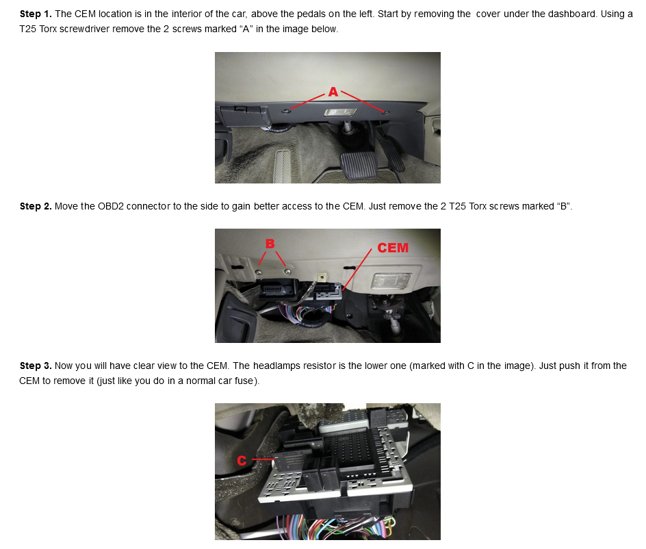

Where is it located ?
Under the passenger dashboard or the windshield wipers?
Two different videos online.

So I got it back. Installed. Everything seems good.
But, the tail lights. Front and back aren’t shutting off.
Help !
