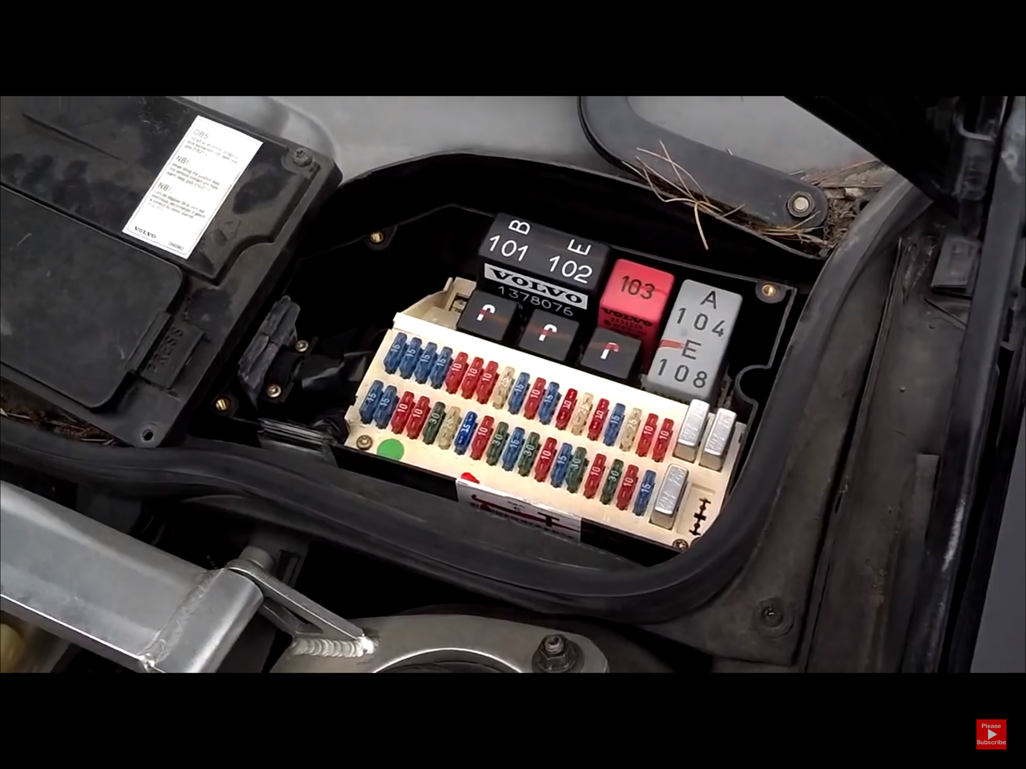

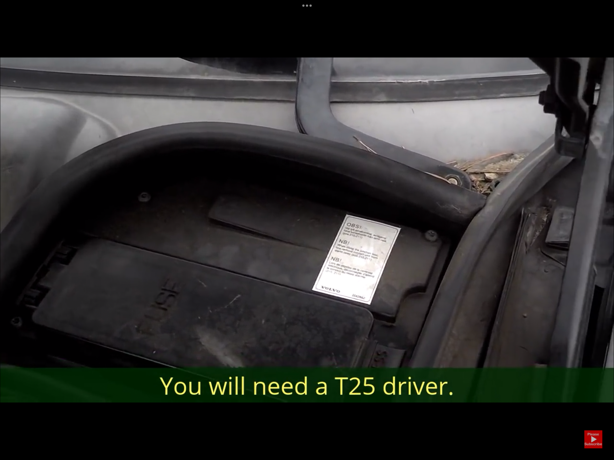

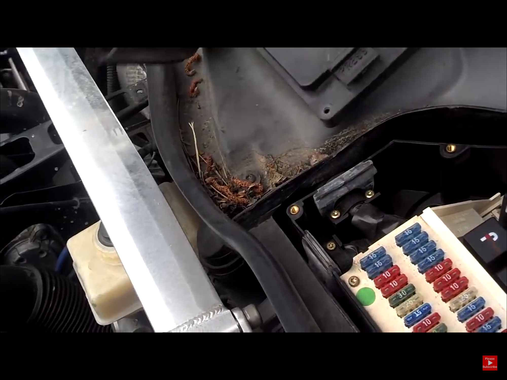

The fuel pump relay lives under the fuse panel under the dash cowl. You have To release the top,with some tire screws to get access
Screen grabs from Robert Spinners video

the fuel pump relay is under the main fuse panel, ie look at the top right section if standing at the front of the hood, or the area where the windshield meets the drivers side of the hood. You need to undo the 4 torx screws and lift up the lid. The tall square based relay should be for the fuel pump. 103 if i recall correctly.MrAl wrote: 26 Oct 2022, 11:03Yeah ha ha im just kind of finding out about that now, but guess what. Cant find the fuel pump relay.foggydogg wrote: 26 Oct 2022, 09:23 If you have never changed the fuel pump relay, that is one of the easier troubleshooting steps, and if it's original to the car, you should do that as a maintenance item anyway.

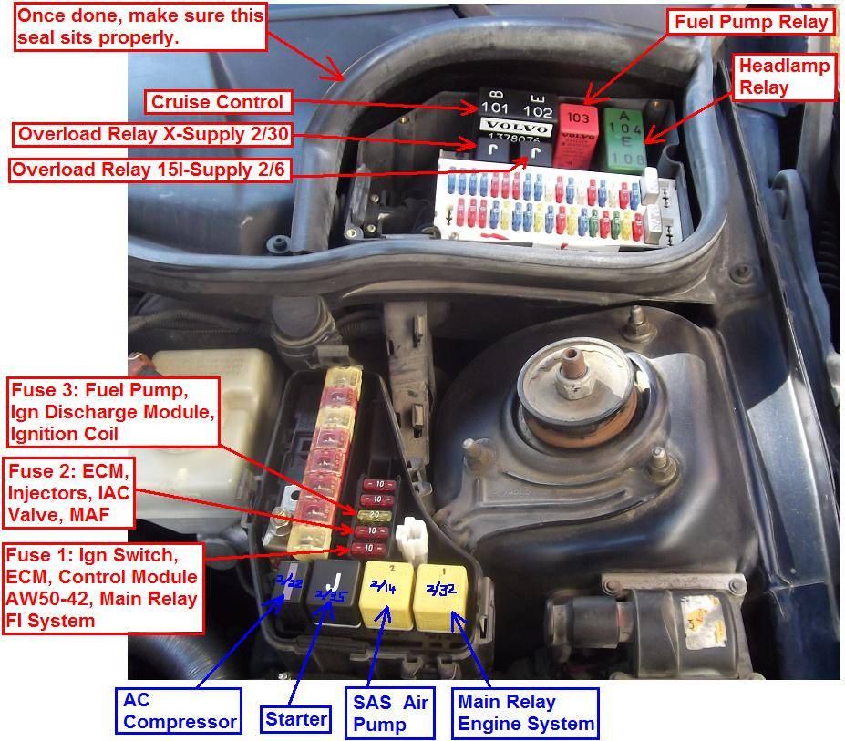

Here is an actual pic of the car where the relays and fuses are under the hood.
I see other relays, but nothing labeled as a fuel pump, only a fuse for the fuel pump.
Is it somewhere else on this car ?
Thanks.
Note the green outlined inset is a better picture of the labels the camera cord got in the way of that first pic.
Thanks.

So i have to take the main fuse panel off? Is that the one with all those littler fuses?
I had a feeling it was somewhere else other than with the other relays. Since it would make a lot more sense to put it with the other relays it makes even more sense that Volvo wouldnt do something that makes sense (ha ha ha). I say "Volvo" but it's really the computer systems that mess these cars up, even in other makes and models. The computer systems complicated things so much that it makes it a small miracle that any cars run at all anymore. Could you imagine the problems that are going to come up with self driving cars in the future? I hate to think about it as they rely on computers to navigate, even going 70 mph on a highway.

Yes and no; it's in the main fuse panel, but you have to unscrew the four torx screws and take off the top. It helps to pull off the small rubber
seal first. The screws are captured, they unclamp the cover and stay with it.
Picture from an earlier thread on MVS: Red 103 is the item of interest, if it's original to the car you need a new one anyway, even if it isn't the culprit.

Oh that's great thanks. Nothing beats a picture like that, and that is well detailed too i see.foggydogg wrote: 27 Oct 2022, 06:26 Yes and no; it's in the main fuse panel, but you have to unscrew the four torx screws and take off the top. It helps to pull off the small rubber
Ok i saw the torx screws on mine too now so i know what to do, thanks much really.

I hate to ask this but, does anyone know the number of the torx bit for the relay box top?
I want to check the relay for the fuel pump but not sure what the torx bit number is i may have to order one.

Dr. Abscate mentioned T25 in his post above, sounds right to me.
