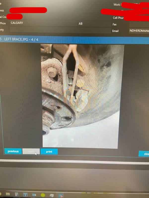

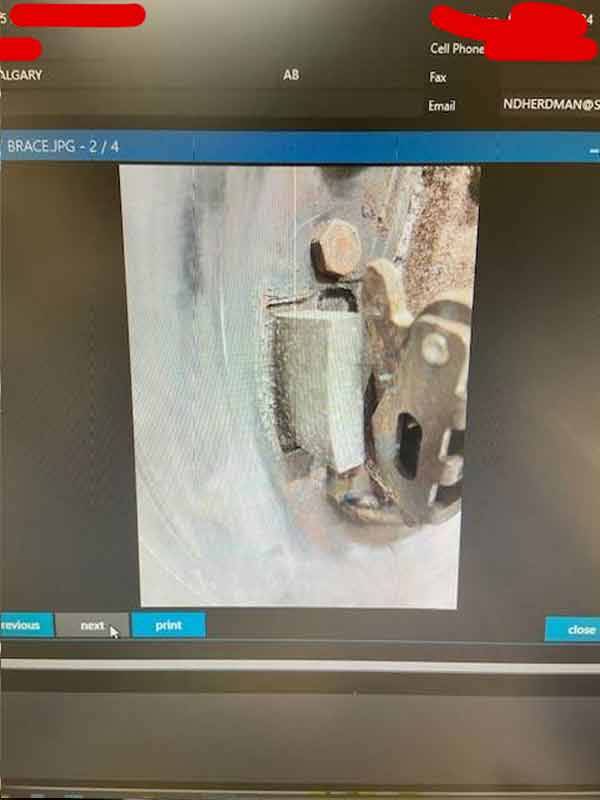

So here is an update on our son's car. It is an 06 XC70 with a similar mileage (close to 190kkm) as my buddies son's car that had the rear parking brakes destroy one side hub when the nub that the parking brake shoes pivot on sheared off.
I decided that as our car has similar mileage and age, I would have a preventative repair done on the rear brakes. I was going to do it myself, but my back is out just now so I took it to the local Volvo dealer who agreed to tackle the repair. We would still pay for the repair but they would get to do the work on it as a learning process as the manager had never heard of the issue.
Well I bought the Skandix parts and also took the new Brembo rotors, Volvo OE parking brake shoes and hardware, as well as a set of Akebono rear pads. They would install these for me as part of the work. Not sure the brakes needed done just yet, but as the parts had been on the shelf in the garage for close to 4 years (at least) and the (at least) 13 year old parts were coming off anyway, it made sense to me to swap in the new parts.
Anyway, they got in there and found the nubs to be totally fine with no corrosion issues which is not what I expected.
They called to ask if we still wanted to go ahead with the repair but after discussion we decided against it and just fit the new brake parts. Now I have a 2 post hoist I can look at this annually and see if there is any degradation requiring the repair to be done.

This is something I would suggest those of us with P2 cars (XC70, V70, S60 and possibly XC90?) carefully check for if you live in areas where salt and/or de-icing agent are used on your roads.
