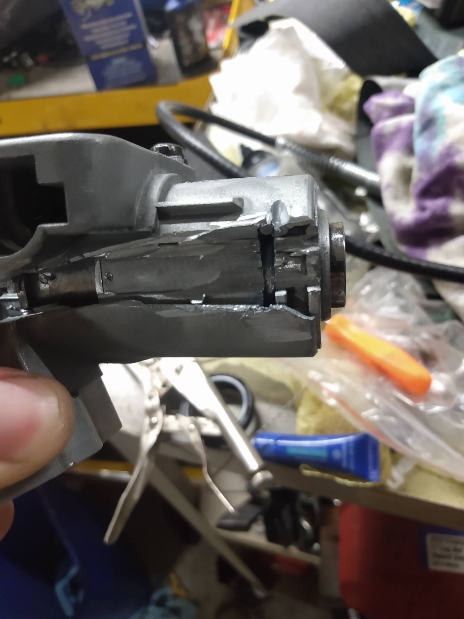

I cut a 1998 Volvo s70 ignition lock apart. In the small groove running around the lock body there is a steel ring and holding the ring in place is a tab that runs across the entire body of the lock, so once you get the end of the tab out of the way you can pull the steel ring out a little bit and cut sections off, once the ring is out the lock should come apart. once you get the lock apart and fix what's broken I used a piece of coat hanger to make a new ring, and then put Loctite on the ring to make it impossible to take apart
in this picture you can see the small groove where the coat hanger is, and the large section i cut out while following the metal tab (the end of the metal tab pokes out where the steering lock pieces live)

If you go to my lock cylinder thread you will find where to drill two holes to compress that ring to pull out the lock cylinder
After all that work , you won’t be able to buy replacement tumblers for the lock, though. They are NLA from manufacturer and locksmiths won’t sell them to you.

I don't understand the goal of this work. Could you explain me what you are expecting ? As a newbie, this seems a bit weird...turboenjoyer wrote: 02 Nov 2022, 09:37 I cut a 1998 Volvo s70 ignition lock apart. In the small groove running around the lock body there is a steel ring and holding the ring in place is a tab that runs across the entire body of the lock, so once you get the end of the tab out of the way you can pull the steel ring out a little bit and cut sections off, once the ring is out the lock should come apart. once you get the lock apart and fix what's broken I used a piece of coat hanger to make a new ring, and then put Loctite on the ring to make it impossible to take apart
