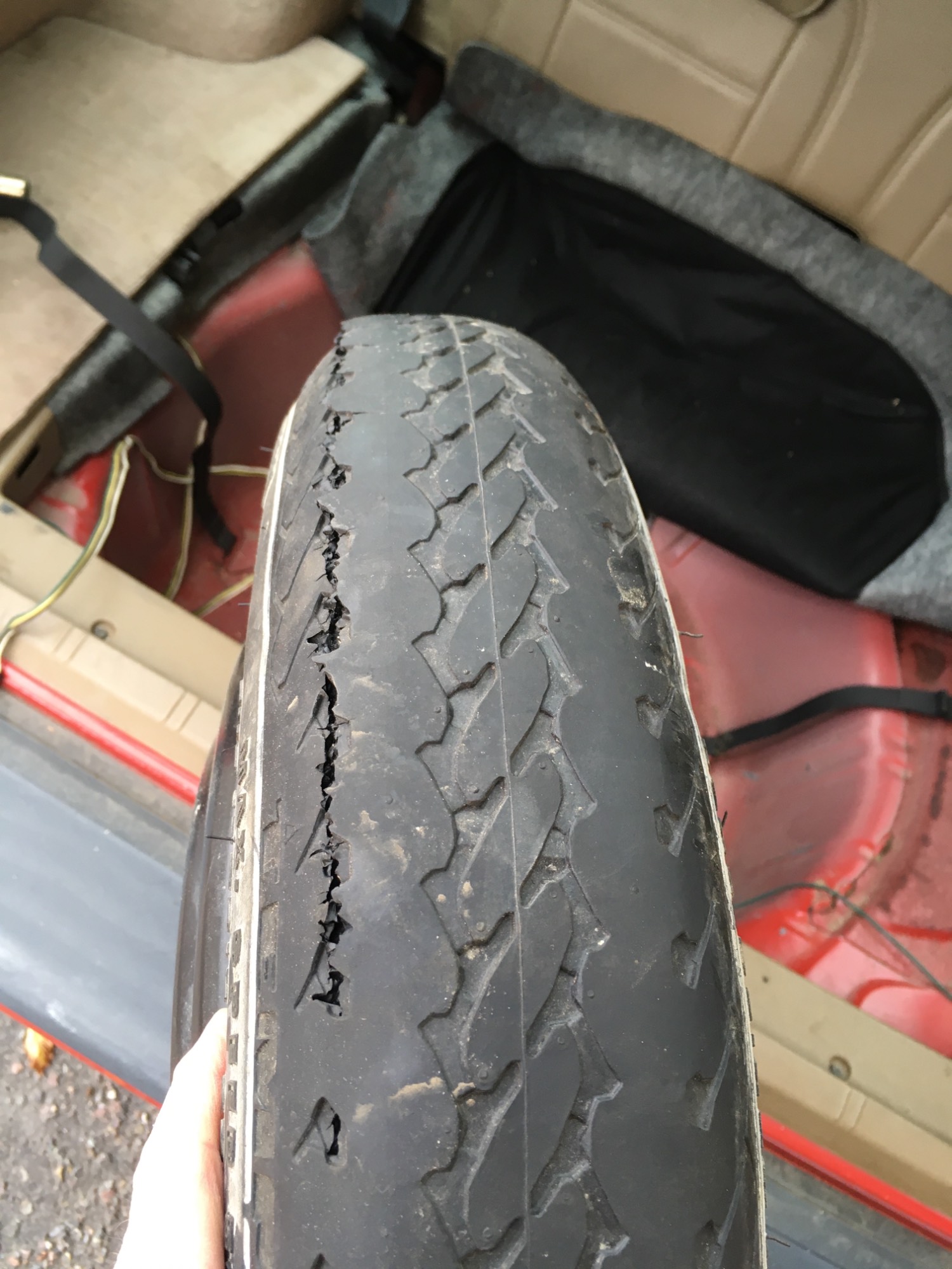

I recently had to deal with this. I discovered that the limited use spare in the trunk of my '95 850T Sedan had at some point blown up - the rubber was entirely torn and ripped open. I have no idea when this happened, although probably within the last 1-2 years, and probably shortly after the last time I set it to the correct pressure, whenever that was.
I understood that a full size spare would fit in the 850 trunk, so I bought a full size tire to match the rest (205/50R16) plus a new steel wheel for it. Well, it doesn't fit. I took out the plastic liner, which helped, but it's too wide. I can get the tire in there, but the trunk carpet does not sit flush, it's ~1-2 cm raised in the middle.
Tire Rack has replacements for the Limited Use Spare - I've thought about getting one hand having it mounted on the original Limited Use Spare wheel. However since I do have a functioning spare, it's no longer an urgent need, so I haven't done this yet.

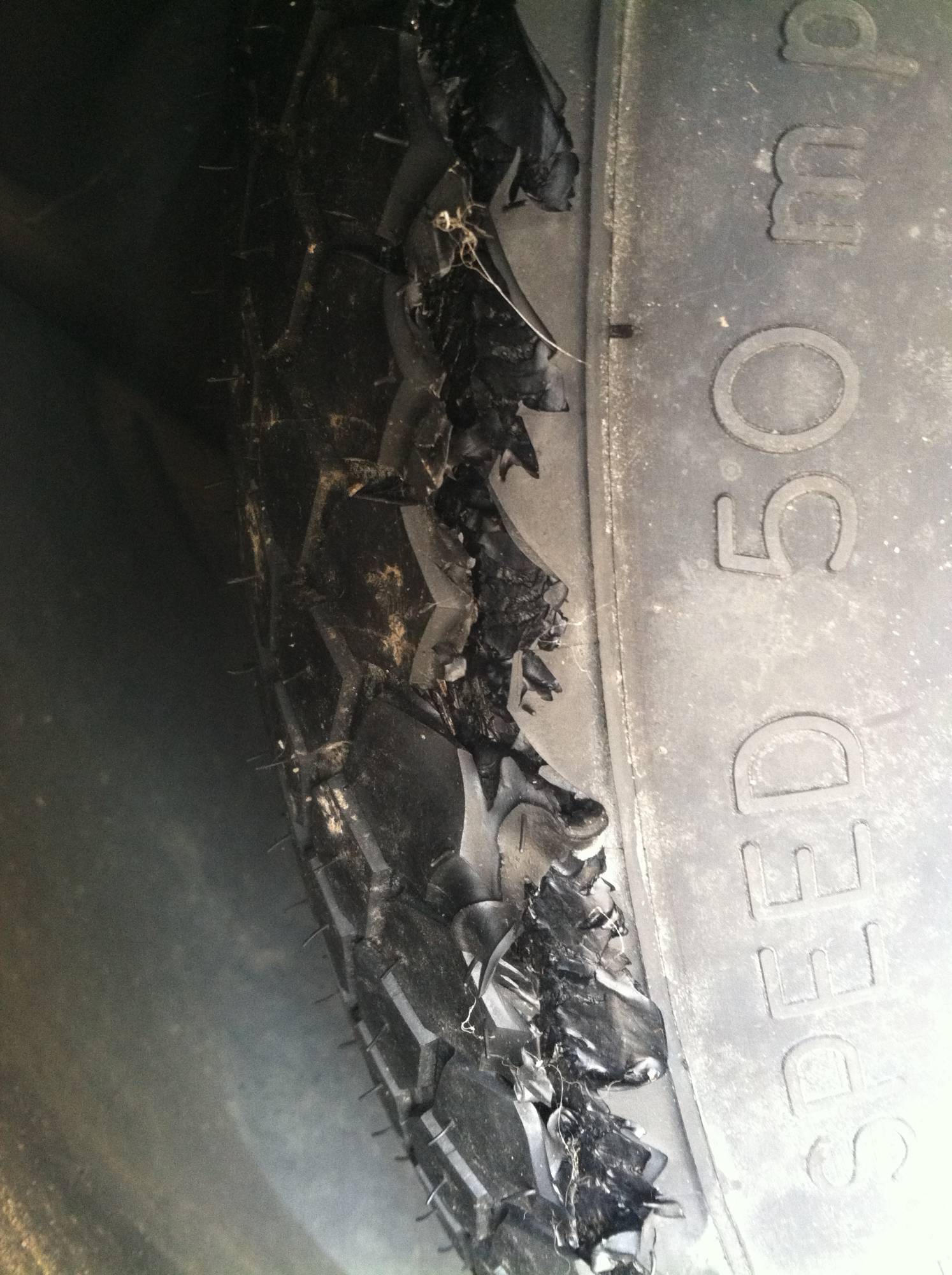

Can't remember which car this came in, but note the new tire nubs.

foggydogg wrote: 31 Oct 2022, 14:10 Can't remember which car this came in, but note the new tire nubs.
Yep, that's what mine is doing - just splitting.

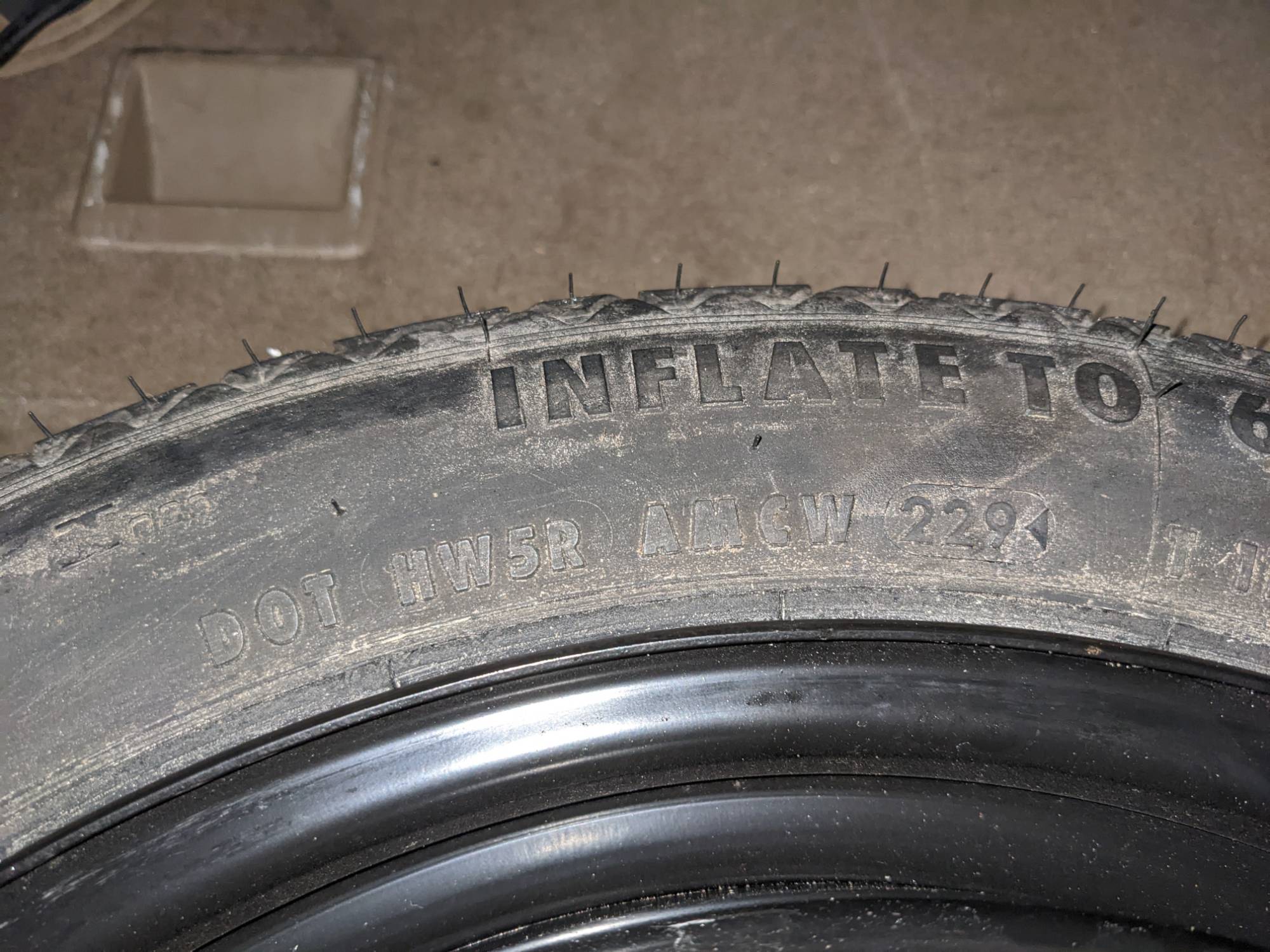

Public service announcement: Whatever you do with your spare, inflate it to the correct pressure. Check that pressure twice a year at least.
My doughnut spare is a Continental CST 17 (just like the 2013 XC70 in my other thread). Yes, it's over 20 years old with a three digit date code of "229", showing a May 1999 manufacture date. Upon examination, it looks solid with no cracking or splitting. I inflated it from 22 psi to the mandatory 60 psi.
I'll try fitting one of my 16" wheels in the spare well to see if I can keep a full size spare to match my set.

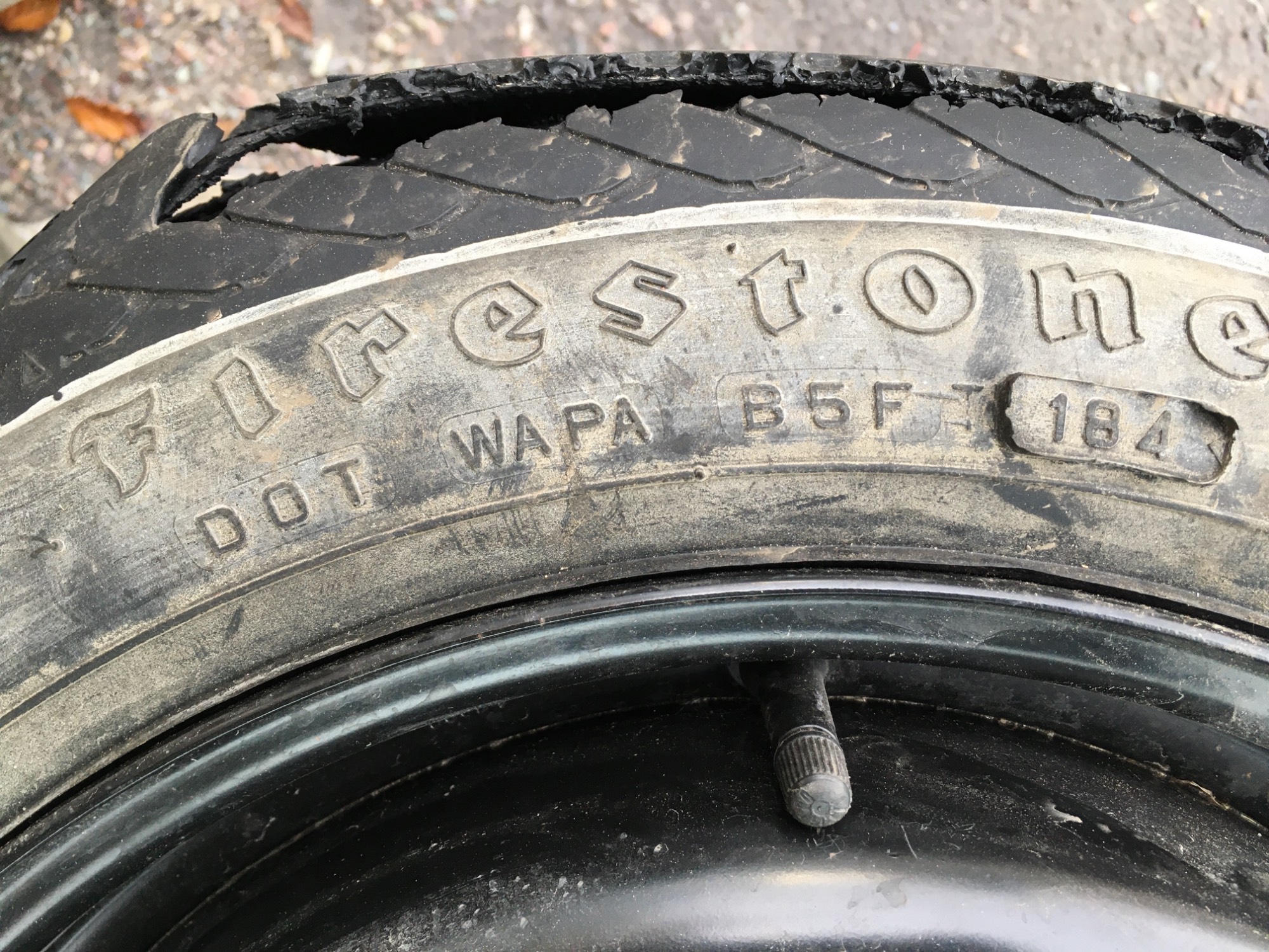

This made me go dig mine out of the 850 trunk. This car isn't used so I haven't replaced it.
Firestone "Made in France." What does this date code mean, 184? The car's a '94 and it could be original.
