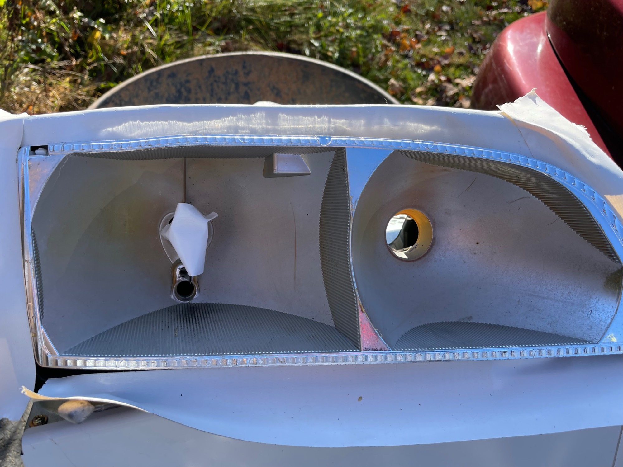

Well, I tried the spray approach and it isn’t bad, haven’t tested pattern yet

I am about to embark on my own solution on my P80 C70. First white is ~ 80% reflective. Going to paint the reflectors with Gloss White Appliance Epoxy. That should recover 80% and give a durable finish. Then I am going to replace the H7 Halogen Bulb bulbs with OXILAM 16000lm H7 LED Fanless Headlight Bulbs. These bulbs are said to be 5 times brighter then Halogen Bulbs. 80% X 500% = 400%.abscate wrote: 03 Nov 2022, 18:24 Well, I tried the spray approach and it isn’t bad, haven’t tested pattern yet
Will it float ? .. going to find out.

I have the Oxilam LEDs for my high beams, and I'm not impressed. The bases are not well formed, and rock up and down in the housing.RickHaleParker wrote: 05 Nov 2022, 23:37OXILAM 16000lm H7 LED Fanless Headlight Bulbs.[/url] These bulbs are said to be 5 times brighter then Halogen Bulbs. 80% X 500% = 400%.

Mine should be here next week. I will look into it. Perhaps they can be shimed with a large flat washer.454cid wrote: 06 Nov 2022, 03:35 I have the Oxilam LEDs for my high beams, and I'm not impressed. The bases are not well formed, and rock up and down in the housing.
Is the light intensity as high as they claim?

Yes, They do really light up the road. In fact sometimes it's too bright when I'm driving through construction with lots of reflective barrels/markers everywhere.RickHaleParker wrote: 06 Nov 2022, 18:13Mine should be here next week. I will look into it. Perhaps they can be shimed with a large flat washer.454cid wrote: 06 Nov 2022, 03:35 I have the Oxilam LEDs for my high beams, and I'm not impressed. The bases are not well formed, and rock up and down in the housing.
