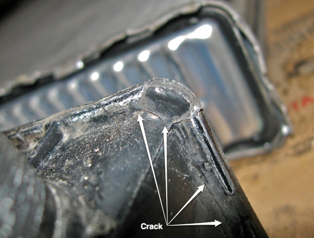

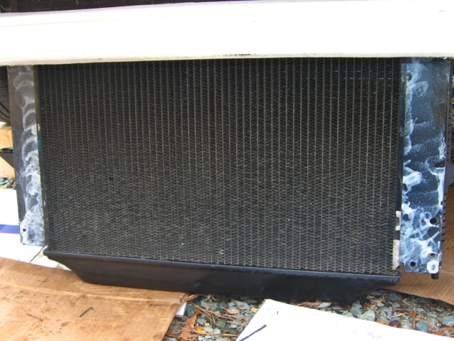

The radiator on my '97 855 GLT developed a crack in the plastic endcap near the upper radiator inlet. I replaced the radiator with a new one from Volvo (OEM Volvo made by Valeo). Along the way I took photos and wrote the whole procedure up step-by-step. It was a big job and I took lots of photos so it was easier to put it into a PDF file (attached below) rather than try to upload the images one by one to the website.
PDF of the procedure I wrote up: New radiator/intercooler assembly in position for lifting back up into engine bay (just one of many photos of the procedure -- download the PDF file for additional photos and description): I disassembled the old radiator afterward (there are more pictures inside the PDF of this): Take a look and let me know what you think. Enjoy!
