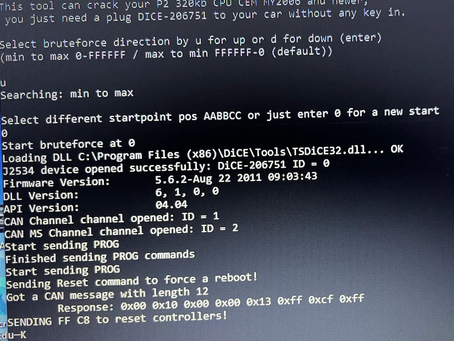

Dear T5LukeT5Luke wrote: 04 Sep 2022, 02:39 Sorry was 50 downloads only, here are both again...
Also Windows 10 doesn't notice me about anything, maybe it is location based on 3 computers i get nothing. Maybe defender in US sees something problematic in this code...
I tried to use UDSTool Crack to get PIN for my XC70, but got the following issue.
Car: XC70 2007, YV1SZ595771286825
Dice: Chinese clone, but works good (as per my experience).
Repro steps:
The car stayed for a day, I just opened it, connected DICE and run your tool. Did not touch ignition lock at all (so it was in position 0).
It tried to start the process, but failed (log below).
Repeated several times - no luck. Had a small conversation with vtl, he advised to ask for help here.
Does the response from CEM tells you anything useful? Vtl told me that it looks like one of modules did not enter sleeping mode and hence the response was bad. Any ideas how to fix it? May be you have any other build with extended logging?
- yagger
