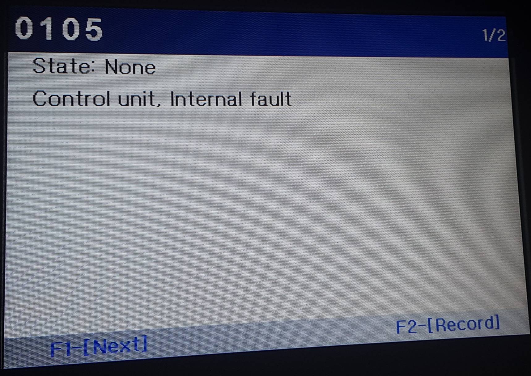

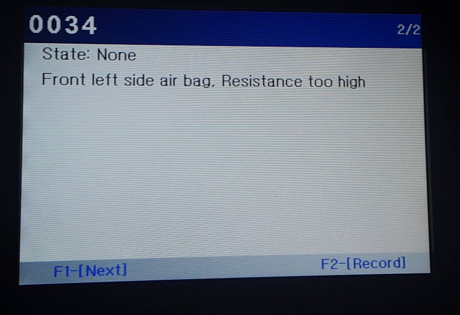

Oil change week...the kids 02 S60 2.4T today at 185,500 miles. Rotated tires, attempted clearing SRS code with no luck. His car, so left to him whether to repair.
Airbag recall yet to be done, on waitlist with local dealer.
