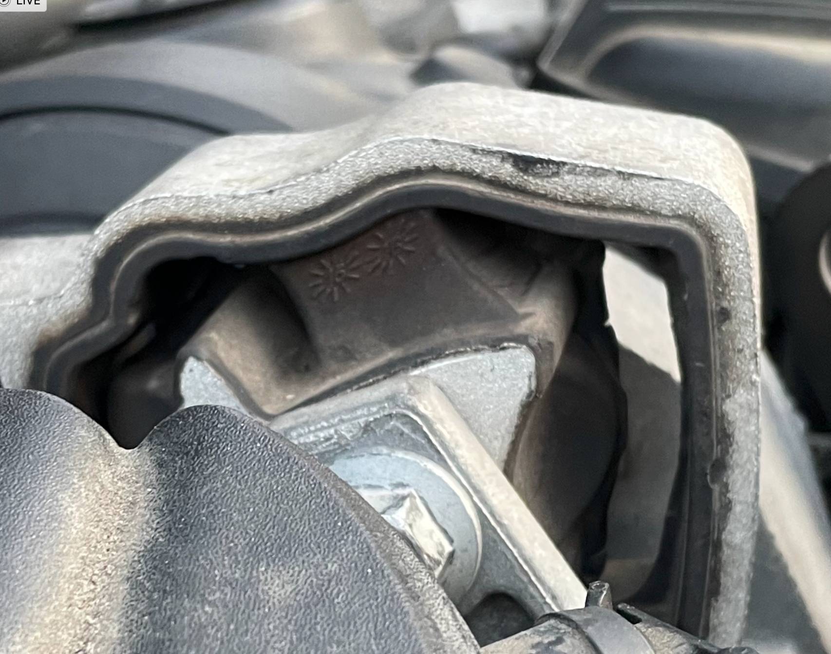

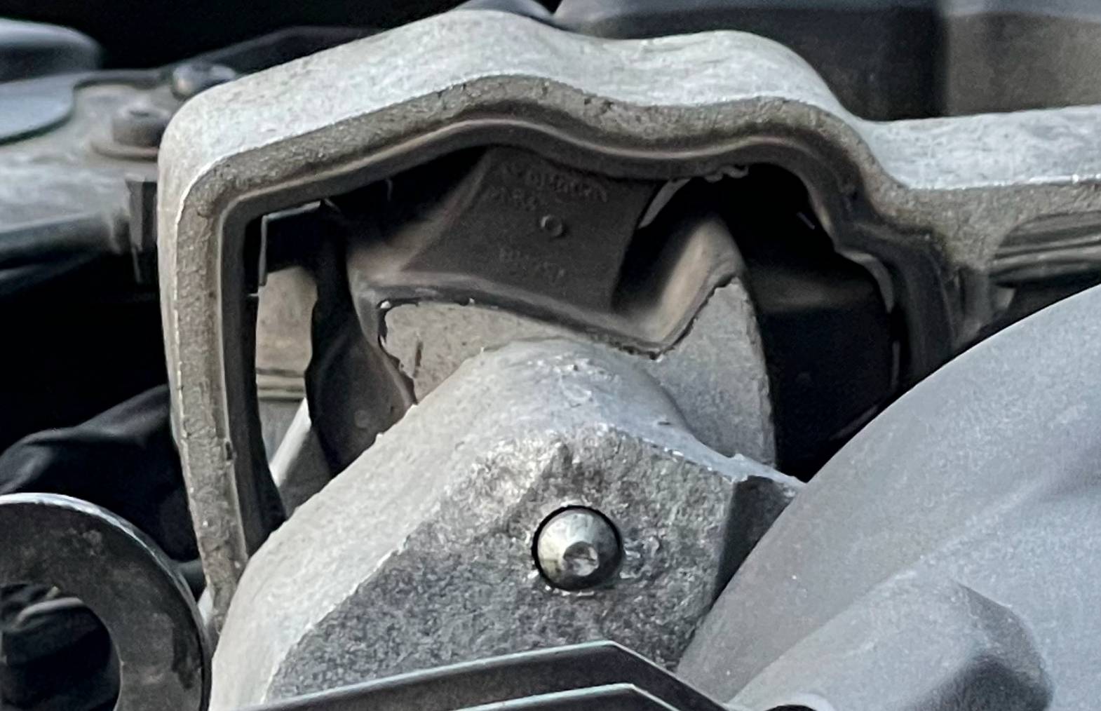

I think it's the torque mount. Though I've never seen a new torque mount, this one looks worn.
Also had my son accelerate from stop while I watched from the passenger side. The engine appears to shift a bit to the rear upon acceleration.
Can anyone confirm that I need a new torque mount? See pics.

Yes. Replace it.
Shouldn't see daylight through it right there.
