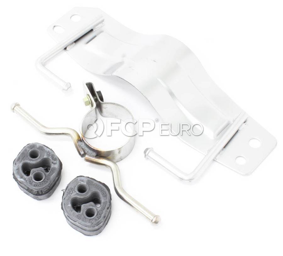

Post by vtl »
https://www.fcpeuro.com/products/volvo- ... t-30793794
vtl
Posts: 4936
Joined: 16 Aug 2012, 13:35
Year and Model: 2005 XC70
Location: Boston
Has thanked: 130 times
Been thanked: 686 times
Post by vtl »
Also, if you leave the pavement, I'd suggest doing the next mod to the bracket:
