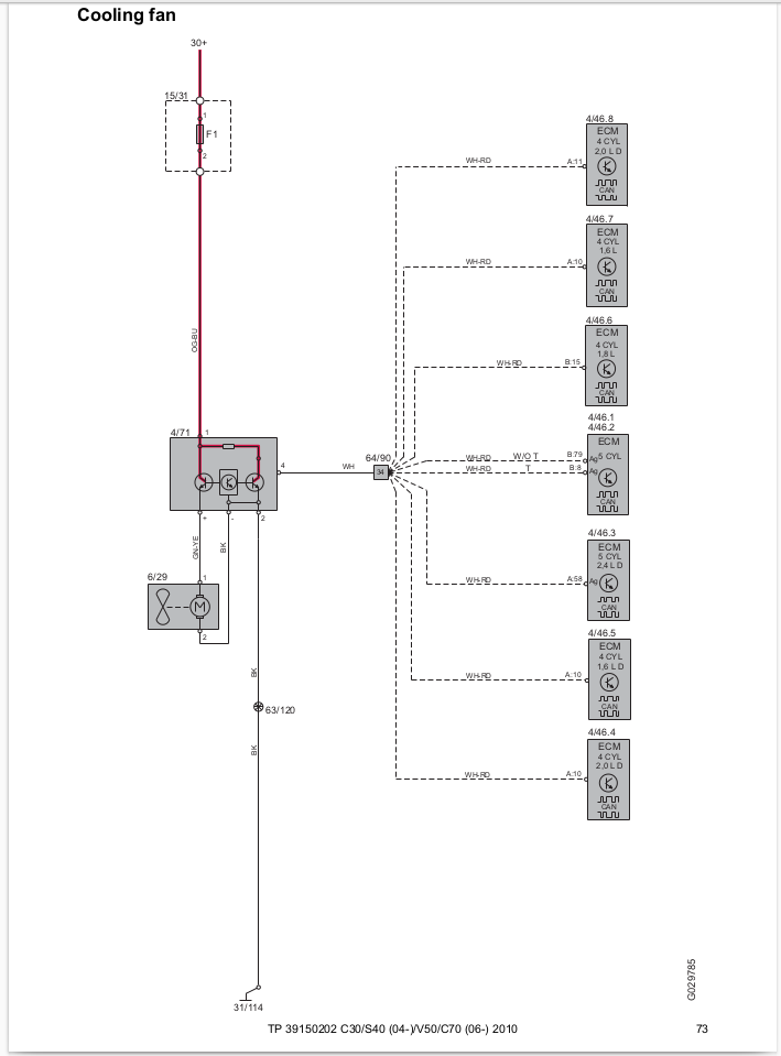

It is a pretty simple circuit. Check your inputs and connections. Are you getting a signal from the ECM?

RickHaleParker wrote: 21 Dec 2022, 16:24 It is a pretty simple circuit. Check your inputs and connections. Are you getting a signal from the ECM?
God almighty. Looking at that page- I was thinking..why does that diagram look slightly different from the one I've been seeing?
I realize now , my wiring diagram was TP3978202 - the 2005 version. Your diag. is 39150202. 2010.
I've been checking continuity back to b:7 on the ecm. It's actually supposed to be B:79 Jesus help me. I'll check see what is going on. I might have made a completely idiotic mistake of the wrong wiring diagram wondering how it wasn't adding up.

So i was definitely looking at the wrong wiring diagram.
But also, that fact didn't slap me in the face because someone has apparently put in a wiring harness from an older car- so the pins in the harness were matching what I was looking at, which was the 2005 or 06 wiring diagrams.
I moved the wire over..well actually broke the wire/ pulled it out of the little end- so I just stuck a big push pin through the whole which was empty. Turned on the ac, fan came right on.
Fan is still not coming on when the engine gets hot- but i imagine this is probably due to the fact that the harness is not correct. Something coolant sensor related I imagine. but, at least the head scratching part is over..the 6100 code is GONE .
Thanks so much RickHaleParker for the updated wiring doc! I would have probably still been out there scratching my head!
