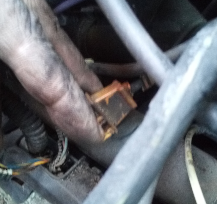

The car failed to start and exhibited the same symptoms it did a year ago.
This time, it "threw a code," the scanner indicating " P0340 Camshaft position sensor, bank 1 circuit malfunction."
Because the car would crank, had fuel pressure but no spark, I figured it was the cps, but I'm trying to confirm it.

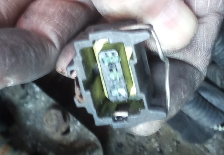

1. using an ohm meter setting I "rang out" all possible combinations of the wires going to the sensor. There was no continuity indicated. Does this mean that there is a break in the winding in the sensor? The connector to the cps was crumbly. (I'll attach photos if possible)
2. When I disconnected the sensor from the plug going to the wire loom, there appeared to be greenish grease-like substance on the locations (female side) the sensor plug's pins (male side) enter. Is this some form of dialectric grease?
I cleaned it out with a q-tip covered with WD40 but I didn't spray the connections.

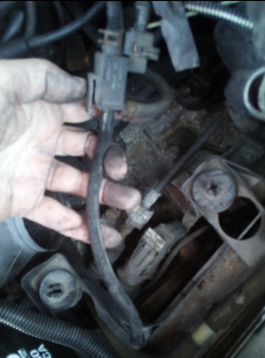

3. When I removed the air filter box to get at the connectors, there was junction block for vacuum hoses attached to it. the lower hose was disconnected and without a readily visible place where it should be connected.. Maybe someone can tell me where it goes; I'll try to attach photos.
4. I realize that there is a way to "back probe" the wiring to the car's computer. I didn't have the instructions with me today, so I didn't do it.

- crumbly cps connector

- where does the lower vacuum hose go?

- greenish goo covering the contacts

That green stuff is brass contact corrosion. Use an old tooth brush or brass brush with contact cleaner and clean all that stuff off. It acts as a barrier to electrical parts getting current. Check the one on the MAF as well. It is likely the same.

That’s the boost control valve for the turbo. That probably is the “ blue “ hose that returns boost pressure to the snorkel
Red hose brings pressure from the turbo casing
Yellow sends sends pressure to the wastegate actuator
Blue returns to snorkel
* the hoses are all black but were labeled with coloured bands from factory.
That missing blue hose also means you have a massive vacuum leak at the snorkel which will cause your symptoms

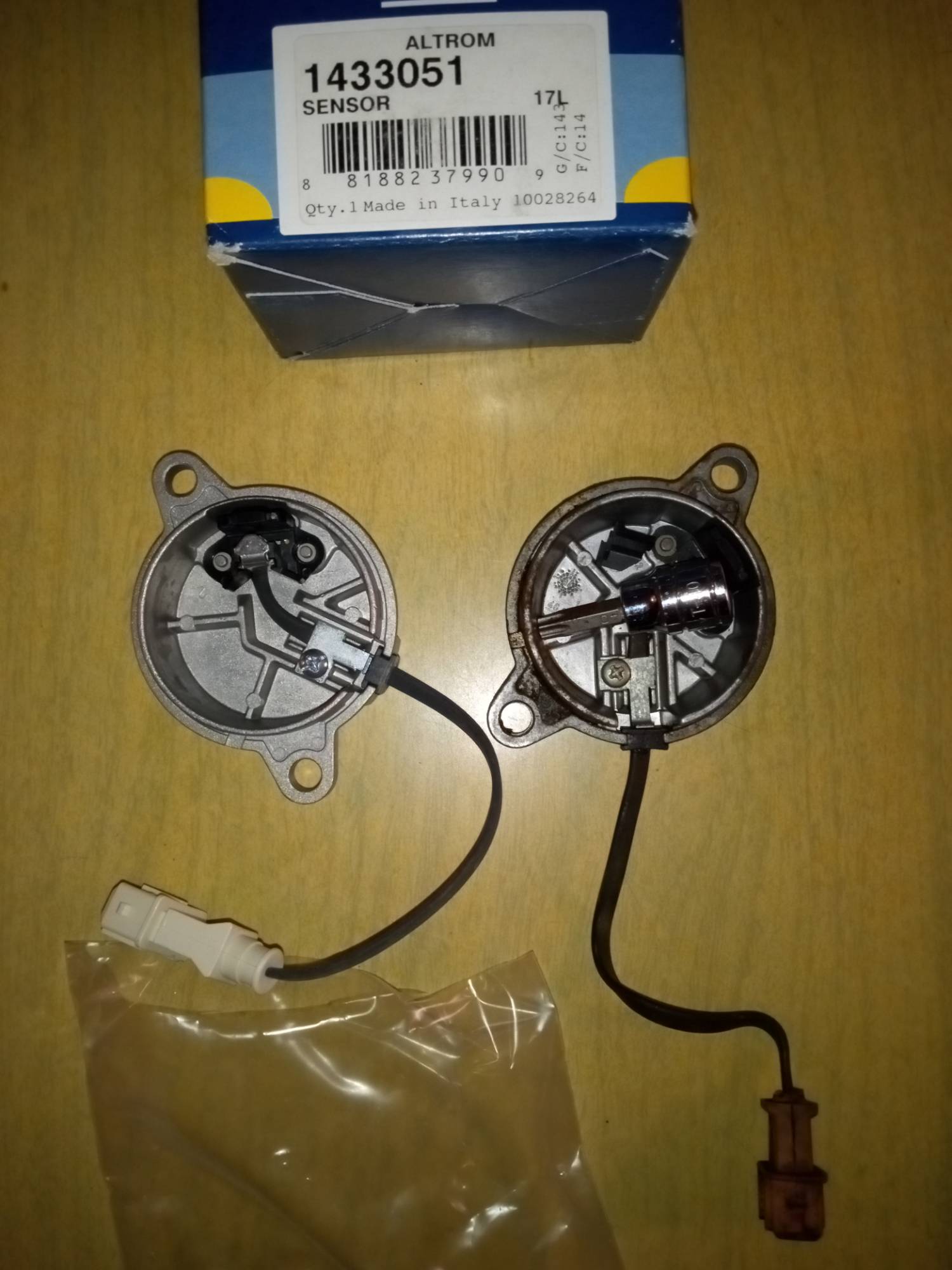

I changed the cam position sensor and the engine fired up with almost less than one full crank. So , I believe the crank no start problem has been resolved. Many thanks to everyone who helped me with it. I believe the nonconductive material holding he sensor inside the cps cap had deteriorated to the point that it affected the sensor, rendering the car inoperable. As soon as I touched it, attempting the check the conductivity of the leads, it broke. The replacement cost $125+/- and appears to have a similarly cast exterior as the original; the parts clerk telling me that it was the same manufacturer used by Volvo. How true that is, I do not know. The sensor appears to be the same, as well. (I used this parts provider because most mechanics locally use them, and they don't want to do the job twice : -)
I believe this part was failing intermittently for several years, but only during very cold days here in the Northeast, until it started doings so during the late summer. The Problem stumped at least one professional mechanic who could not resolve it.
I have yet to find the connection for the blue striped vacuum home, but I believe this problem is solved.
