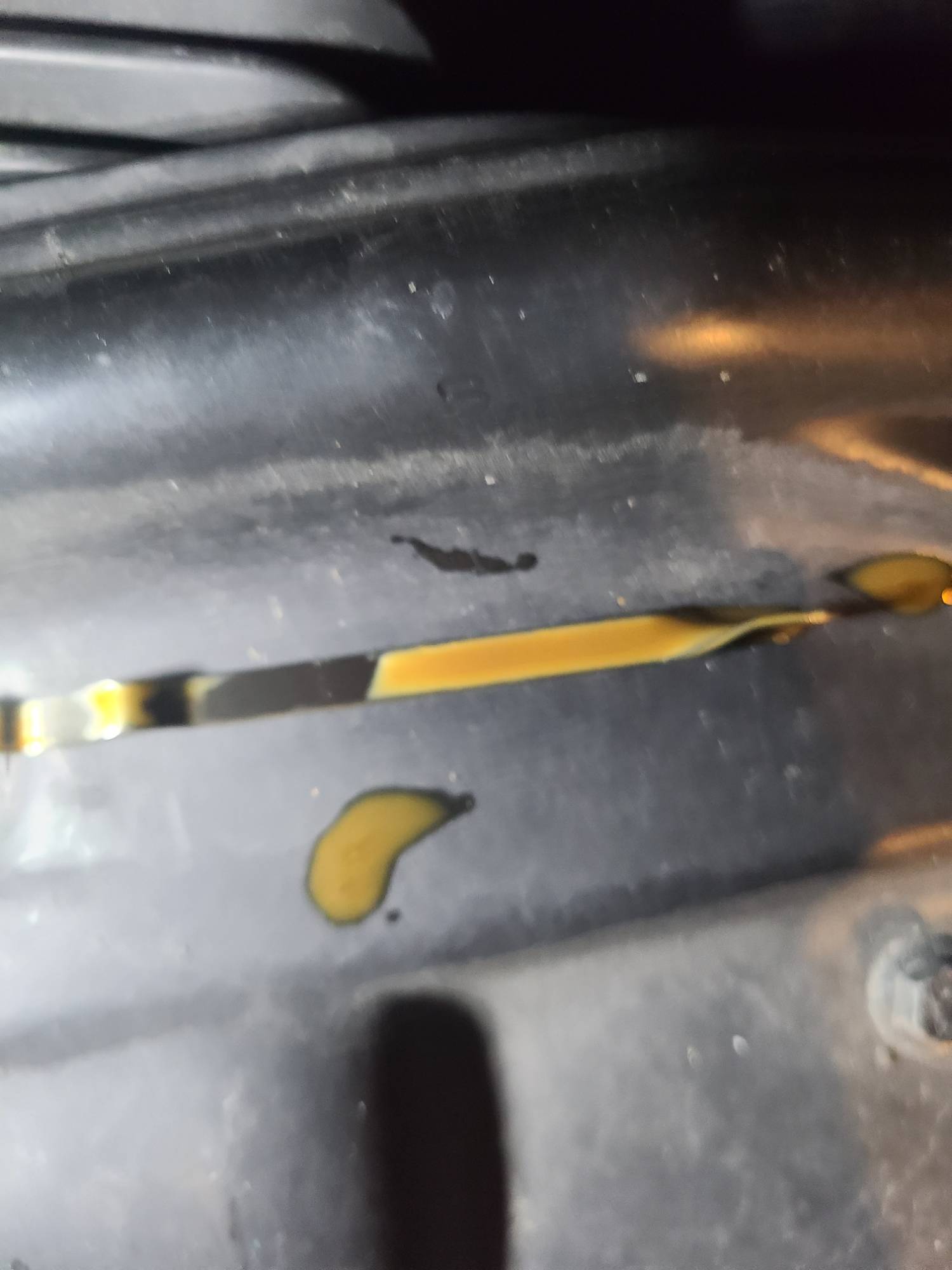

Welp i grabbed my scan tool from work but it was all for nothing, pretty sure the headgaskets toast. I thought my coolant level was looking low but chaulked it up to being absurdly cold.
After scanning the car and seeing it had no codes other than the misfire codes, and noticing that cylinder 2 was now misfiring like 1 and 3 were to a lesser extent, i decided to do a quick compression test. Glad i checked the oil before i did cause i saved myself a lot of time as my oil is brown, milky and the level is higher up than it was a few days ago. This is really disappointing cause i cannot afford this repair. All the symptoms ive been experiencing can also be pointed to low compression, and i think this confirms it was the head and not the rings
- Shes completely toast
- 20221228_192015.jpg (158.17 KiB) Viewed 1271 times

Bad news. I'm sorry, Slipshodcrowd.

Coming back 7 months later re reading this whole situation and laughing at myself, cause after getting the super milky oil and nearly tearing apart my whole engine in my driveways it was just bad coils in the end. A good lesson for anyone who finds this, if you dont know what your doing maybe its best to just take it to a professional.
