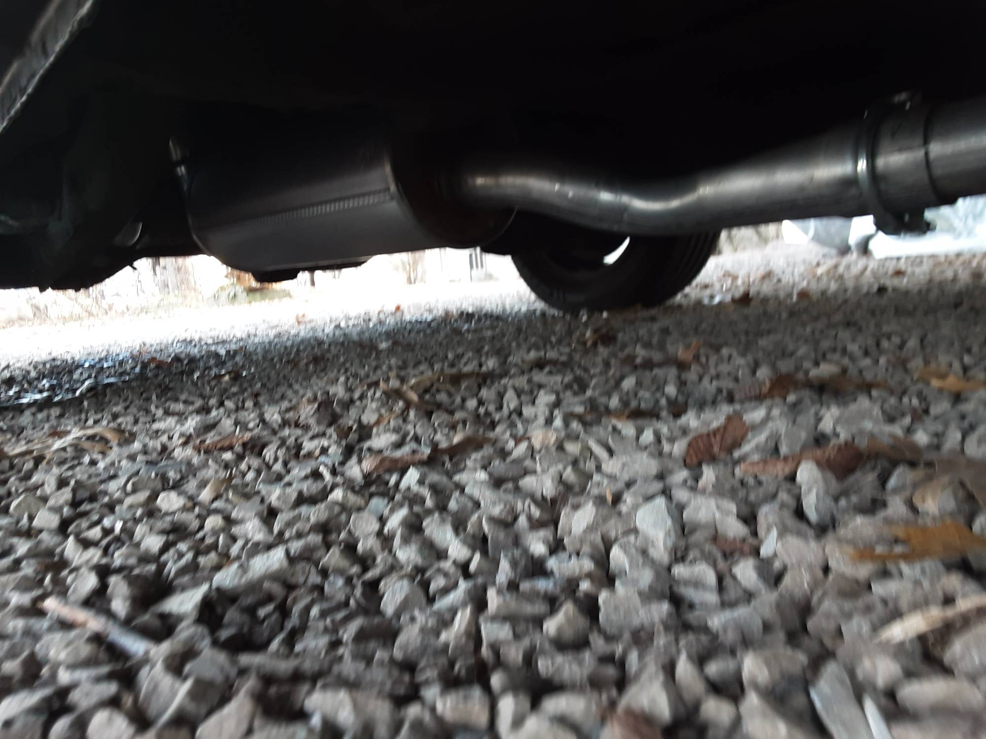

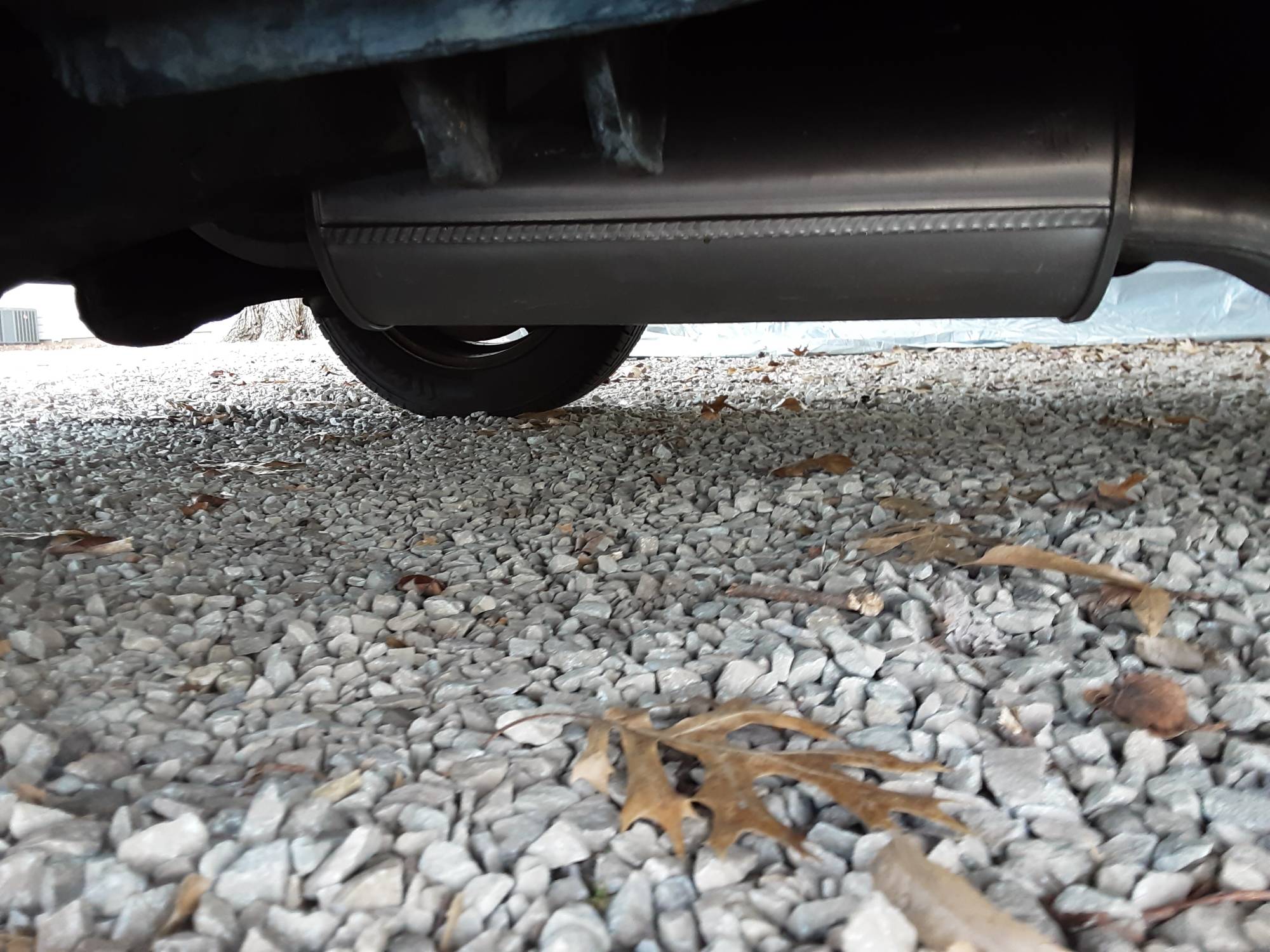

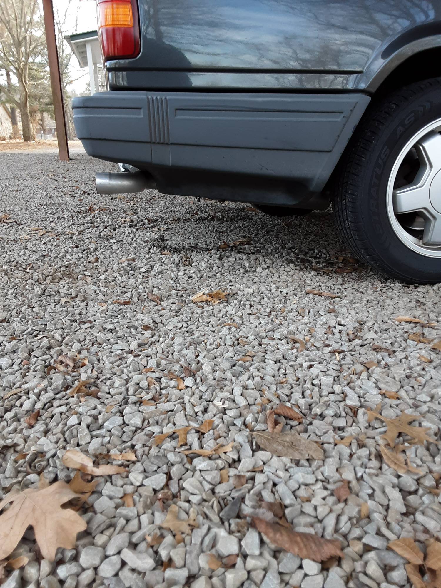

Here aer some photos of the fitment. June
P.S. Ignore my car's ability to defy gravity...

On my 91 740 the oxygen sensor is in the pipe just after the exhaust manifold so it wasn't a issue. The cat is gone now. I would rather it was still there. A direct fit was no longer available for my car either. The muffler shop can weld a (what I believe to be called a bung) for the oxygen sensor on any piece of pipe. I've used my particular exhaust shop a couple of times on this car. As always I tip anyone who works on my cars. So the shop trusted me enough to remove it for a test pipe withoutme asking. Here in Arkansas there is no testing. I understand pretty much 99% of the universal fit cats are junk. At least according to the shop. My reading posts here over the years confirmed it to me. June
