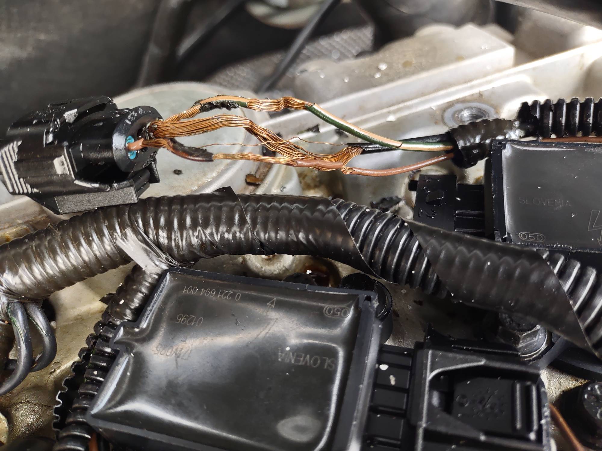

No Zion .. not a miss fire per se.. no codes.. it was just something I found.. I think I'll go down to the junkyard and see if I can pull a coil pack wiring harness assy off of one before they crush it. They crush em 2 fast here in Cincinnati.. if those dumb @$$es only knew how expensive the parts R.. do I give them heck? Yeah, it's my job

if you have no luck finding parts those plugs can be rewired once you see how the pins release.

It's not really the plug end.. I know what you mean though. The oil fill cap leaked and I pulled the cover off.. oil everywhere. I dried up the top of the cylinder head with paper towels, but the wires, wire loom are oil soaked. So I just wonder where the entire harness for the coils plug into.. I'll have to just trace it back and see what's what..

the wires go into the loom, you have to cut and patch in new wire.

I cleaned #4 coil wires with electronics cleaner and wrapped them up individually. I think 1 might have been going to ground on the cylinder head. Mopped up the oil and replaced oil fill cap with a factory one ( says Volvo recommends Castrol) with new gasket. I think the PO used cheap gas or low octane. I put some 94 octane in it from Shell and ran it ! When I changed the oil it smelled a little like gas..
