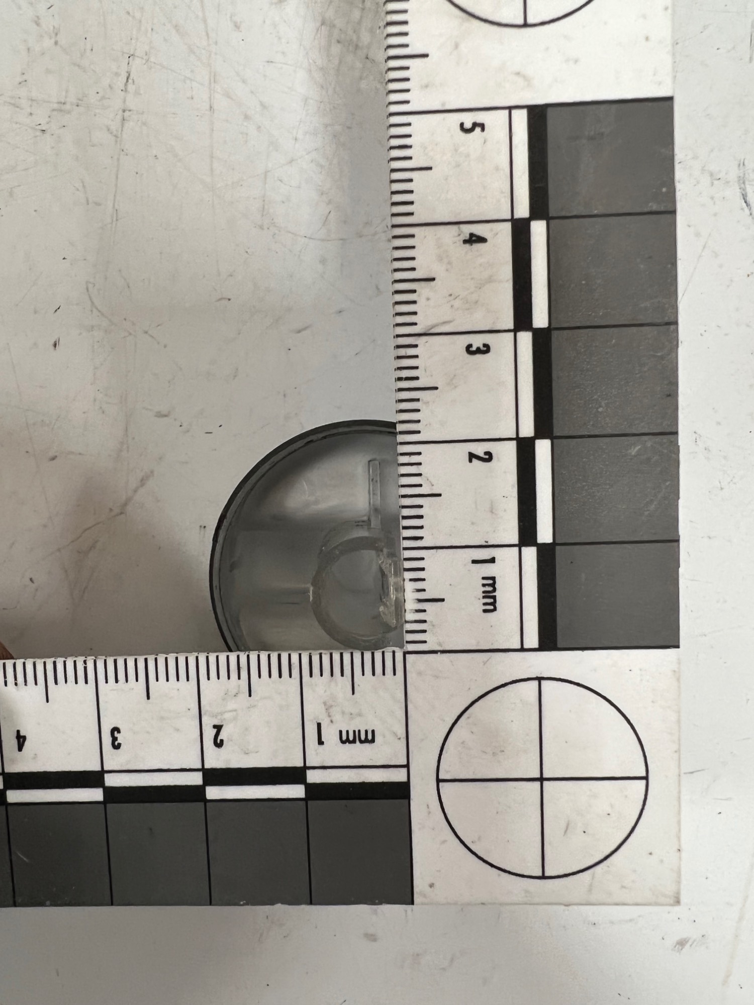

Here are the photos

Got some used Goodyear winters for the v70 on alloys. Looks a lot better and there is a lot more group. Described my issues to the Indy who does not suspect a head gasket issue given the symptoms or lack there of. He advised that a dealer may be useful for a light leak so I’ll keep that in the back of my mind as a plan. He recommended doing a whole engine as opposed to separating the parts as well. We cleaned the distributor cap and rotor as a residue built up and caused burning in the rotor. The car runs better now and feels better with the new tires. Will proceed with doing the fuel rail at some point in the future.
