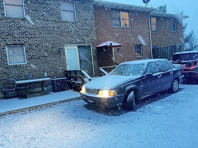

If the car was going to overheat, my guess is it would've by now. I would think a few hours of highway driving with an overcooked engine would be pretty easy to notice... but again, you know more than me. After all, I'm the idiot driving a 300k car with a dozen engine codes as if it were brand new... It's a great little car though:
