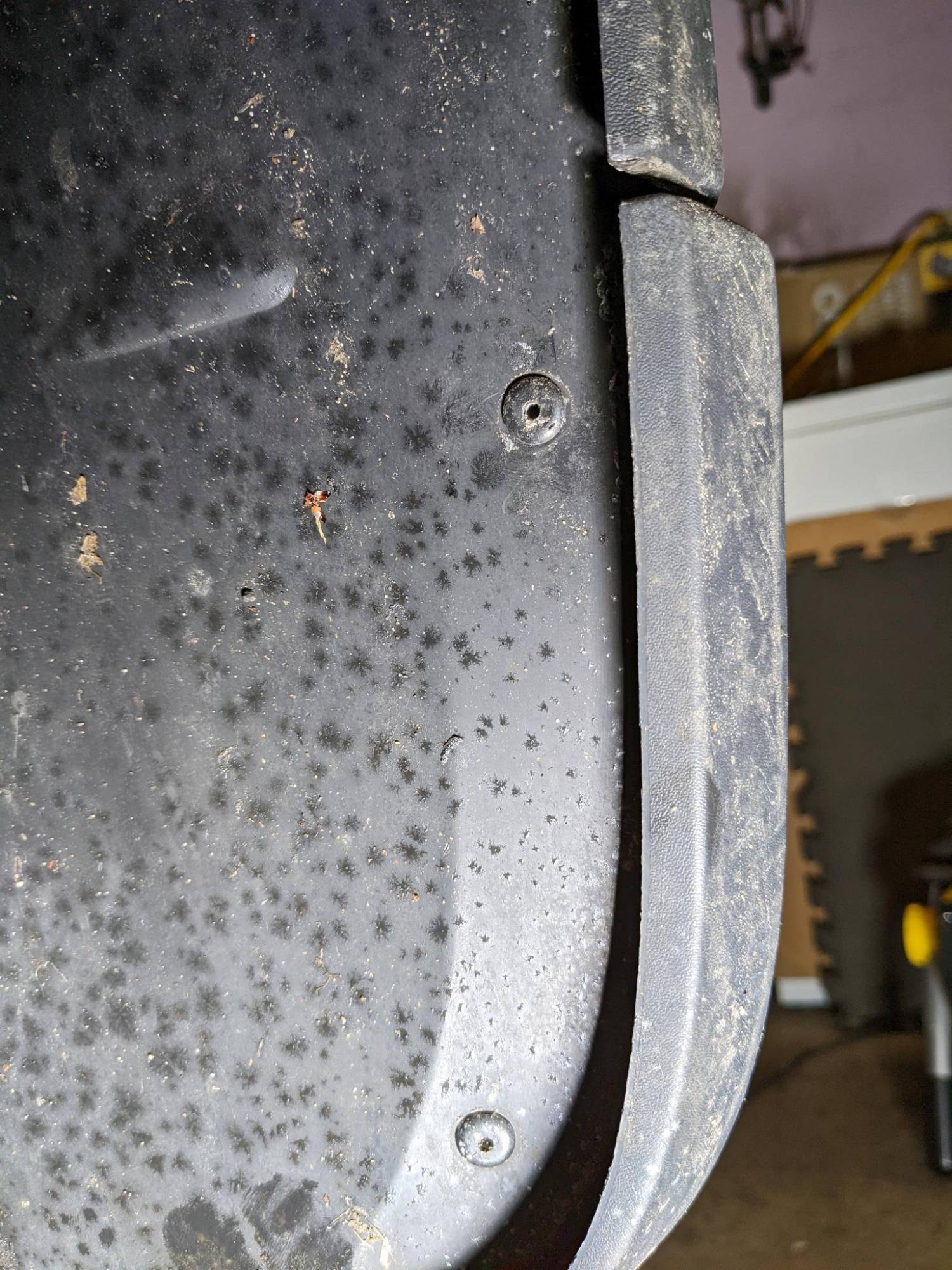

Also, inspecting the wheel well, it's not obvious how to remove the molding. They don't appear to take a torx or other bit. Do these fasteners just snap in and I pry them out?

They are aluminum rivets- you have to drill them out!

Post by nedc »
Then you can replace them with screws, at least that's what I did.

Jacked up and took off right wheel and wheel well liner to get access. Drilled out the wheel well liner rivets, but only about half of them drilled through and the rest spun in place and started eating into the liner, so cut em off with crimps.
