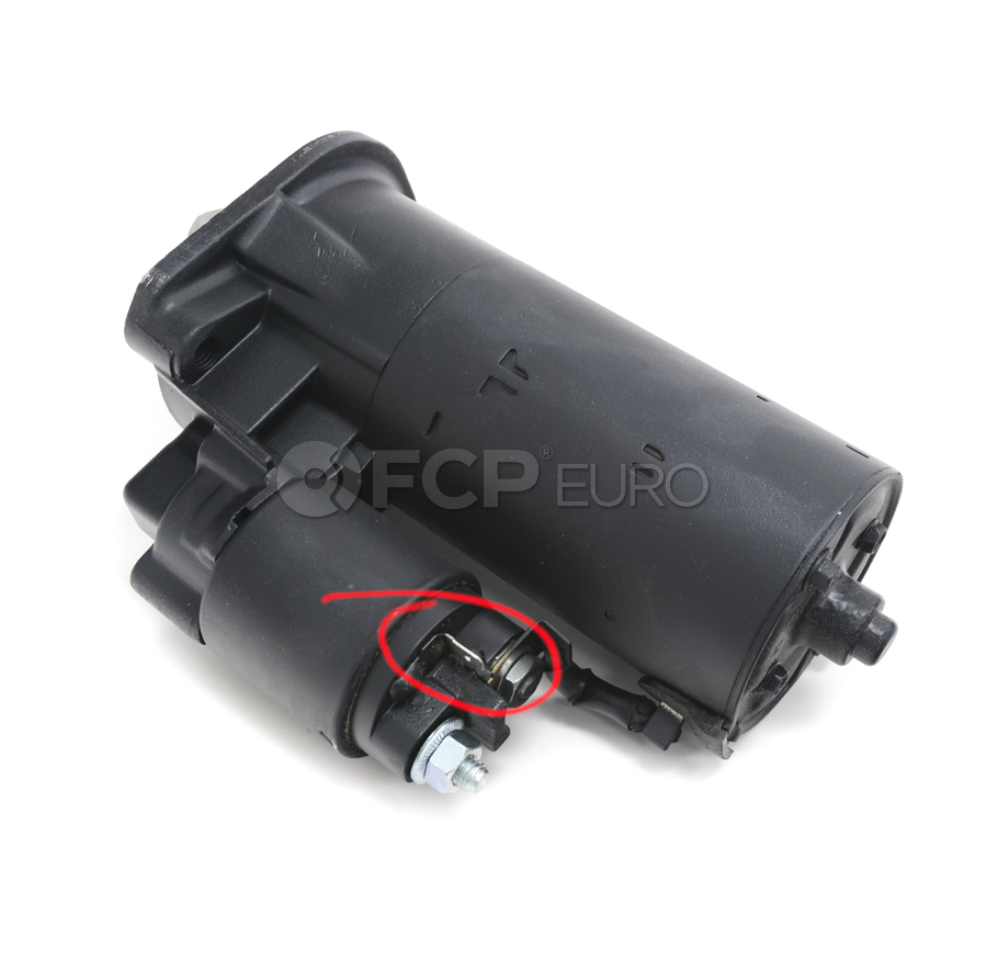

Find a wire that goes to that contact on the starter, take it out, clean thoroughly (scratch with a thin screwdriver, use electric cleaner), put back.

if cleaning the small terminal doesn't work, try jumping between the 2 terminals on the starter, if it cranks over the problem is upstream, I would look at the ign switch. On my older volvo (740) I installed a push button to start the car, volvo ign swittch was too expensive for me.
I used a 12v feed from the battery POS to the small terminal with momentary switch in between and 15 amp inline fuse.
Hokey but it worked fine.

Dave. I think the P2 has the same starter bypass terminal the p80s do. I’ll check mine tomorrow
