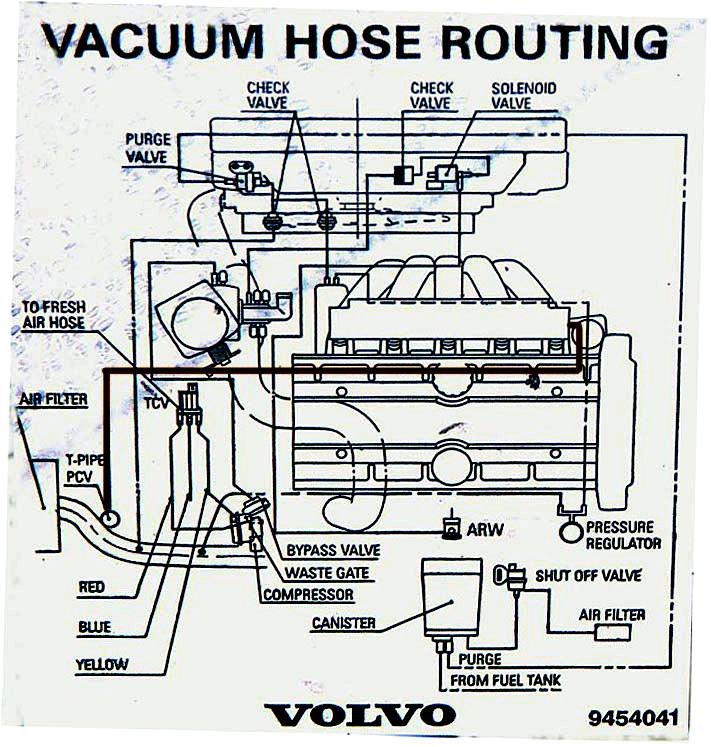

I've been trying to find a good diagram to check all the vacuum lines.

Did you check under the hood? Volvo used to have a sticker on the hood with the vacuum layout.

It is there, but a little small and torn up, thanks for the link!scot850 wrote: 25 Jan 2023, 14:49 Did you check under the hood? Volvo used to have a sticker on the hood with the vacuum layout.

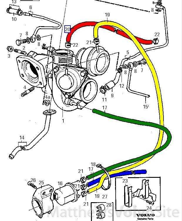

They actually pulled the red/yellow/green/blue line one from MVS... I made (color coded) that probably 17 years agoscot850 wrote: 25 Jan 2023, 14:49 Did you check under the hood? Volvo used to have a sticker on the hood with the vacuum layout.

Note that red in Matt’s diagram doesn’t match the red on the Volvo diagram. Mark them with tape on your car before you pull them off

You made that?! Funny, I used that, I have it printed in color in some folder somewhere! I even used colored hoses! (Makes it so much easier to see where you’re going)matthew1 wrote: 25 Jan 2023, 17:04 They actually pulled the red/yellow/green/blue line one from MVS... I made (color coded) that probably 17 years ago![]()
JayPea - I also followed advice to tape and mark hoses first. It’s dark and hard to see and covered with grime back there.
