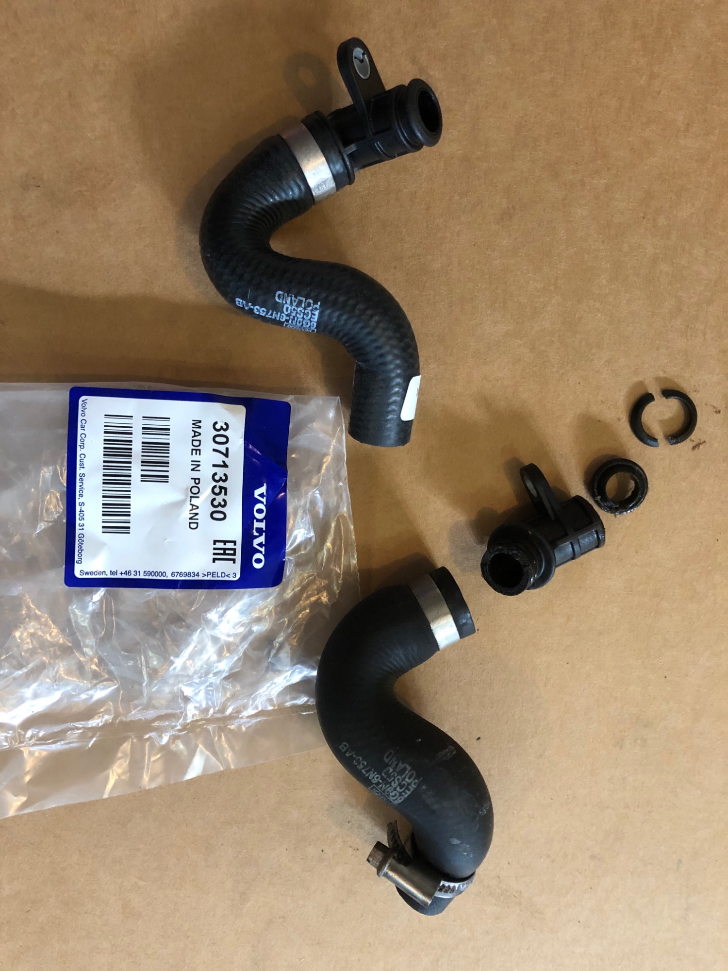

Replaced one of the coolant hoses on my father’s 2008 XC70. He just said he got a “Low Coolant” light. The plastic nipple had basically disintegrated. Mileage is around 102k - just replaced the thermostat (broken tab, stuck open) recently. Reminder to do all these things at once!
