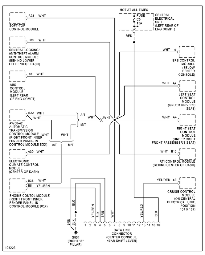

Hello again,
Ok back to the OBDII wire gauge for this car.
I found this image posted by RickHaleParker some time back around 2019.
It shows the #16 wire, which is the +12v wire, going back to the fuse labeled as "C5". I looked at my fuse layout on my car and it says it is just "5" but it also says "Diagnos" which i assume is short for "Diagnostics".
The really interesting part though is that the fuse is rated for 15 amps. That suggests that the wire gauge should be #16 AWG or better, like #14. I will check into this further but that sounds right. That would mean the #16 pin could, in theory, handle at least 10 amps.
That's surprising to me because i was thinking it might be #22 AWG because it's only for signal transmission and a little power for OBDII meters, but maybe Volvo was smart enough to oversize the wire for better durability.
Diagram follows...
Diagram follows...
