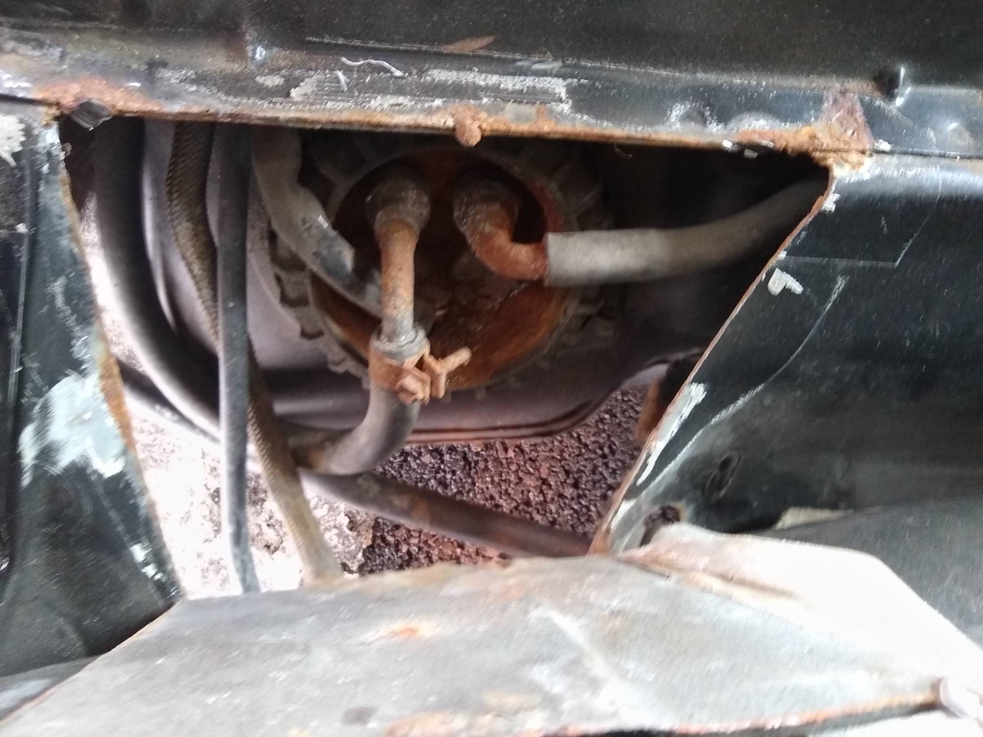

Also note that there are instructions out on the interwebs for cutting a hole under the front of the rear seat foot area to get to the pump. My car "came" with this mod as I was at least the 2nd owner. Would suggest tack welding it back afterwards or you'll get it moving around.
- Posts: 36148
Remember if you go the cut metal route, you have to cut and splice the wires. They are clamped above the fuel tank and won’t release enough slack for fuel pump removal
