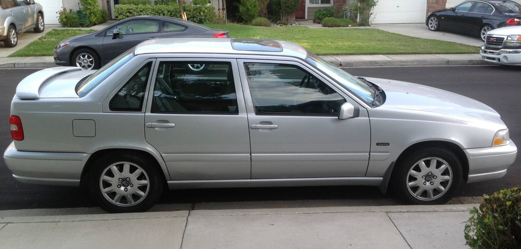

Had Gabriel's on a 98 S70 T5 but with 01 V70 15" wheels. Gabriel shocks were in the back also. Gave the car a very smooth ride. Have front KONI SRT.T on the 08 C30 T5 2.0 (later became R-Design) which has the factory sports springs vs standard springs on all other C30's. Have Bilstein's for the rear, not the best. Best struts thus far compared to all the other brands on a variety of cars over the years.
