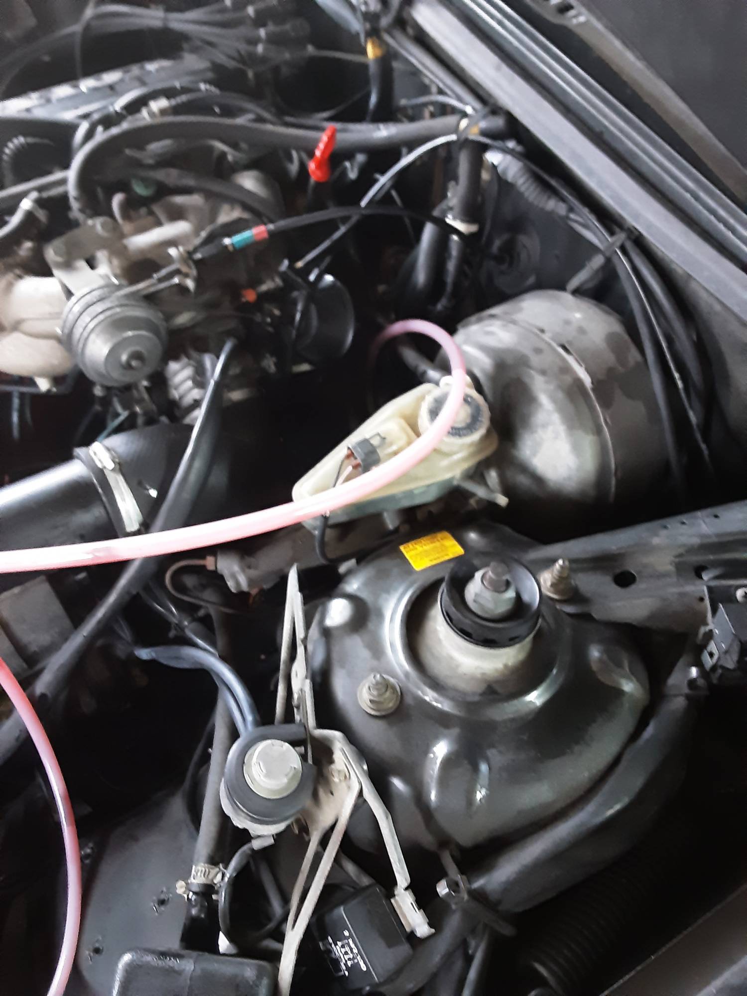

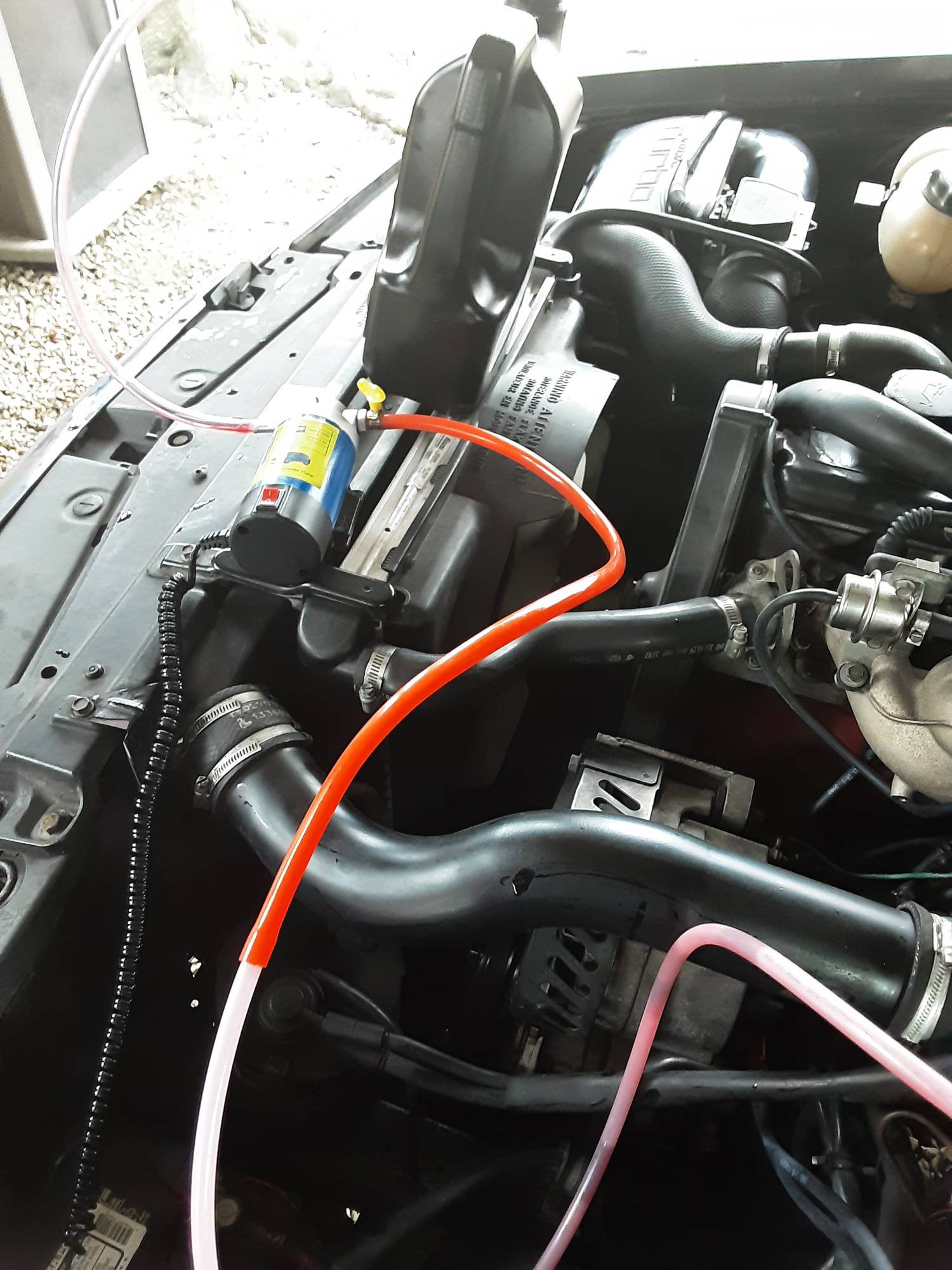

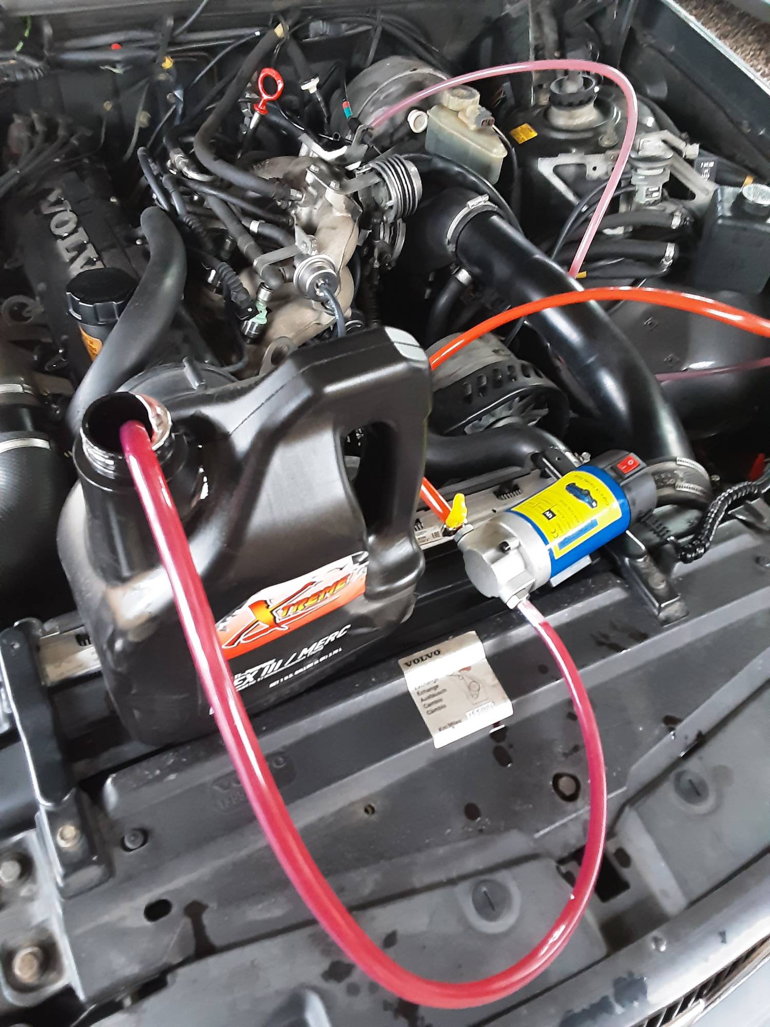

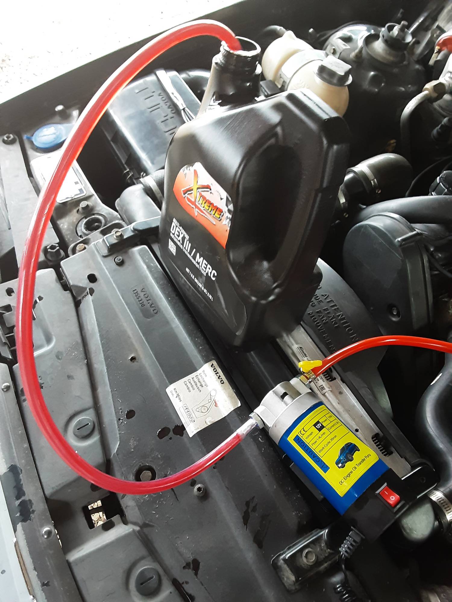

I ordered off of Amazon a oil exchange pump. 3.5 quarts came out initially. I replaced it three times with 6 quarts with a quick drive in-between. It worked well. The original fluid looked good when checked, but looks dark in the gallon collection container. The second time also was dark, but cleaner. The third and fourth time made a noticeable change in transmission operation.
I am aware the 740 has a drain plug. That would have been much less convenient. By using the dip stick tube, nothing has to be loosened. Therefore no worries about leaking parts, or damaging anything. June

Thank you Abscate! My worry about Gibbons method came from a post on here awhile back. The member didn't get something about the fittings back on the radiator correctly and the line popped off during operation. This resulted in a burned out transmission. As memory serves some sort of clip problem. Using the electric pump nothing has been loosened, therefore no worries of leaks or line popping off later or even a broken nail lol!abscate wrote: 25 Feb 2023, 01:36 I see the convenience factor of using an external pump as a plus rather than dashing back and forth for the key, but I usually have another warm body home with us at school without a paycheck for a year.
Anything less than awesome for June DIY isn’t fitting enough.
We did the Gibbons method ( hose popped off cooler) on a 99 XC and found there was a standard size PVC hardware store size that tight fit on the ATF hose. We didn’t even clamp it.
I initially tried getting to the drain plug, but I have issue getting my top half under the middle of the car on ramps. I can't reach it... so I had to think outside the box. As it turned out it was quick and simple. The pump cost me $55 on Amazon. Another couple of bucks for the 8 foot hose used in the dipstick tube. The 740 has a long tube. A FWD car tube would be closer to the front of the car.
I drove the car a couple hundred miles yesterday and the car's transmission is quite happy. Although it seemed perfect beforehand, there is a difference (improvement) in shift quality. Also the car seems smoother accelerating in third gear. June
