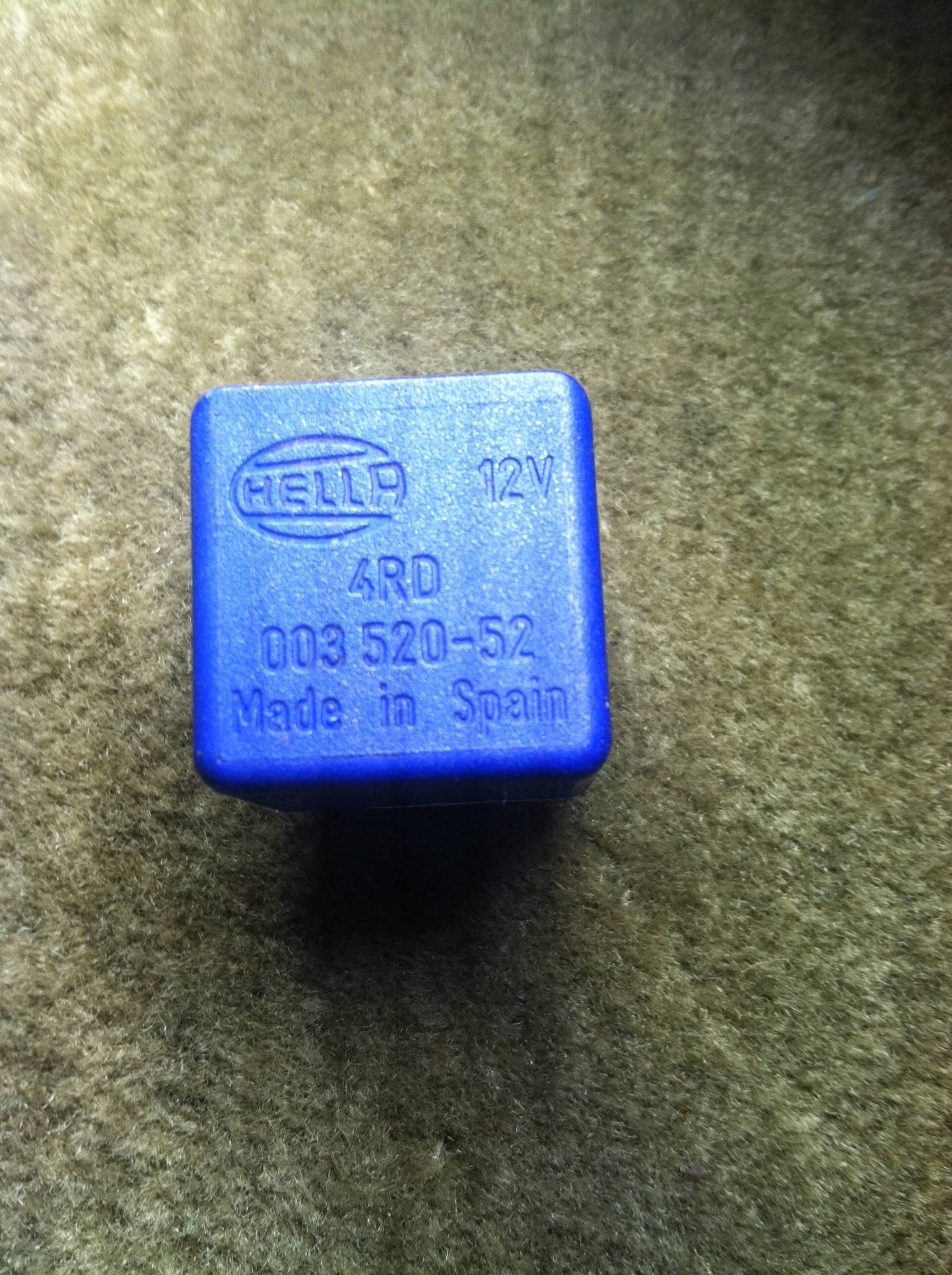

Just to update all new parts are in, timing belt kit, hoses, plugs, wires etc. etc. New blower motor and resistor, assorted bulbs, switches, fluids and shift cable bushings done. Car is stage 0 at this point. AC seems a bit weak so going to chase that down. I have MCC which relay behind the glovebox is for the AC compressor? They are both green which may or not be correct. Looking for some insight. Thanks.

Mine is blue (MCC, but mine is an automatic)
ipd shows a green one under a new part number; I would imagine the same relay is used elsewhere
Discussed before:
viewtopic.php?t=29563
Since it's kind of a pita to get to, I would lean towards a brand name relay - and as usual, avoid anything URO.
