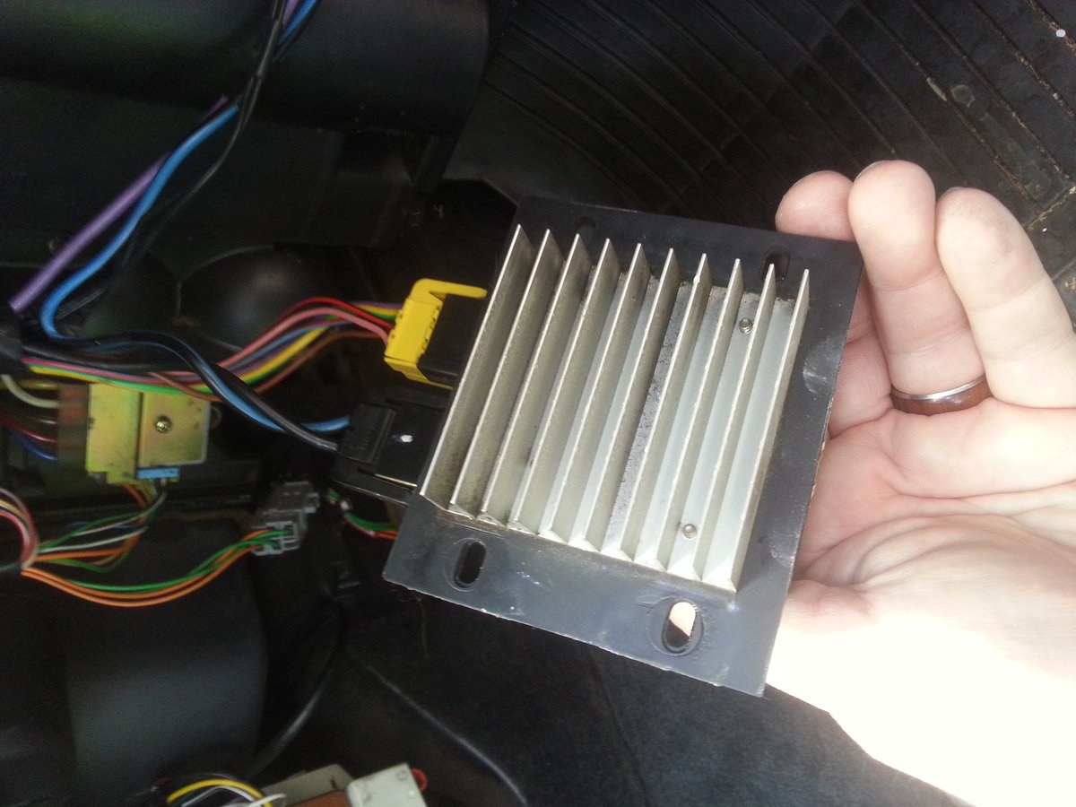

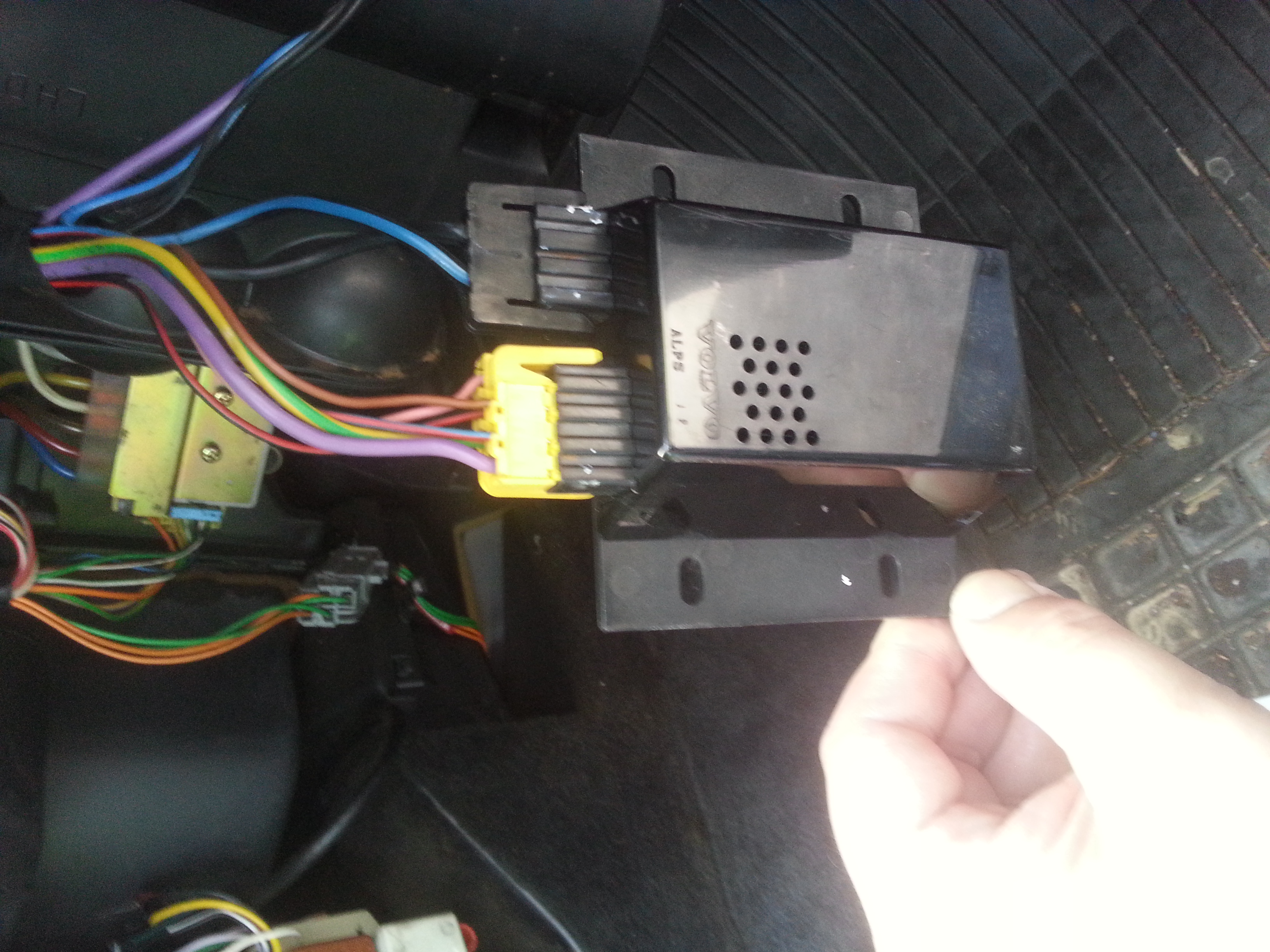

1988 760 B230FT with ECC....A/C light flashes on whenever I try to use the blower...Code I pulled is 233 (Too much starting current for blower etc)...Pulled the blower...Was original so replaced it with new. Verified it works, but would still only move less than an inch before the A/C light flashed back on.

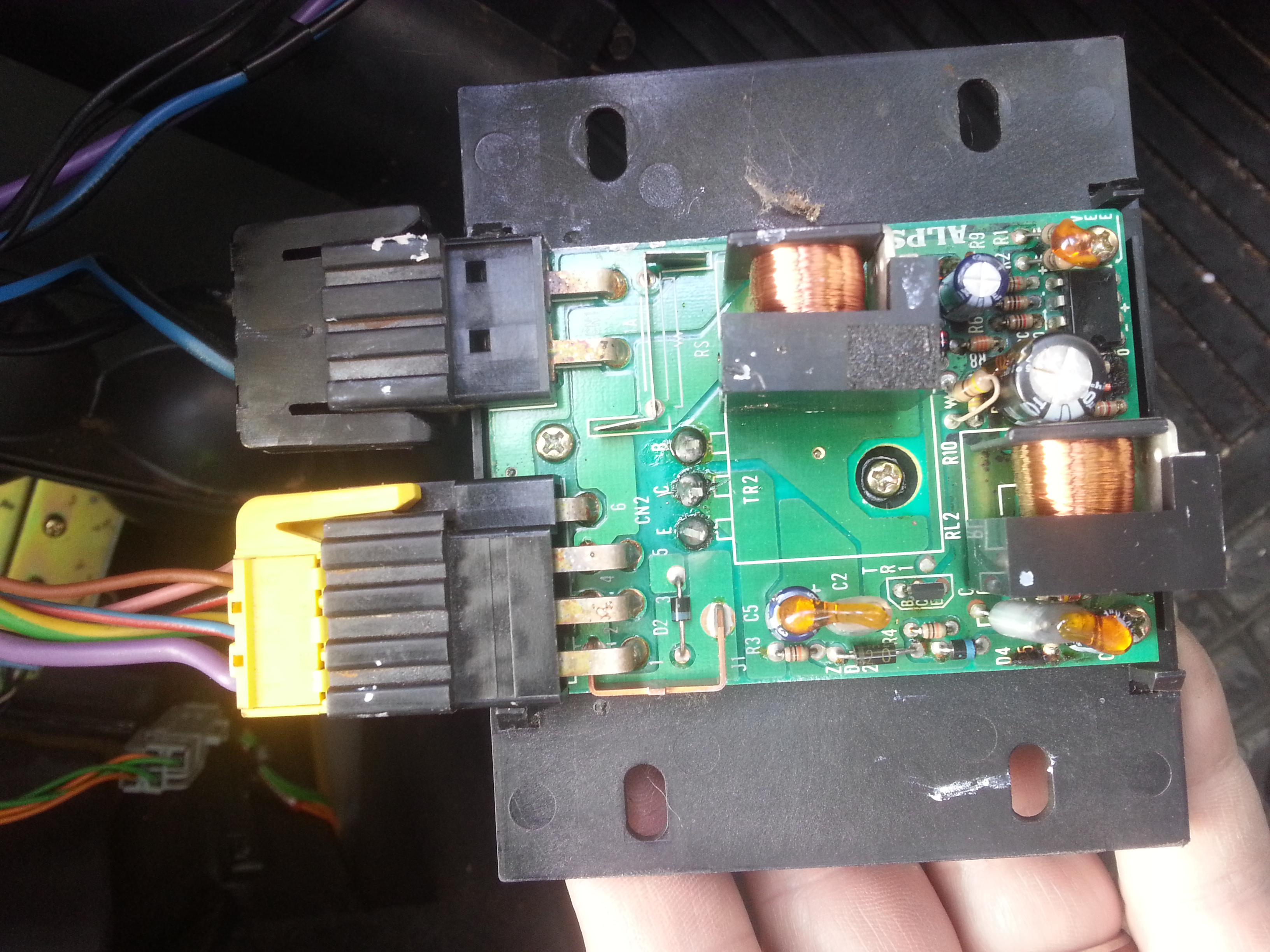

Pulled the Power Stage/Resistor and Replaced the transistor inside...Still not turning the blower.
Any other Ideas? ECC unit itself or bad Power stage?

Hi! I have the exact same issue with my 1988 760.
Code 233 with the electronic climate control.
I too changed the blower motor which did not fix the issue.
So here’s what I’ve learned so far: Volvo has a few different varieties of climate control, but broadly they fall into two categories: ACC (Which uses vacuum circuits and a resistor to control louvres and the blower motor) and ECC (the smart system which senses temperature and adjusts accordingly).
Telling them apart: ECC has an “auto” function and you choose a temperature rather than a selection between hot and cold. ECC is found in the luxury editions of our beloved bricks: the 760, 940 SE, and 960.
Compatibility: head units (the piece with the dials and buttons) are comparable at least from 88-95. I swapped my 88 760 head for a 95 960 head unit and it works just the same.
The blower motor: many people have had issues with the blower motor not working, but it’s not always the blower motor. Error code 233: blower motor starting current too high. This is analogous to the resistor, except it allows the computer to control the fan instead of a switch. It’s basically a fan power stage. It costs a LOT of money if you can find it.
I am going to look into repairing mine. A friend sold me one from a junket and it works in mine, but seems to have a differentt plastic housing, so I’ll have to fix mine. I will update here if I get to it.
Questions: do other cars have fan power stages that could potentially be swapped in? Even if it’s not a perfect fit...
