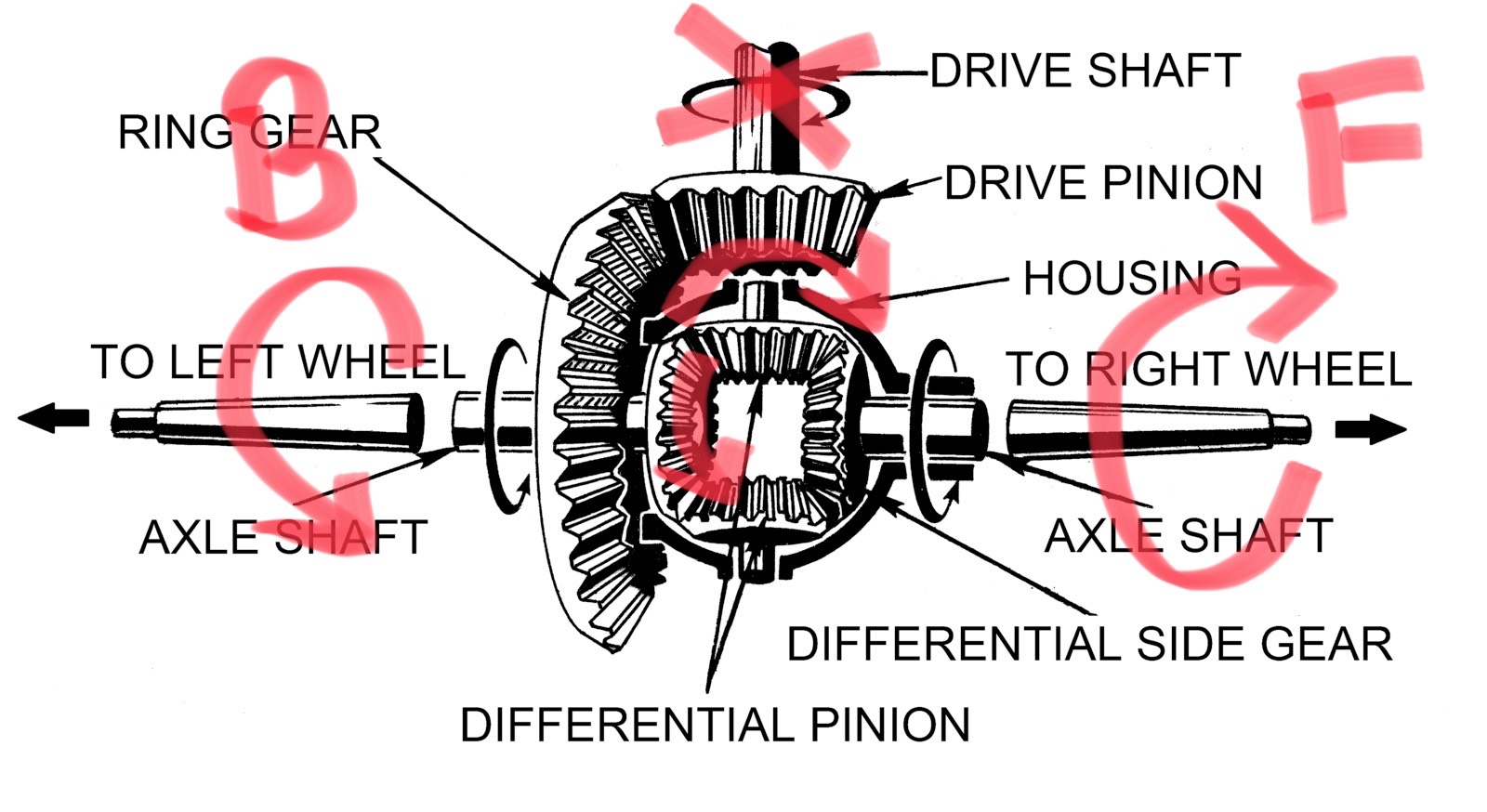

Above, indeed if you turn a front wheel on a car with both up in the air, the other wheel will rotate on the opposite direction. This is a result of the differential gears.
With the car in park , the drive pinion is frozen, denoted by X
The differential pinion reverses the rotation of the axle shaft to the other wheel as shown here
