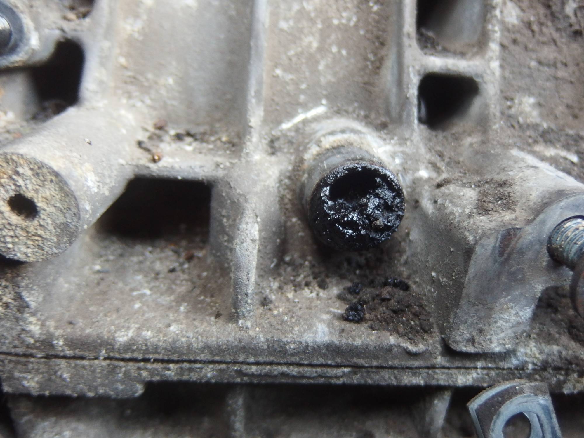

Hello,
just working on PCV that is fully clogged and I am not sure how to clean out the mess from engine PCV ports. Is it necessary to remove the oil pan to clen it from the inside?
Thanks for any experiences and advices :)

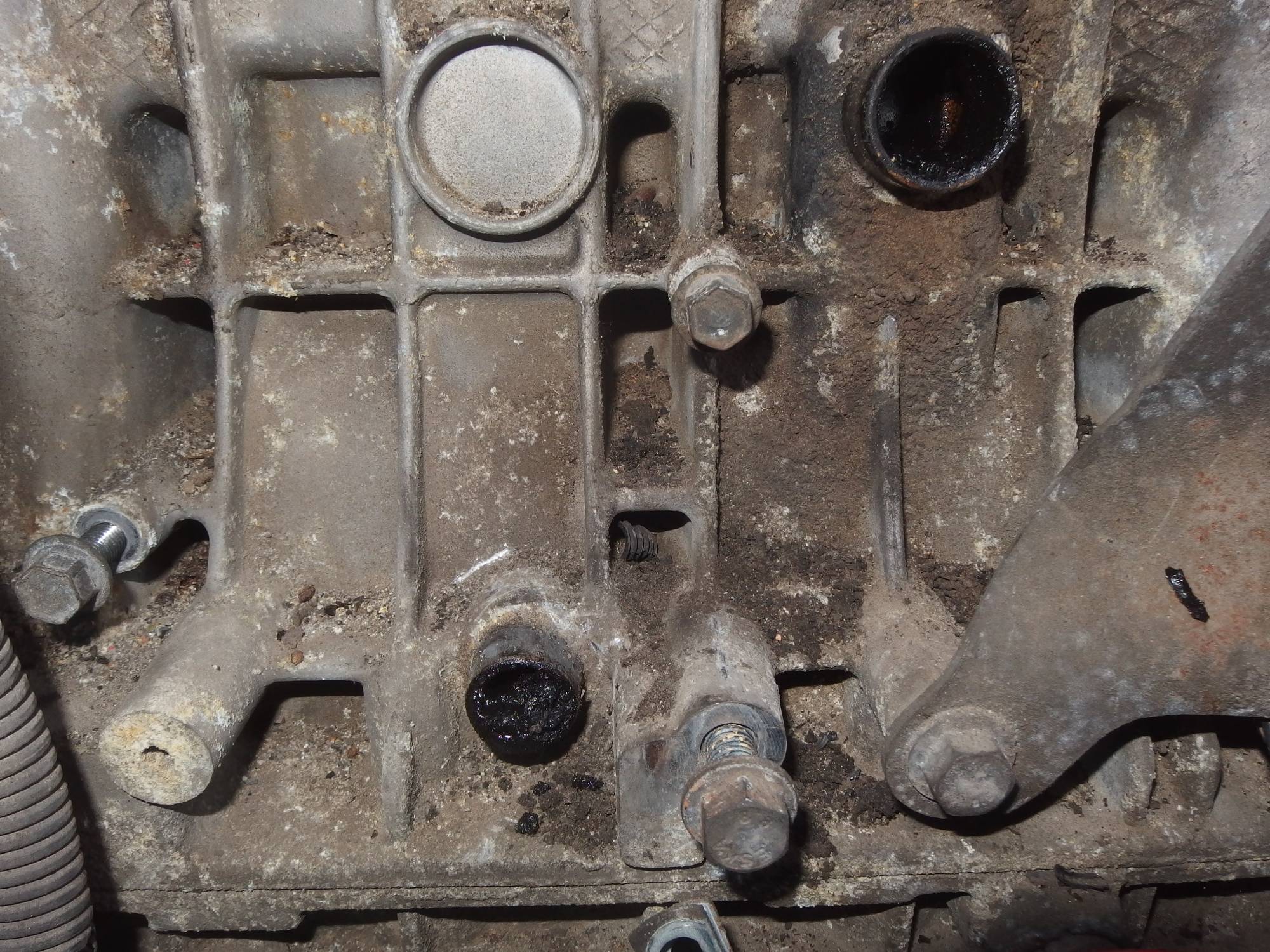

That looks like a lot of build up compared with what I found on my '97 855 on its first PCV job done in Dec 2022 at ~240k miles.
To clean mine out, I used Robert Spinner's suggestion of a drywall screw to pull the debris out of the hole. You can see the debris that was removed just below the hole:
Lower hole
Lower hole

Once you clear that out, the drain turns 90 degrees down into the oil pan maybe 3-4cm in from the front. Try a piece of wire or a thick zip-tie and see if you can get it around the corner and down to the oil pan. If you can't you may have to remove the oil pan to clear it from below if a piece of stout wire can't clear it. While that would be a pain, at least you would have the bonus of being able to replace the oil pan 'O' rings while in there.

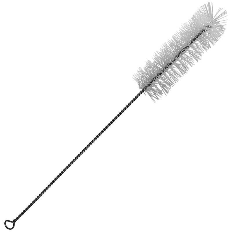

Yes, good idea. I will try the silicone brush like this:
This can´t leave bristles or scratch something.

Kokonradus wrote: 27 Mar 2023, 01:44 Yes, good idea. I will try the silicone brush like this:
