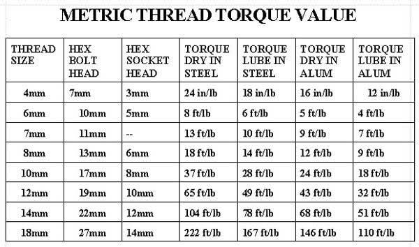

Hi guys.
Someone who can help me with this problem?
P3 angle gear / transfer case cover torque?
- pgill
- Posts: 813
- Joined: 27 Aug 2018, 17:42
- Year and Model: 2010 S80, 2008 LR2
- Location: California
- Has thanked: 120 times
- Been thanked: 189 times
I think those are M8 but they might be M10 (i.e. 8 millimeter diameter for the thread is M8)
Here is what I would torque to. (I would use the lubricated Aluminum and retorque after 24 hours to the same setting)
Good luck
Paul
Good luck
Paul
