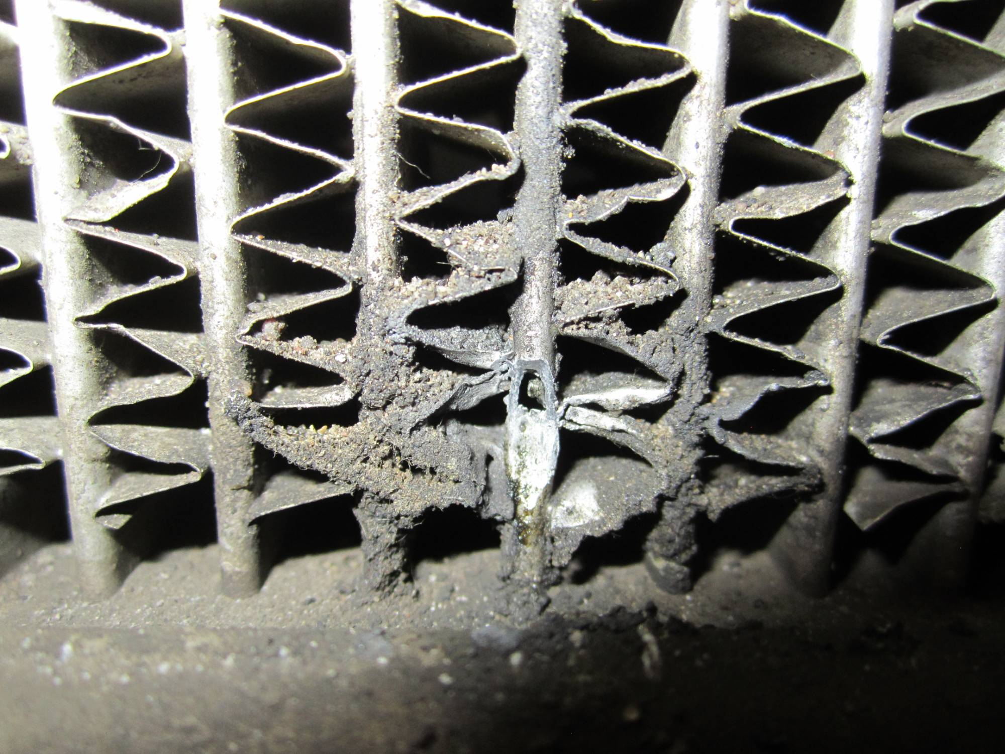

I'm sure you may be able to. JB Weld have metal menders too, but remember the unit is under some pressure. What the guys did on mine was silver solder it if I recall.
What happened with mine was the 2 end mounts had come detached from the intercooler and allowed it to move between the radiator and A/C condenser. It managed to rub a small hole in the aluminum. There is a drain hole in the base of the intercooler so another small hole may not be too big an issue. Below you can see the small hole I had.
The bonus was I had the radiator guys clean the intercooler inside and out to remove any oil build up from the turbo.
