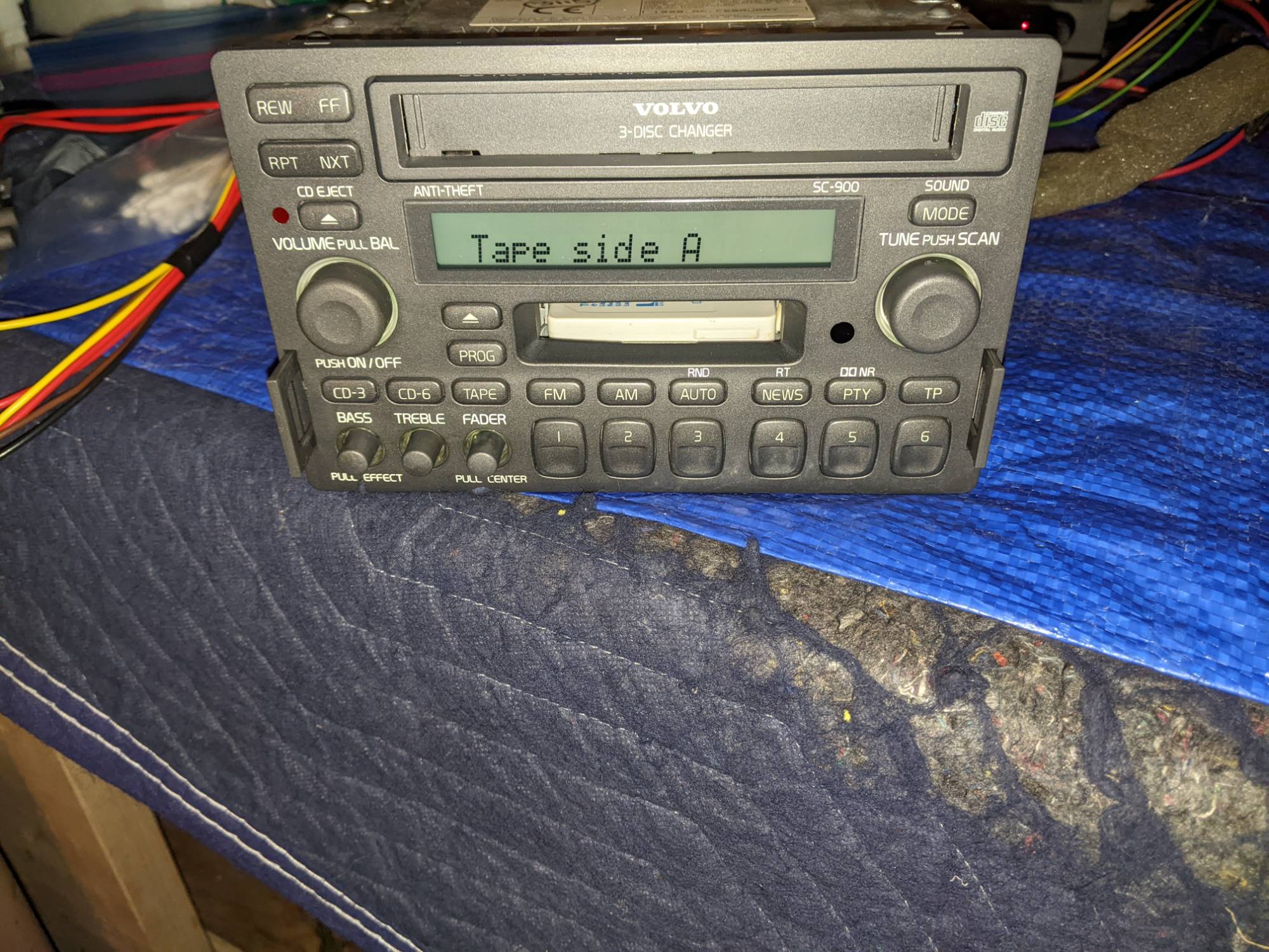

On completion of swapping the CD changer over from buddies scrapped unit with faulty cassette drive. CD changer condition unknown at this point!
Initial testing
Initial testing
Above testing that the tape and CD units were functioning prior to cleaning the CD laser and cassette drive and head. Wanted to make sure the main items were working as well as all the front panel bulbs. These are a pain on these units as they are all soldered in as is the front panel. Fortunately all are working. I will de-solder the front panel from the other unit and keep as a spare as well as the other circuit board. The front PCB is held in place by 3? metal lock tabs. One on the left side near the on/of knob, and 2 on the RHS above and below the tuning know. These 2 are soldered in place.
