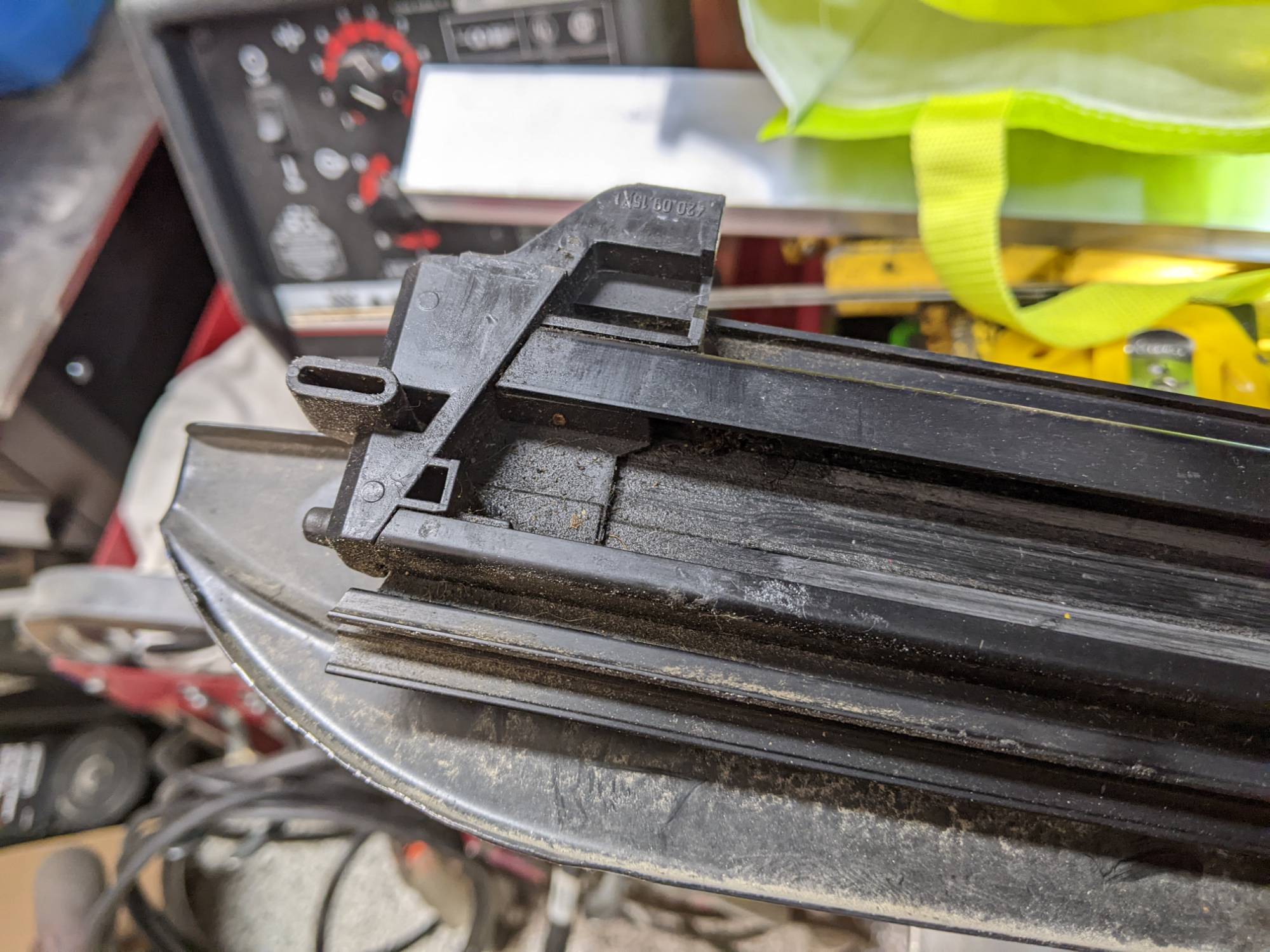

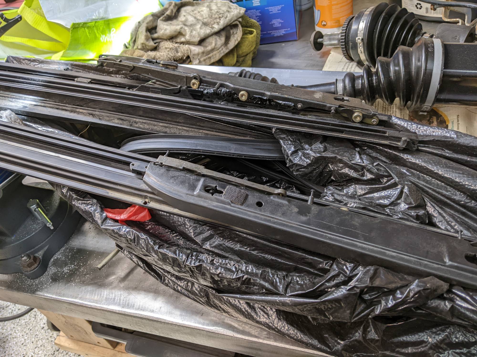

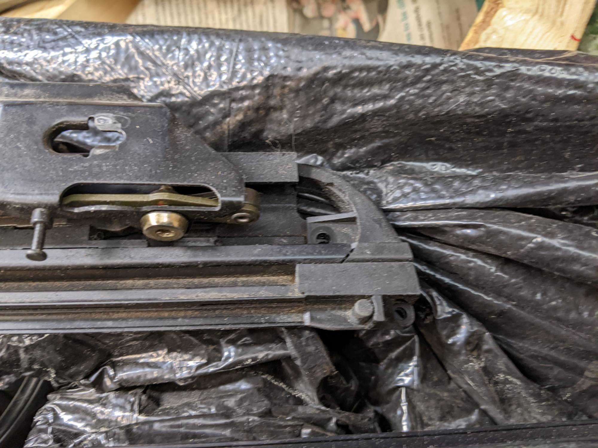

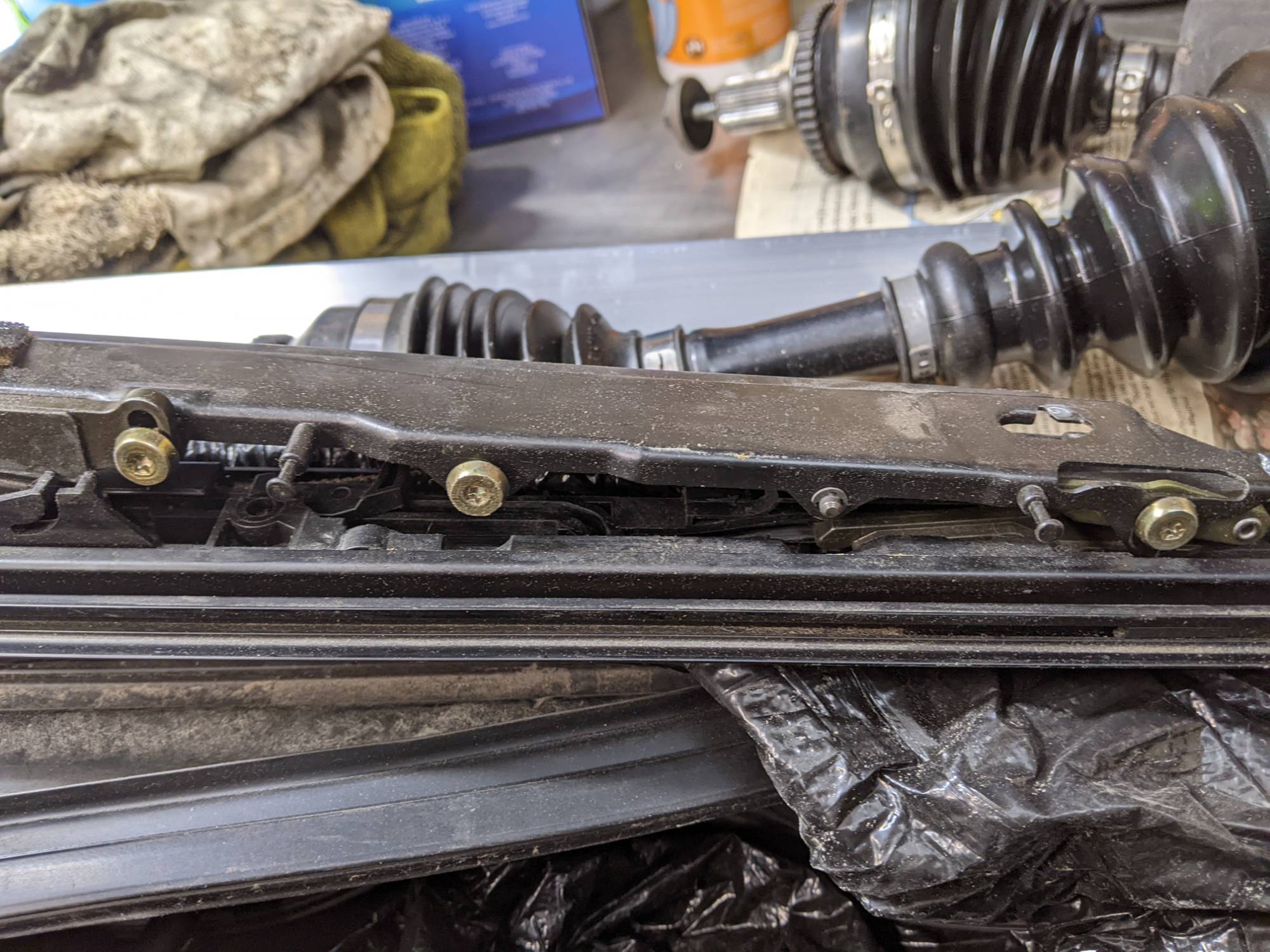

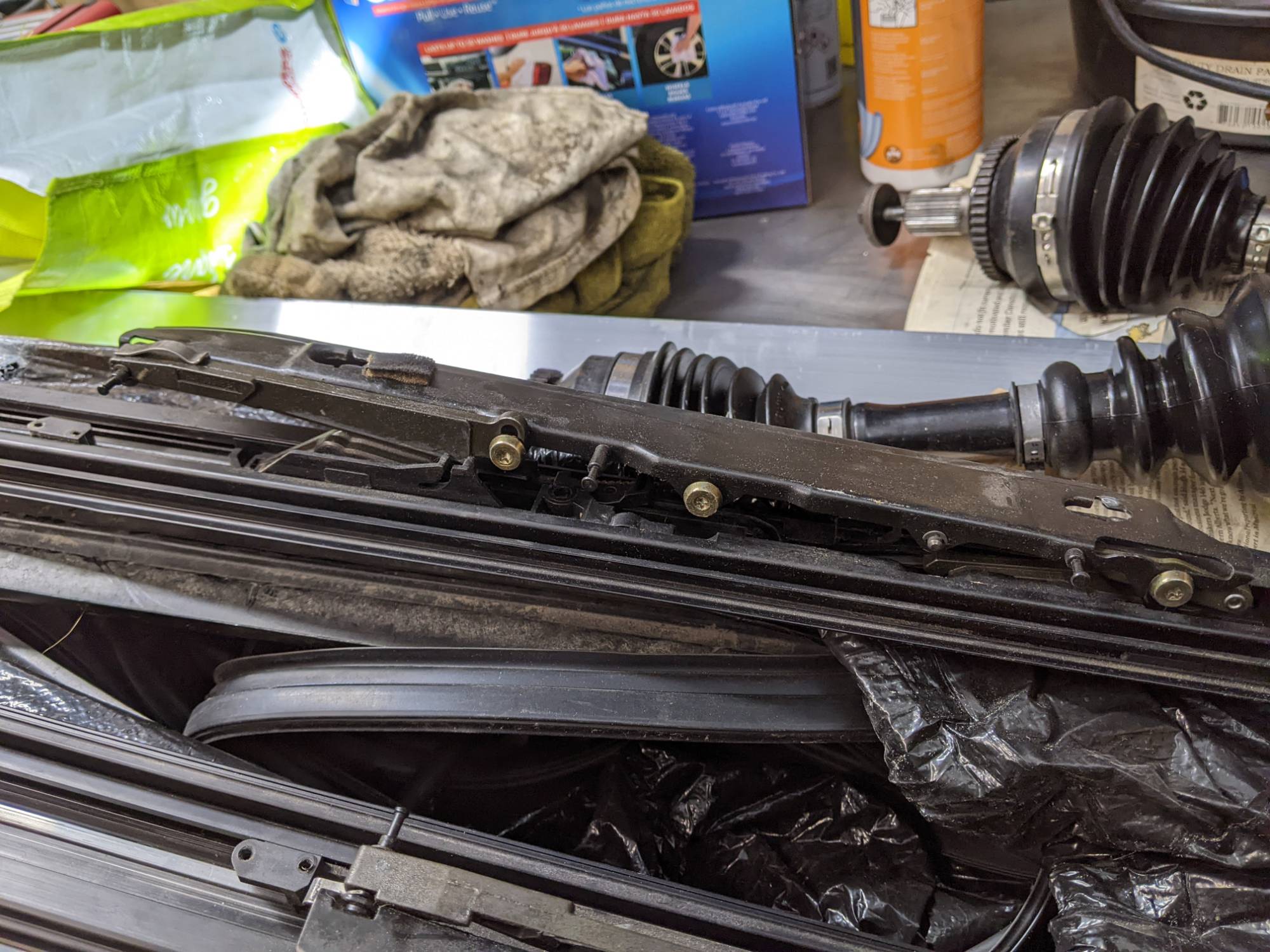

Post by scot850 »
Here are pictures for Sveedy hopefully showing the sunroof guides. Sorry, not the best pictures but I am working with a different computer that has just been updated to Win11. Uploading pictures is still being figured out!
The most important details are the last 3 pictures.
Sunroof Guide (1)
Sunroof Guide (1)
Sunroof guide (2)
Sunroof guide (2)
Sunroof guide (3)
Sunroof guide (3)
In the above picture and the one below you can see 3 Torx screws and a 'C' clip. From what I can see that may just remove the top section, but I believe from what I recall from Sveedy's pictures of what has broken, it it below that, that needs to be removed. If that is the case, then you have to remove the whole unit to access as you need to remove the end cap at one or the other end. You also have to find a way to disconnect the cable that runs between both sides.
Sunroof guide (4)
Sunroof guide (4)
Sunroof guide (4)
Sunroof guide (4)
You can see the end cap in the picture above. The other end is similar.
If you need any more detailed pictures, let me know.

Thanks very much, Neil !
I see another trip to the junkyard, er laboratory, again in my near future.
