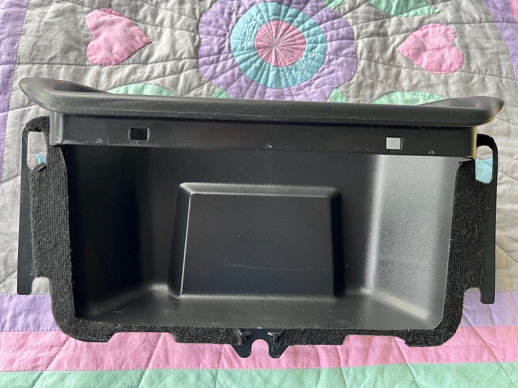

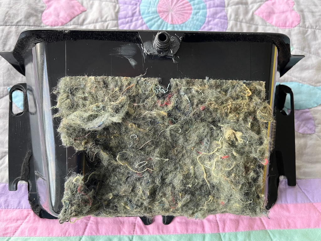

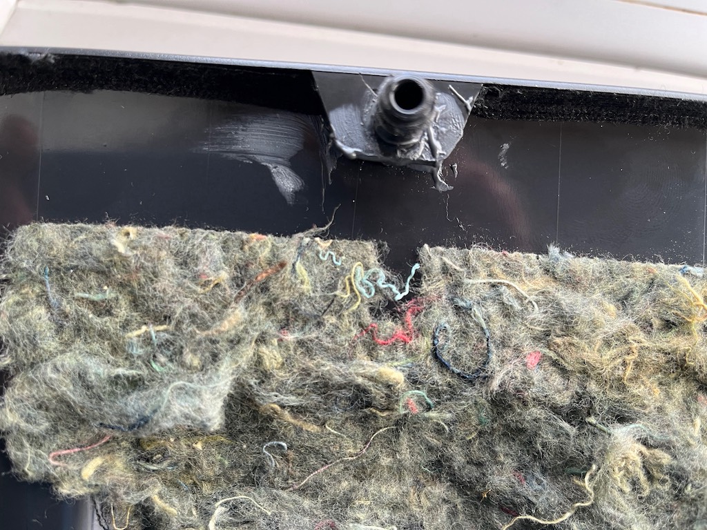

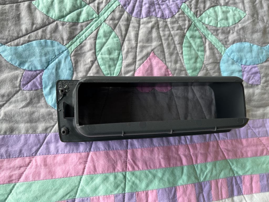

On Tuesday when I was out in the 850 there was a terrible rattle coming from somewhere on the passenger side, it wasn't there last year before I tucked the car away for the winter but I had noticed it a few times this year and it was getting worse so I decided to investigate.
Pressing different parts of the door card gave various noises and my initial thought was the door bin or the interior handle as most of the noise seemed to be coming from around these areas. I removed the door card and dismantled it. The door bin top fixing was broken so I used epoxy glue to reattached it, I then used Tesa tape to cover all the surfaces that would come in contact when I put it back together.
My attention then turned to the interior door handle, all the fixings for the recess cover were snapped off and I carefully epoxied them back into place, however the handle mechanism itself was held in by one bolt and the others were hanging loose so I tightened them, no doubt this was the cause of the broken pins.
Next day when putting the recess cover back on the fixings all snapped off so I need to get new recess covers. I temporarily put it all back together and the recess cover is just placed in.
Went for a drive and I'm pleased to say the 850 is quiet as a mouse inside now, no squeaks, no rattles, it's wonderful.
