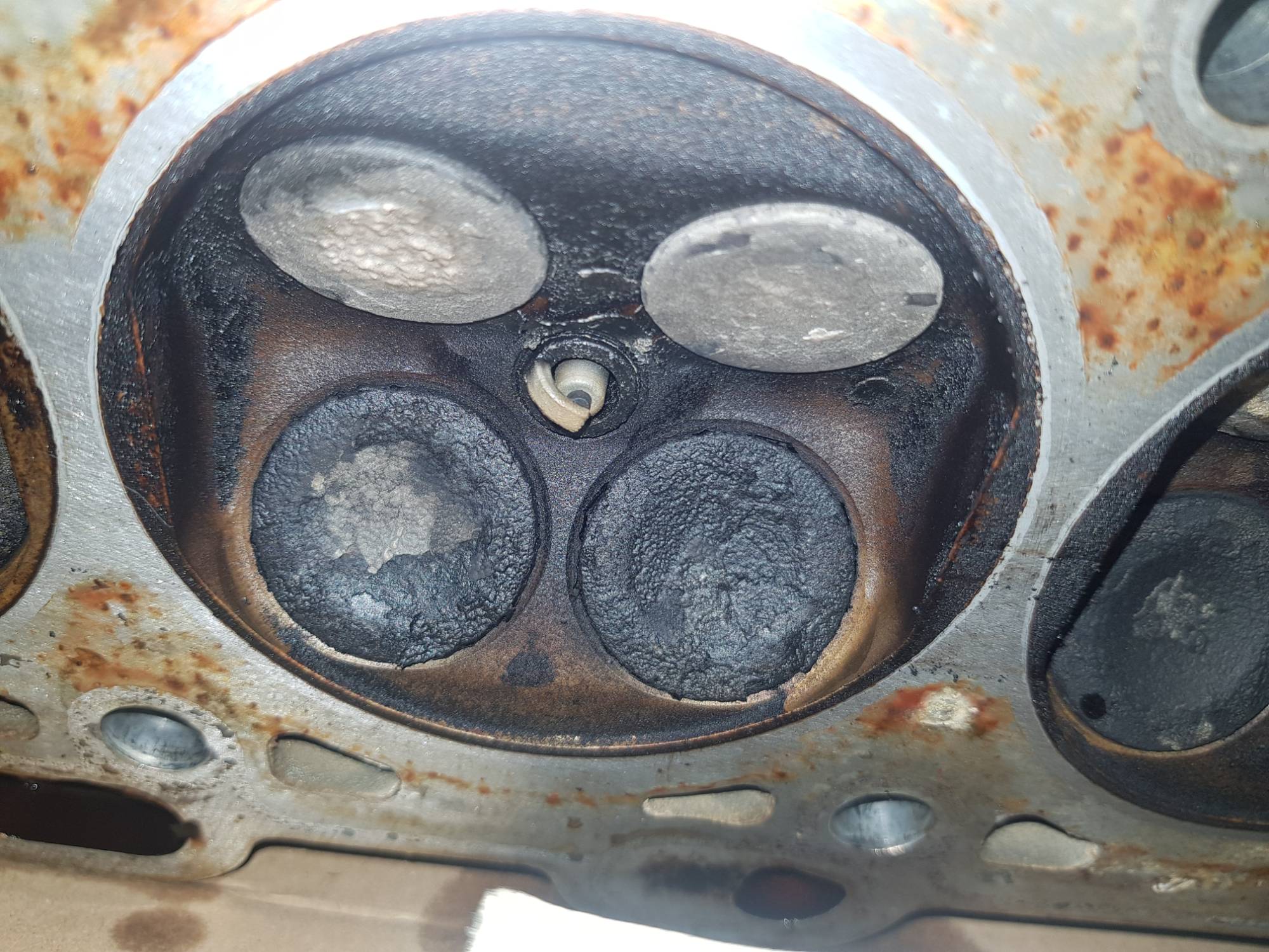

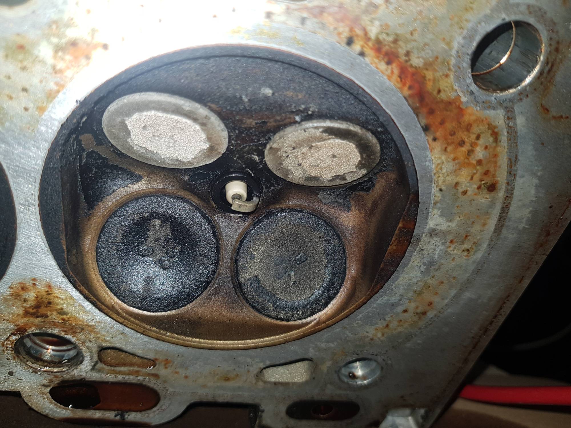

So while working on my cylinder head, I noticed that while it was normal to have carbon buildup on the exhaust ports, all my valves are covered in a flaky layer of carbon, while the exhaust valves are covered in a white layer.
While I did have a bad headgasket, antifreeze shouldn't have entered the other combustion chambers which had 200 psi compression, so pretty much perfect condition.
This means the bi-fuel e.g CNG must have been dirty and caused all this crap, but the carbon buildup also says something else.

It could just be oil leaking past the valve stem seals. The inlet valves don't tend to get as hot so it may mean it carbonizes rather than burns off. Exhaust valves are hotter so it may burn off more. Spark plug I can see looks normal.
We don't have CNG over here in regular cars so I don't know what is normal.

This is leaky valve stem seals.

Volvo branded only on the valve stem seals. Buy them in the bulk pack, not individually.

Degrease the valve steams thoroughly. They should be super dry, or the new seals will pop off. Don't glue them, like some folks do - most of glues become soft once heated and act like a grease.
