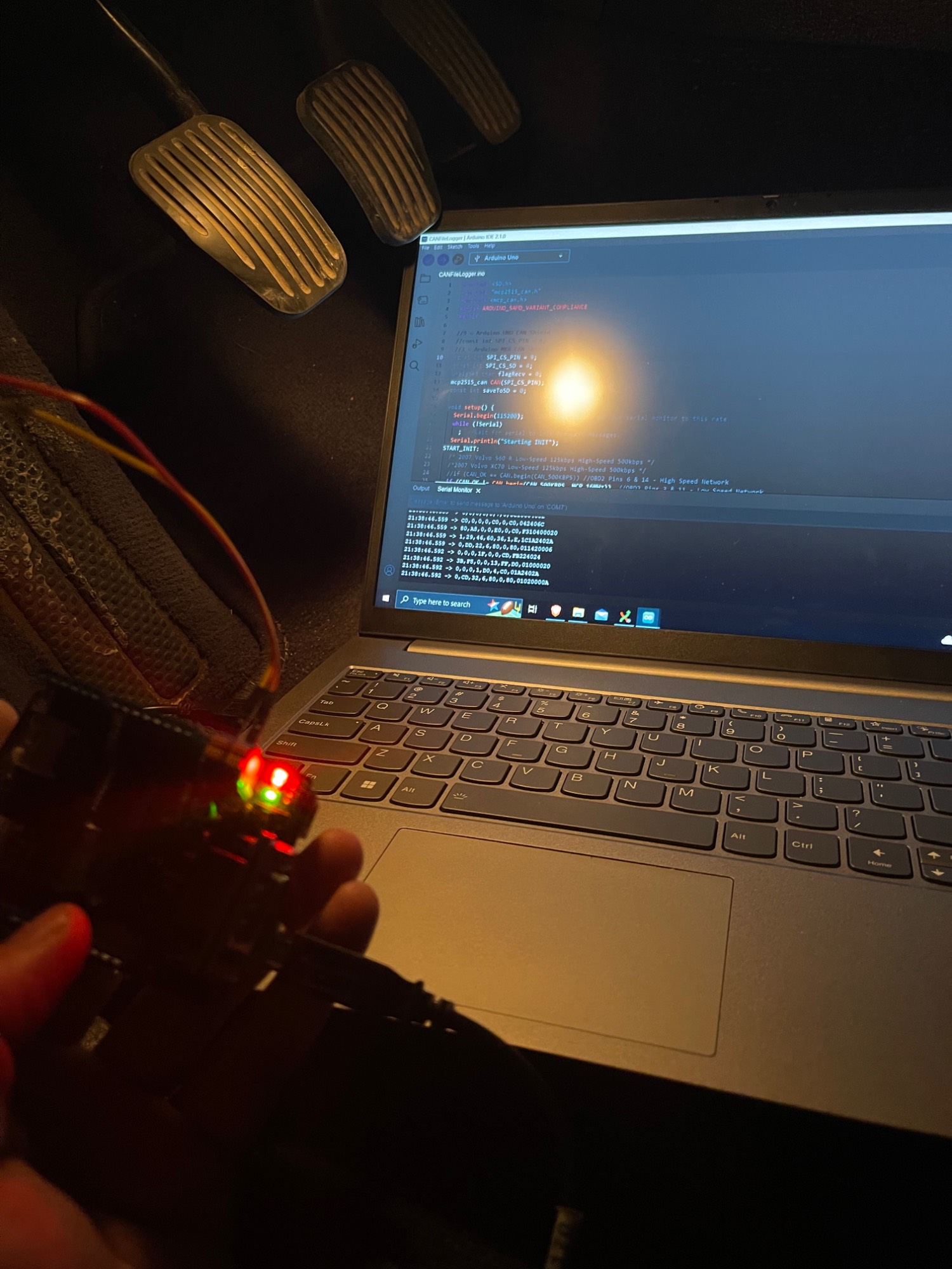

Works to log from my OBD2 port at both speeds just fine
Edit: I did just update this old repo with the file I have been using so this isn't the EXACT code I've been using to test with, but I will go make sure it still works with my car and isn't buggy

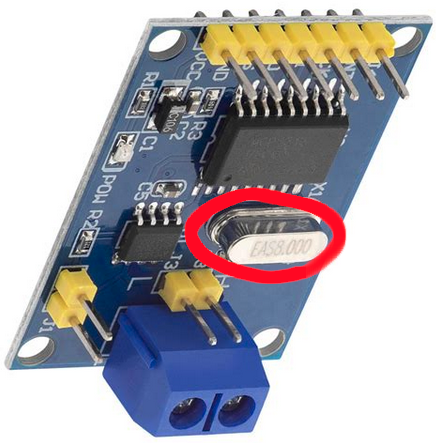

I'm honestly not sure... how important is that? I just tested the code I shared and was able to log my OBD2 port with it just fine.
Yes it does https://store-usa.arduino.cc/products/a ... edStore=us

This one is 8 MHz.andrewgabler wrote: 27 Apr 2023, 20:47 I'm honestly not sure... how important is that? I just tested the code I shared and was able to log my OBD2 port with it just fine.
You still can use it, at least for 125Kbps bus, but initialize it properly, with MCP_8MHz. For 500 Kbps IIRC 16 MHz is needed.

Just edited my post above with the link, yes my CAN Shield for the MKR has the 16mhz oscillator as does my arduino uno can shield
